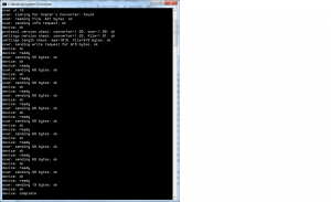

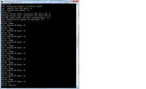

I tried the usual scwr.exe to write my .scb file over, and it returned these messages. IE no complaints. (Note that I have two Arduinos, and I flashed one with Soarer 1.10 and the other with the 1.20beta, so the messages are slightly different.)
101020-0101022-1
But HID.exe returns absolutely nothing. No ff codes.
