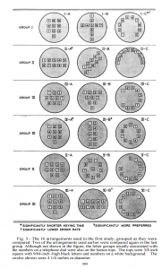

I think I've seen this mentioned on Geekhack, but back in July 1960, an article was published in The Bell System Technical Journal titled
"Human Factors Engineering Studies of the Design and Use of Pushbutton Telephone Sets, By R. L. DEININGER."
This article (available here: http://www.beatriceco.com/bti/porticus/bell/pdf/touchtone_hf.pdf ) gives a pretty in-depth description of the experiments done that resulted in the familiar 3x3 + 1 number format used in touch tone phones (and later, smartphones).
Several interesting facts emerge. First, they tested a lot of formats:
101434-0
Second, the calculator number pad layout
101436-1
 is measurably inferior to the touchtone layout
101437-2
though the difference was small.

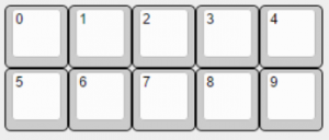

Third, and most interesting to me, *the 3x3 plus 1 touchtone layout was NOT the layout most preferred.* Out of the five top designs, two horizontal rows of five keys
101438-3
had the most preferred votes (the touchtone layout was third), and forth in "least preferred" votes (the touchtone format had the second highest "least preferred" votes). Interestingly enough, while two horizontal rows was the most preferred, two vertical rows were the least preferred.

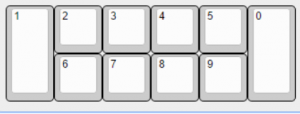

I do wish they had tested formats with 0 next to 1, such as
101439-4
 because having the most common numbers on the numeric keypad "home row" might be advantageous for data entry, especially with Enter or Shift/Function under the thumb instead of an enlarged 0 key.
Other possibilities I think would be better test subjects than "The Cross," "The Stairstep," or "The Rainbow" would be things like:
101441-5
and
101442-6

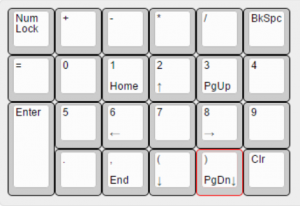

Finally, I'd love to see some testing done on a full-size numeric keypad
101444-7
Preferably with all of the functions of a Goldtouch GTC-0077

Was a bit disappointed they didn't test a two row layout that starts at the bottom(*). Still nice to have confirmation, that two row layouts are more comfortable to people than regular numpads, at least in pure number input without */+-.
Code: [Select]
67890
12345
I don't think its inferiority may be inferred from the numpad/touchtone comparison. You have to move down to reach 123 on the numpad layout, whereas here 12345 would be on the resting position/~homerow.
