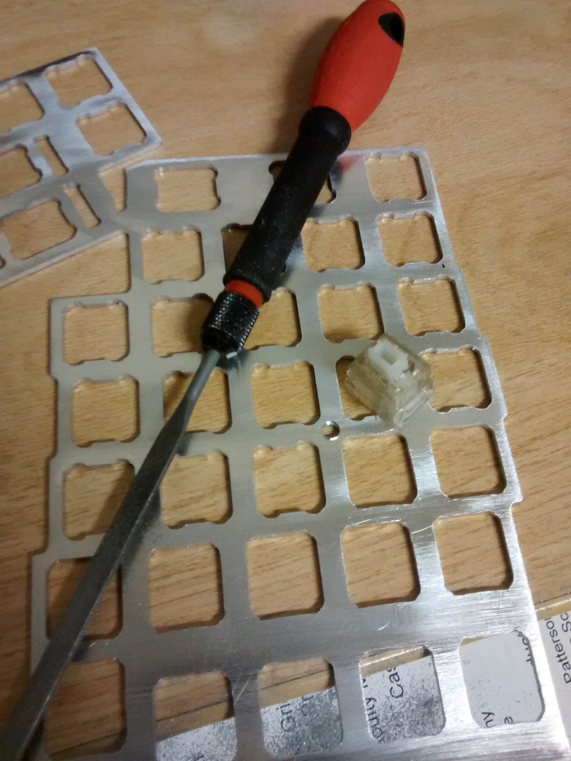

Fast forward a month or two, and I had all the components, and so I had to try and figure out how to make these switches fit in the plate cutouts. I thought about machining the plate, but that seemed like it was going to be too involved and complicated, so I decided to hand file each individual cutout to make them fit.
Filing:
102986-0
It took a while, but every switch fits nice and snugly.

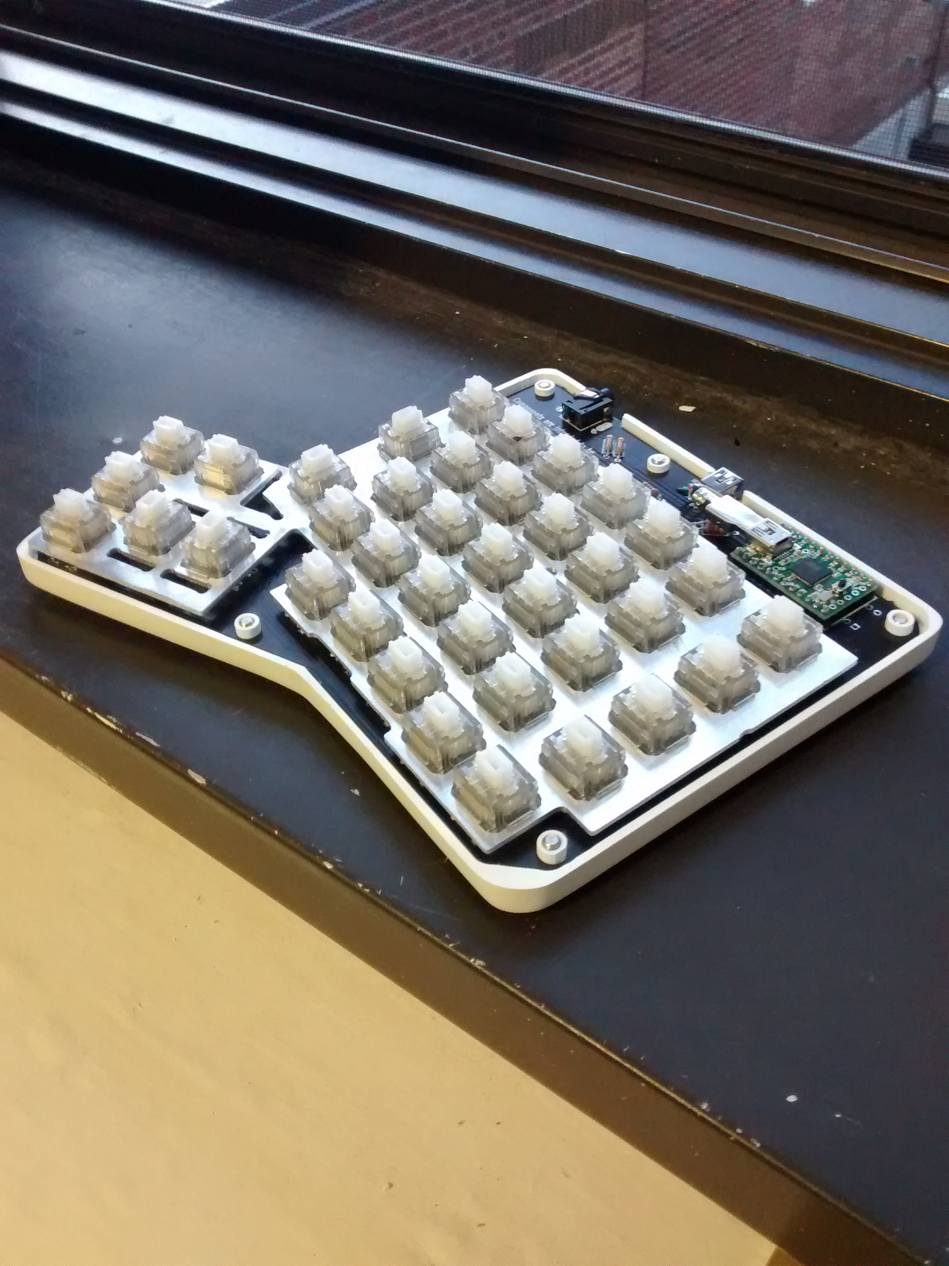

Naked:
102992-1
Some of the pins had to be bent a bit to fit the PCB, but all in all I couldn't believe how well it all went together.

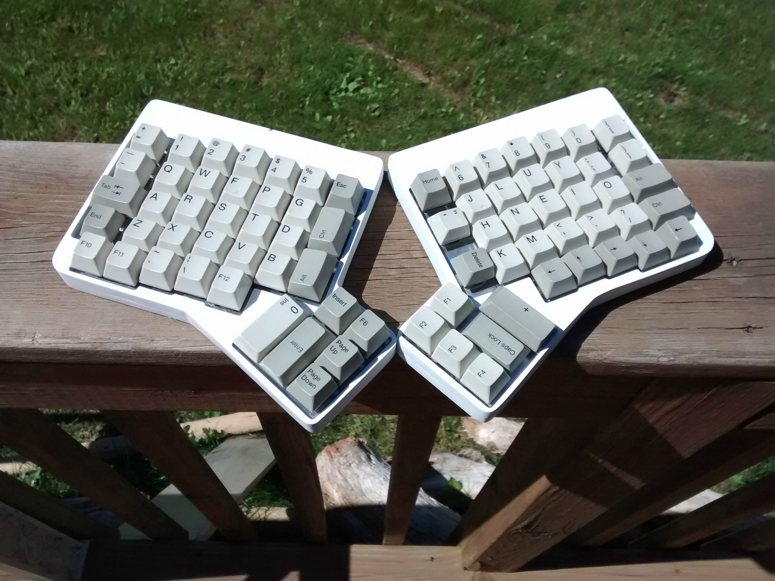

End Product:
102988-2
102990-3
https://imgur.com/a/oZSbo - gallery with a few more pics
All in all a great first experience with building a keyboard, and I've got my first real custom in the works because of it.

I want to take on this project but was wondering, what parts of the plate cutouts, exactly, did you file away? Was it just an all-around diameter increase, or only in one direction?

« Reply #5 on: Wed, 15 July 2015, 14:56:54 »
Your MatiaDox come out real nice. I've never seen the FalbaTech plate before. Is the thumb section barely connected so that it can be bent to a different plane?
It was only the cutout tab that you have to file more or less flush. the vertical dimension is actually a little bigger than the alps switches, so they dont really contact the top and bottom of the cutout. I did make sure to be really careful, and not file anything down too much, so all the switches fit in nice and snugly.
