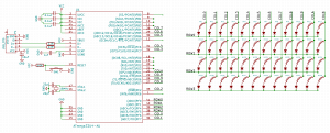

Here my my first draft of the keymatrix on pcb, Im using KiCad which is a free program to design schematics and pcb in.
103844-2
And heres my current schematic:
103846-3
A huge thanks to flabbergast for helping me.
