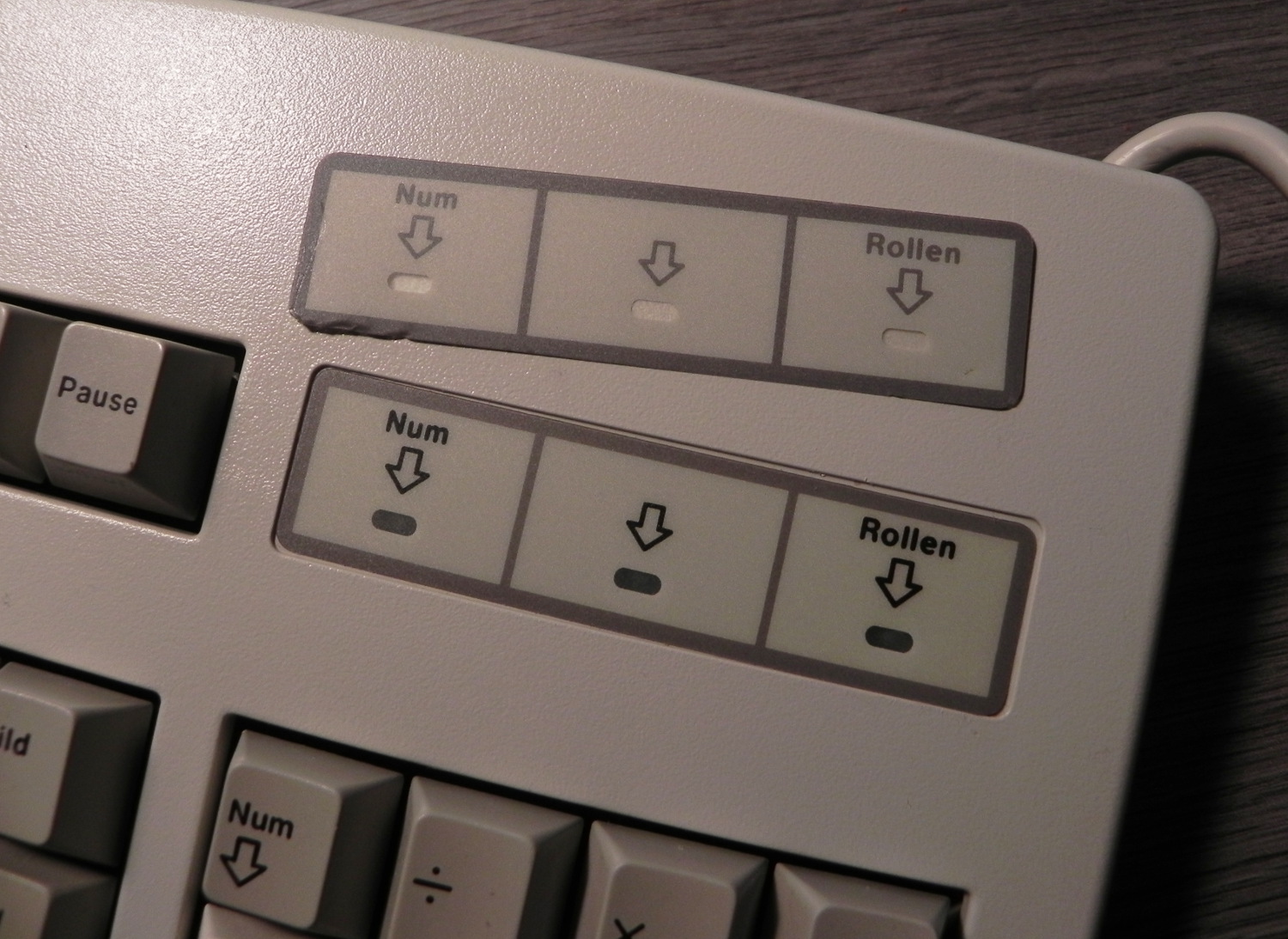

GMK Triumph Adler is around the corner. The original keyset came with the keyboard of the TA Dario computer system. For the keyboard, the Cherry G8*-3000 case was used. The case had a blue LED overlay matching the blue keycaps, which due to a manufacturing defect turned more to a teal over time.
intelli78's GMK Replica set aims to make the super rare, but wonderfully looking teal-colored keys more accessible and affordable with the successful group buy.
I'm a fan of the keyset and I think it looks great on a keyboard with a G8*-3000 case. I've also seen other community members looking for 3000 cases specifically for the TA set. The problem is, there's no 3000 case with a teal LED overlay matching the Replica set in a similar way as the original had a blue overlay for the blue keycaps.
106507-0
Original case on the left; normal 3000 case on the right

I want to recreate the LED overlay in GMK Triumph Adler-colors for the perfect match. This means drawing and producing them.
What I've done so far:
I've redrawn the overlays as a vector graphic using Inkscape based on the the Samples I have and high resolution photographs.
