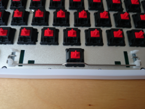

the board is built extremely well, i will post pictures later. it came with costar stabs, but they were in the inner positions, so the spacebar inserts were in the non-standard position and the spacebar wire is shorter. i have switched them into the outer positions and changed the wire from a QFR stealth and put on imsto thick pbt caps. (again, pics will follow later) it has a very nice silver coated plate and even though it has some scratches/smudges, they're not visible during normal use, it doesn't bother me.

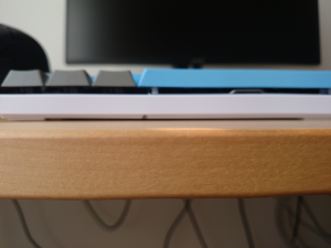

my only gripe is that it wobbles just a tiny bit. the bottom left corner is a bit in the air and i cannot identify whether the whole case is bent (because it's just a really tiny bit), or the rubber foot in the bottom left corner is a bit shorter. right now as i am typing though (and bagning it hard, bottoming out and all), i cannot feel it wobbling, i have to deliberately push the casing in the bottom left corner to actually feel it wobble, so i guess it's ok :)

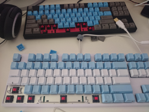

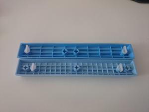

spacebar comparison - top imsto thick PBT, bottom varmilo PBT stock, as you can see, it has standard stem spacing, but original inserts are in the non standard (leopold, i guess) positions
107729-0
original PBT caps and what it looked like after replacing the costar stab wire with the one from QFR stealth
107731-1

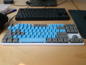

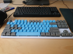

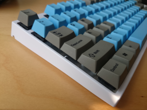

full imsto cherry profile thick PBT set on, i think it's SHMEXY :)
107733-2
107735-3
107737-4
blurry, but you can see on the left how the foot floats about half a milimeter above the table (and no, my table is not bent :) )

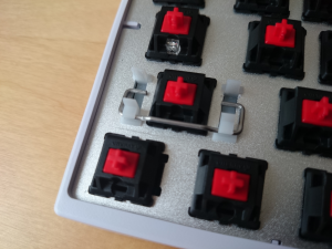

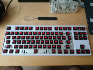

some barebones photos before the storm :), also you can see that the plate is pretty nice, even though it has some scuffs/scratches...
107741-6
107743-7
107745-8

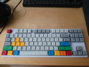

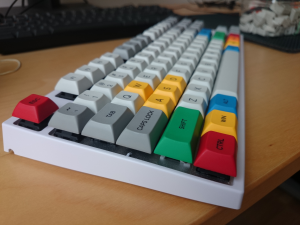

oh SNAP! looks like a unicorn vomited on my board LOL (lovely matt3o's PBT granite DSA - one of the most beautiful sets i have seen)
107747-9
107749-10

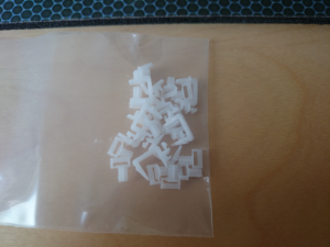

also, worth mentioning that it came with some extra stabilizer mounts and inserts, which is always nice
107751-11
now i just need to order some extra stabilizer wires :)

Nice review, I really wan't to try one of these boards out. I have fixed a similar wobble just by twisting the whole board in the opposite direction of the wobble.

tried it, didn't budge. this is built like a tank.

I would try some coarse sandpaper on the bumpons. Just whittle them down until they're all even.
