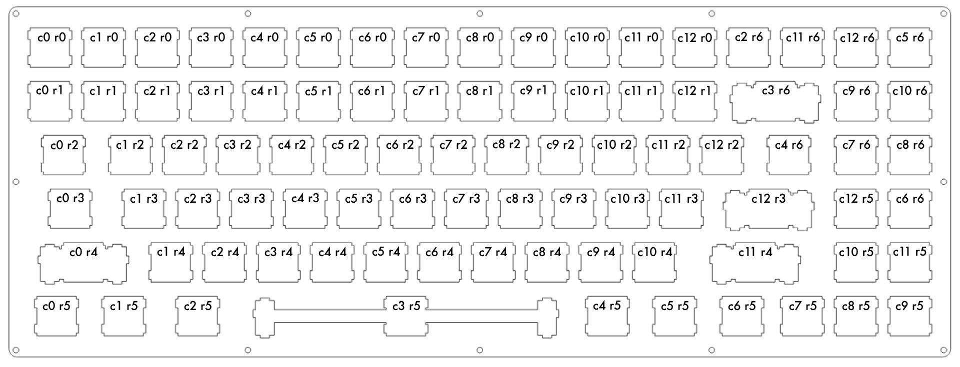

So, here's my progress so far.
First, I've made up a nice layout worksheet that has all the electrical rows and columns identified not he physical layout. It's top down view, so it'll be useful for defining my key layout too.
143187-0
So, I did start with the TMK firmware. If it can do everything I need it to do, then I'll stick with it, but there's always the option of re-flashing it with something else in the future if I can't integrate the hot swappable port expander functionality into the code. The code for my Column and Row pin definitions are below:

I have a VERY dense matrix of 13x7. It was necessary to keep enough I/O pins open for the Caps Lock LED, Backlight LED PWM, a pair of I2C pins, and the numpad sense pin. The sense pin detects if the number pad is attached, and whether or not it should poll the numpad's port expander over I2C. I figure, software is changeable, so I can re-do code later, once I actually have the number pad built, and have half a clue what the heck I'm actually doing.
Anyway, since I had to keep the matrix small, That super dense layout has almost no gaps, and row 6 is actually a tight cluster of keys in the top right corner. An alteration part way in resulted in the very top right key having a completely nonsensical matrix position, because the change was literally a bodge. Only three intersections in the entire matrix go unused (c0-r6, c1-r6, and c12-r4). This means my matrix does not directly conform to the physical key layout in some areas (all of Row 6 is in the top right corner, and the bottom row is "electrically" compressed to the left, and then includes the keys physically in the bottom right corner well).
Now, I'm stumped at my current place in the code...
What have not figured out yet, is whether the matrix definitions need to be ordered by electrical sequence, or if the values are arbitrary, and allow for physical sequence (as long as the row and column values are correctly defined). The obviously functional way is to lay the matrix out electrically. This seems to be what's assumed with most keyboards, as most keyboards physical layout and electrical layout probably match.
My question then is which (either, or both, or neither, or 42   ;D ) would be correct?

Code: [Select]
    C0  C1  C2  C3  C4  C5  C6  C7  C8  C9 C10 C11 C12 C13 C14 C15 C16 C17 C18
R0  X   X   X   X   X   X   X   X   X   X   X   X   X
R1  X   X   X   X   X   X   X   X   X   X   X   X   X
R2  X   X   X   X   X   X   X   X   X   X   X   X   X
R3  X   X   X   X   X   X   X   X   X   X   X   X   X
R4  X   X   X   X   X   X   X   X   X   X   X   X   X
R5  X   X   X   X   X   X   X   X   X   X   X   X   X
R6  X   X   X   X   X   X   X   X   X   X   X   X   X
R7                                                      X   X   X   X   X   X
R8                                                      X   X   X   X   X   X
R9                                                      X   X   X   X   X   X
R10                                                     X   X   X   X   X   X
R11                                                     X   X   X   X   X   X
R12                                                     X   X   X   X   X   X
C0-12 and R0-R6 would always scan, looking for whether keys are pressed on the main keyboard.
When the matrix scan reaches R7-R12 and C13-C18, then it would check for the state of the "sense" input to determine if the number pad is present or not. If not present, it would bypass I2C communication and fill in all 36 matrix values with a null value (or whatever represents a button not being pressed). If the "sense" signal detects the presence of the number pad, then I2C commands would be sent to the port expander in the number pad to perform the remainder of the matrix scan.
