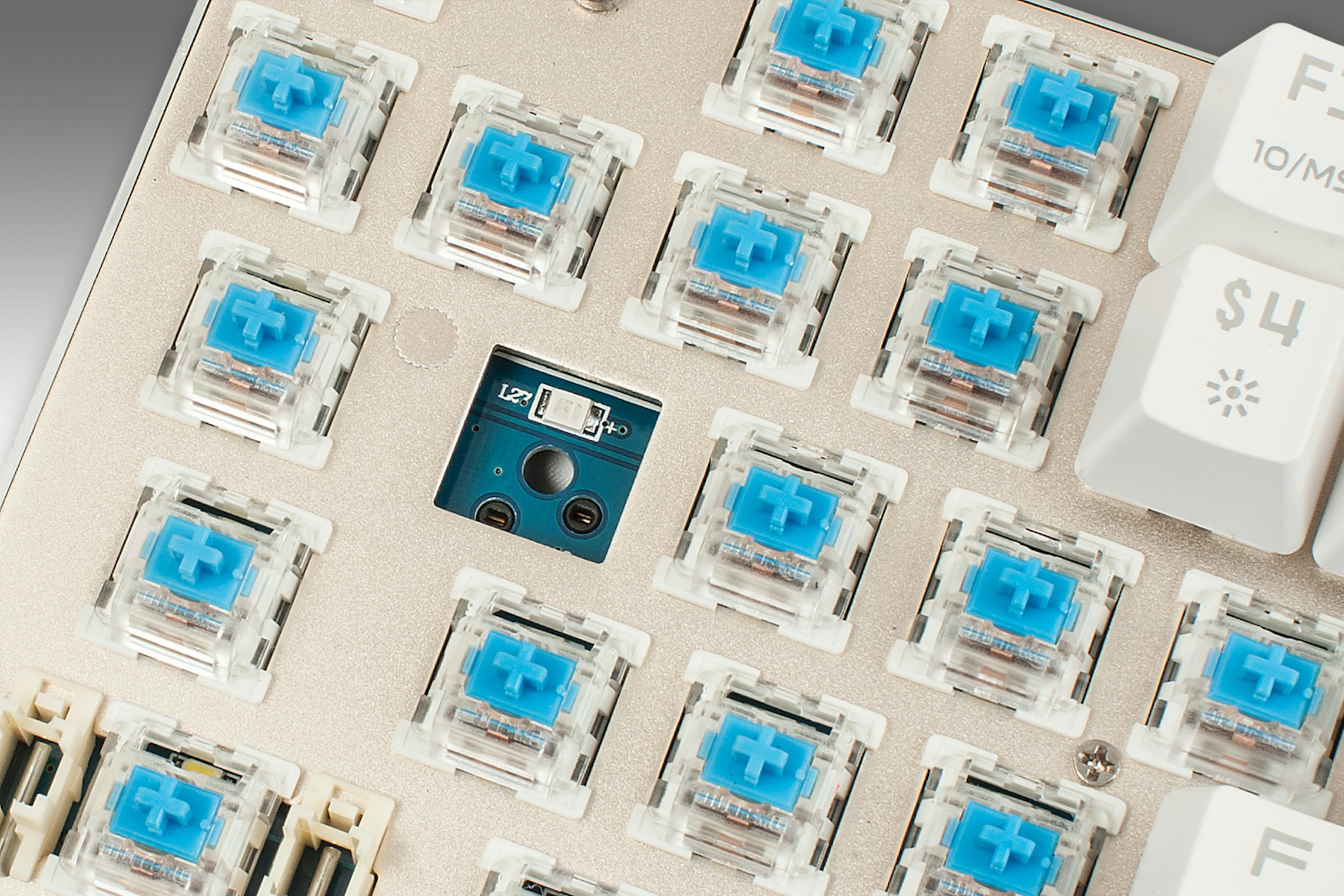

The biggest drawback is that it requires switches with recesses for the SMD LEDs on the PCB. I don't know of any easy way to get those, so you are basically stuck with the switches that you buy with the board, which defeats the purpose of hot swappable switches.

What I find really strange is that massdrop says its RGB, but the tenkeyless board listed on taobao, bangood, and on that review a redditor did does not seem to be.
If you look the pics massdrop posted, you can see its not a RGB led, as it only has two contacts. I wonder if the delivered product will be true RGB.
It uses an RGB SMD LED that sits under the switch, not the 4-pin in-switch LED.
Which is also why it requires special switches that have room for those LEDs underneath.

Yes, but even the SMD RGB led has 4 different contacts, like this (from their fullsize board):
Btw, this morning YanboWu from massdrop staff confirmed that the tenkeyless board is NOT rgb. The fullsize one is tho.
From here: https://www.massdrop.com/buy/team-wolf-swappable-switch-mechanical-keyboard/talk
Hey we checked in with the vendor to verify the specs on this keyboard.
We were told that while the full size keyboard is RGB. The TKL is actually the same LED setup people are seeing elsewhere. However that LED is also SMD and not the usual bulb we see in most keyboards.
Thank you for catching that. I will direct our support team to contact those that bought in the TKL option to let them know this updated information.

Now, I'm pretty new to the game and haven't taken apart enogh switches to answer this myself, but: how hard would it be to simply dremel out a cavity on your switches for the SMD LEDs?  Would most switches have enough material there to do this?

Has anyone tried opening Outemu switches? Also, I can desolder SMD LEDs and it would still work, right?
