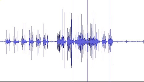

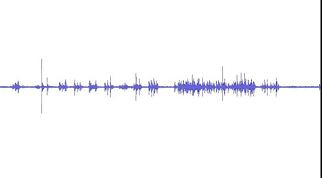

I've been tweaking my method for silencing Topre-switch keyboards, using a combination of Silencing Rings and lubing of stabilizers and switches. This most recent "ring job and lube" produced the best silencing yet.
Previously, I had lubricated only the stabilizers. My earlier method was to use relatively thick grease,such as MechLube2 from EK. However, all of the greases I had tried seemed to dry up after a time.
My current method is to install Silencing Rings in all the switches and then to lubricate the stabilizers and switches using SuperLube 51010 Oil. The oil is applied with a small paintbrush on friction points such as articulations of stabilzer wires and the slider rails of switches. I've reproduced an image showing a similar procedure on the switch slider rails of a HHKB Pro 2 keyboard:
https://i.imgur.com/DQyf2Sa.jpg
I also put a two-layer square of self-adhesive anti-skid strips on each side of the spacebar switch to serve as downstroke dampers for the spacebar.
This method produced the best silencing I have experienced to date, as demonstrated in the following video/audio clips and audio waveforms. Keystrokes were 3 each of Tab, Backslash (HHKB Delete/Backspace), CapsLock/Ctrl, Return/Enter, Left Shift, Right Shift, and Spacebar, followed by 3 each of "This is this." (without quotation marks), ending with 3 each of Return/Enter and Spacebar.
Before silencing:
After silencing:
I hope that these tips will help others who are interested in silencing their Topre-switch keyboards. The same principles should apply to any Topre-switch board, including RF87U/104U, HHKB Pro 2, Leopold FC660C, CM Novatouch, and others.
