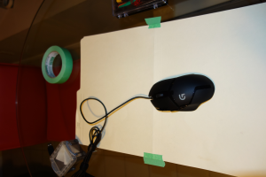

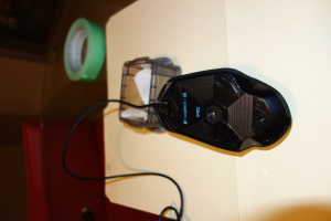

Start with the mouse.
123717-0

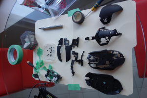

Use a small screwdriver to peel off the mouse’s skid pads. The adhesive on the G402’s pads was particularly strong, some of the pads started to split in the middle with the skid surface coming off and the adhesive remaining on the mouse. Do not let that happen, make sure you’re pulling off the adhesive. Once the pads are off, stick them onto a piece of parchment paper or something similar so you can re-use them. Replacement pads can be purchased of you destroy them in the removal process, but this should not be necessary if you are careful.
123719-1123721-2

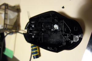

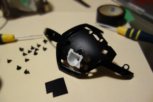

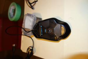

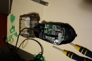

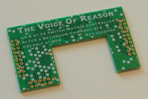

Break the mouse in half. There are vertical and horizontal PCBs attached to the bottom of the mouse. Remove the 2 screws securing the vertical PCB, then the 3 screws and retention clip securing the horizontal PCB (one of the horizontal PCBs screws is hidden under the vertical PCB). Both PCBs should separate from the mouse, along with the USB cable.
123723-3

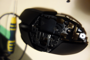

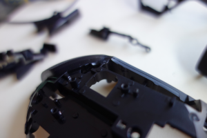

The top half of the mouse houses all of the buttons, which are held in place by an army of screws. Take out all of the screws you can see and start wiggling components apart. I did not remove the mouse wheel.
123725-4123727-5123729-6123731-7

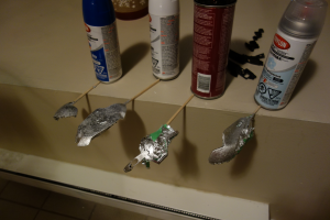

Applying Aluminum Leaf

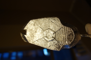

Spray the surface with 3M Super 77 adhesive and wait 5 minutes for the adhesive to develop tack. There is also a produce called “size” that is a brush on adhesive for gold and silver leaf. I did not have any size, so I just used general purpose adhesive spray. Once the surface is tacky, apply aluminum leaf. Pat the leaf onto the surface with a paint brush. Do not use a cheap brush to do this! Cheap brushes tend to lose bristles, and loose bristles become embedded in the adhesive and will ruin the appearance of the leaf-coated surface.
123735-9123737-10123739-11
You can change the appearance of the leaf by crinkling it during application or applying it as a smooth sheet. Using a stiff brush or a soft brush to flatten the leaf also affects appearance. The two components here had their leaf applied in different ways to generate smoother and rougher surfaces. (I started applying leaf with a cheap dollar-store brush and it lost some bristles on my mouse. You can see one at the lowest curve in the below image. I had to pick all of the bristles out and re-apply leaf to those regions. Avoid this problem altogether with a quality brush.)

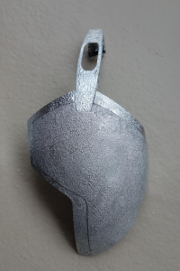

123741-12
Once the leaf is applied and the adhesive has cured, apply a whole lot of coats of clear gloss to protect it. Leaf is very fragile; I did about 10 coats of clear on top of the leafed components of this mouse.

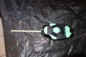

Painting Components
Paint is much simpler to apply than aluminum leaf. Just tape off the regions that will not be visible and hit the component with multiple light coats of paint. Notice that the working parts of the mouse buttons are all well protected from paint.
123747-0123749-1123751-2
I tried to paint the mouse wheel by masking off the base of the mouse, leaving only the wheel exposed, and rotating the wheel between coats of paint. I did a white base coat and proceeded with several blue coats.

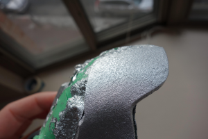

As I removed the masking tape around the base of the mouse, the leafing over the rubberized regions decided it liked the masking tape more than the mouse and ripped right off. Once again, dealing with rubberized surfaces poses huge problems. I had allowed the clear coats to cure for 24 hours before putting masking tape over them, so everything should have been fully set.
123757-5
I ran a finger nail along the leaf and ripped it easily. Leafing over rubber did not work at all.
