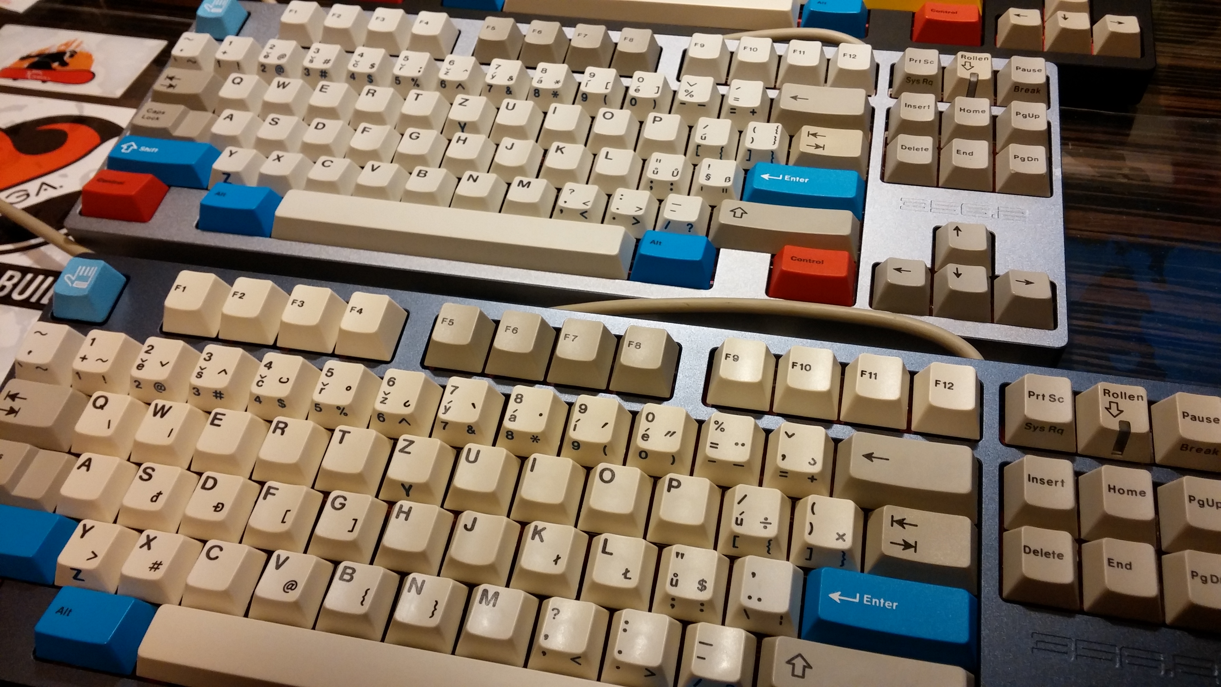

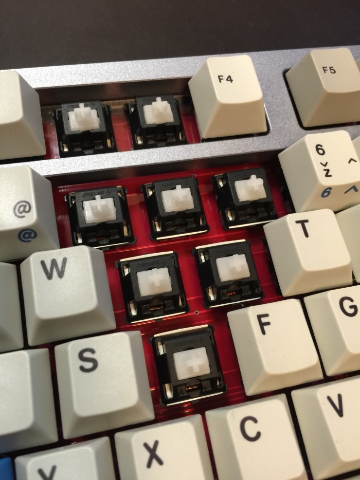

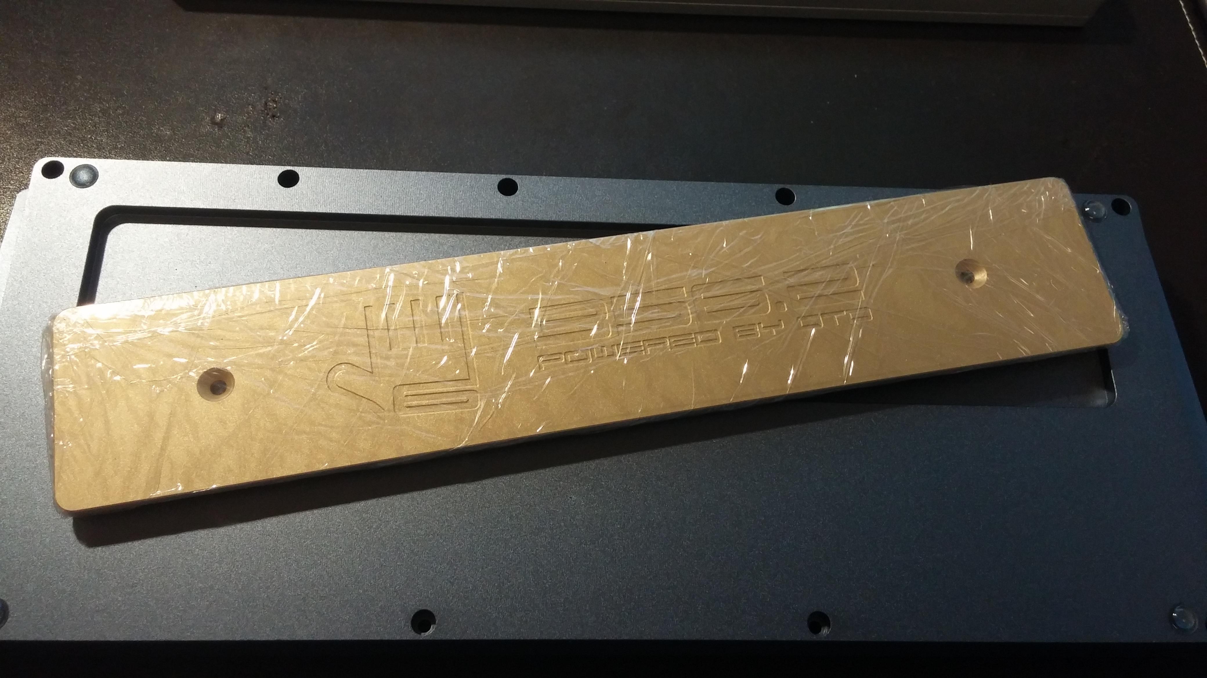

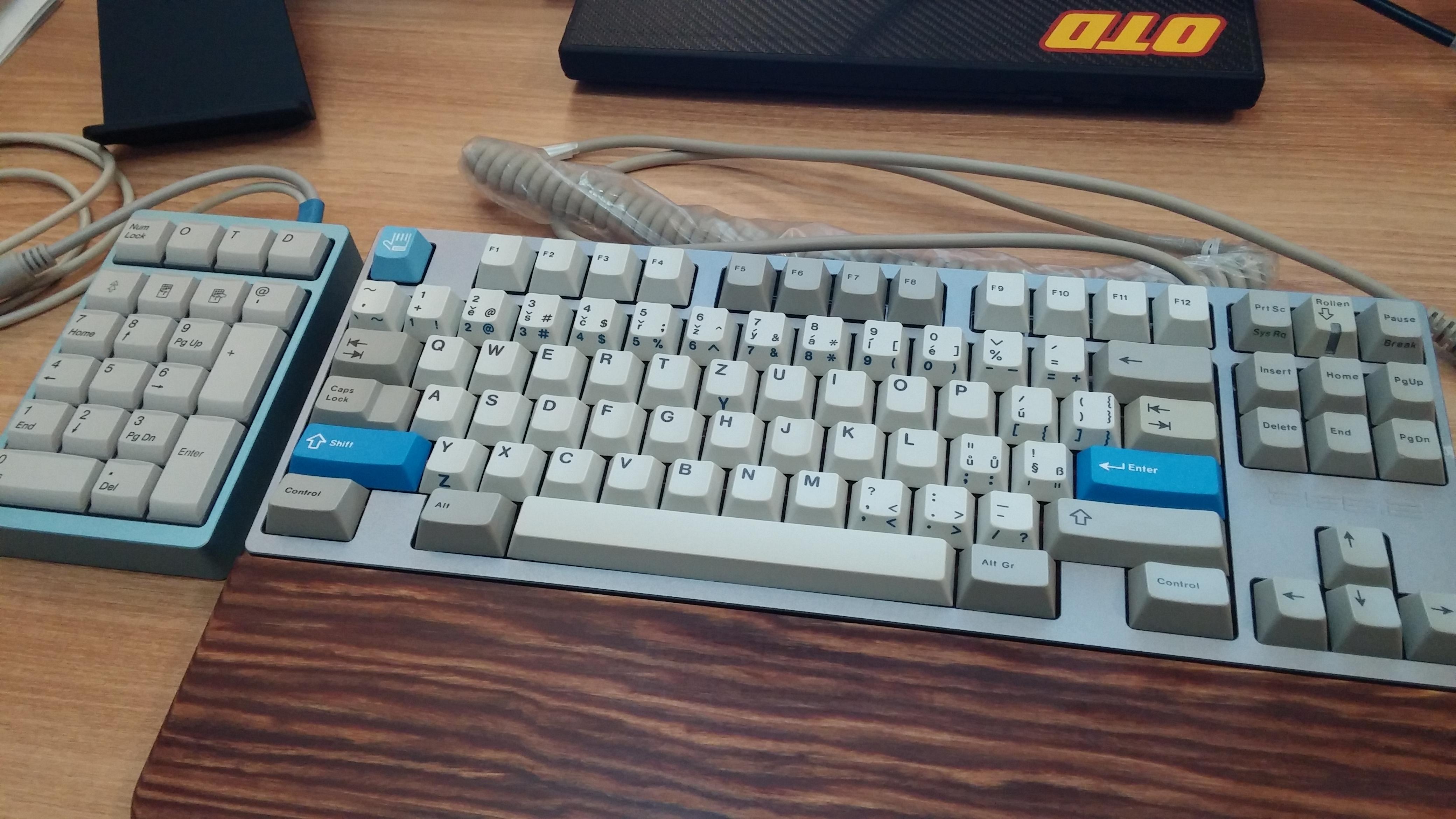

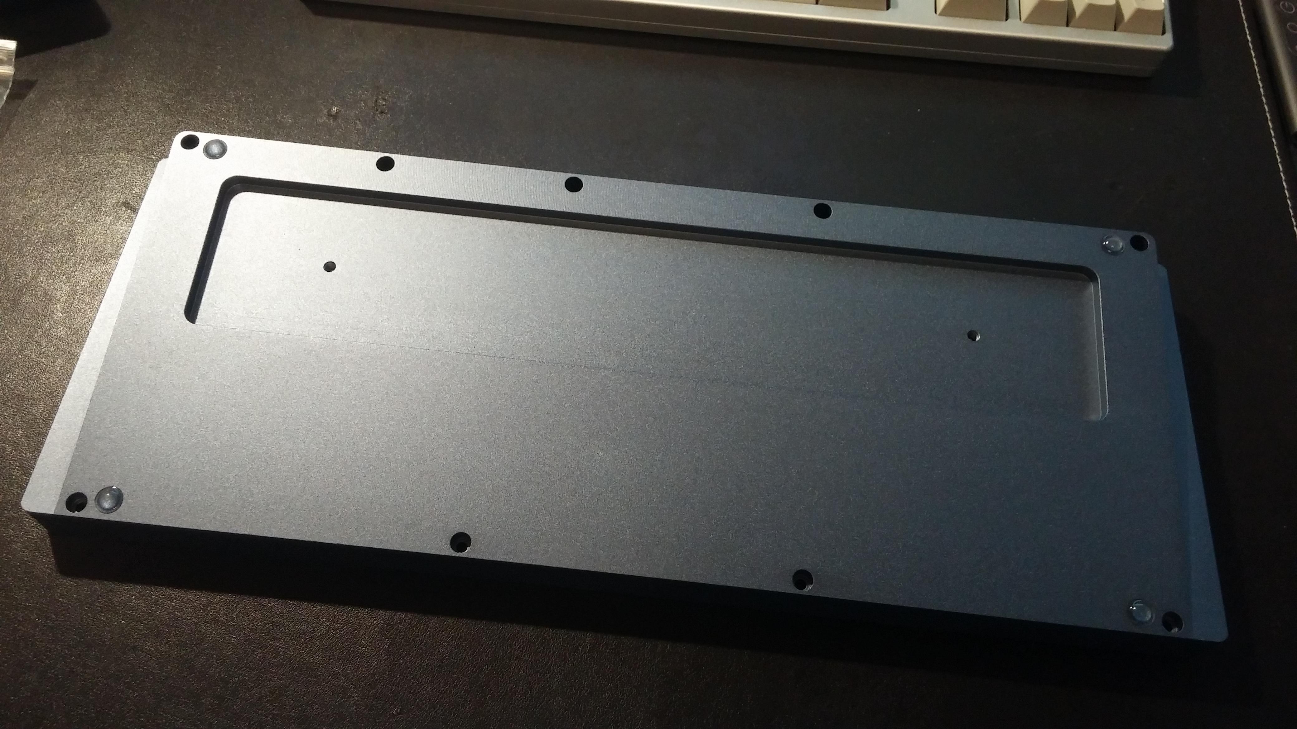

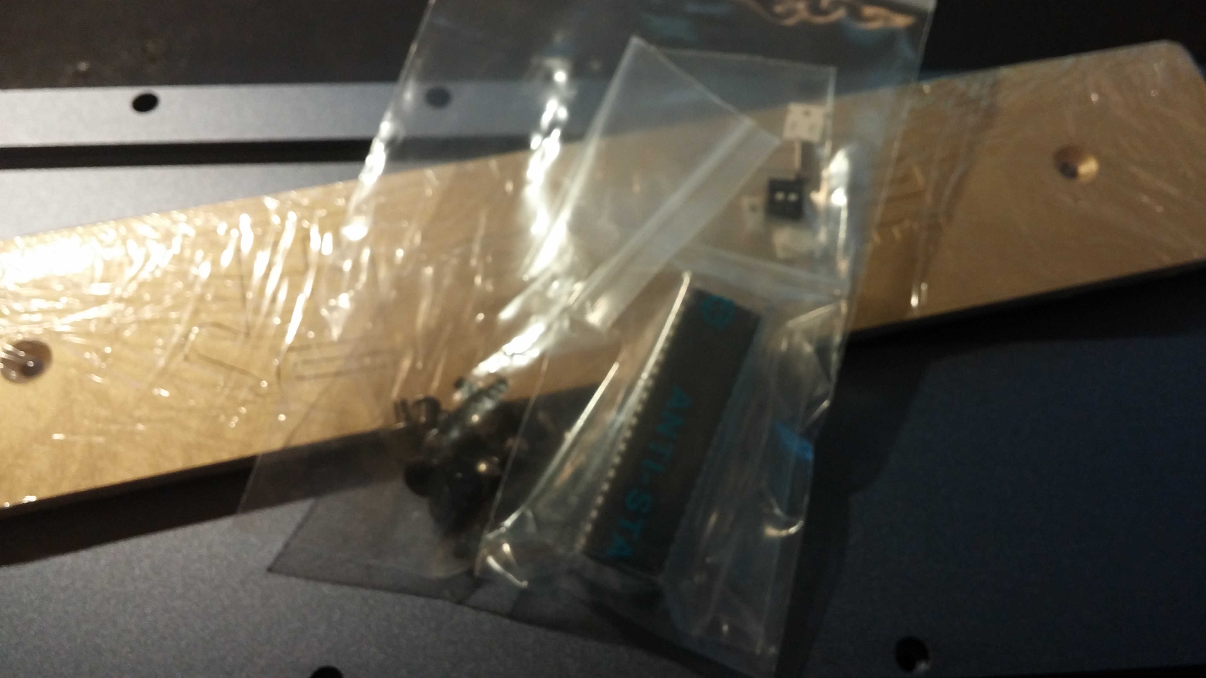

Apple silver and Hyper gray are used as housing colors as above photo.
The brass key has angle of inclination like as slope of the lower plate.
The brass key which has the inclination angle is mounted through the under plate.
This is assembled using the black switch which is the switch of mechanical keyboard of the Cherry Co.
360 Corsa is produces by the whole aluminum plate when it was coproduced.
But now it was used the partial plate board of poly carbonate material which was put into coproduction of 356.2 because it can be replaced to plate board of 356.2.
We recommend a combination with the pure black switch for partial plate because a board material of 360 Corsa is soft material unlike the existing custom keyboard.
If the spring is lubricated by the LSD oil or the Anti-shock which is called as the red medicine, you can hearing a distinctive sound like spring bounce.

360Corsa hyper-gray color is a custom keyboard which was coproduced by Sir, Eungsam with Apple-silver color in otd.kr.
If you remove the brass key on the lower housing as shown in the above picture,
unique echo of the click switch flows out so that you can hear the lighter click sound than keyboard the lower housing is covered.
The click switch can't slider lubrication or spring lubrication separately.
When you disassemble or assemble the switch,
click sound may be die compared to the switch before open it because unique character of the click switch can be changed in case of lubrication for slider or spring.
It didn't lubricate the stabilizer separately.
A harmony of whole plate which was coproduced,
click switch with green switch and housing with grapping hole make a desire to type continuously.

I'm actually really curious as to how it sounds without the brass weight, that's really interesting. :thumb:
360c with OG cherry set + green switches. Not much of a difference in sound, but in feel.
With brass:
https://soundcloud.com/user-703532478-771412076/brass24567
No brass:
https://soundcloud.com/user-703532478-771412076/no-brass2

The sound signatures look to be almost the exact same. I wish I could be able to feel the difference but that is near impossible now. :p

Gundam is my close friend, so I upload this post to support him.
All of OTD boards owner can upload your board! (Not only 356 but also Koala, the cheat, etc.)
This is a my favorite keyboard. I love combination of Polycarbonate partial plate, CEM-3 PCB and Cherry vintage black switch.
Sorry for rehashing similar pictures. ;)
Beautiful boards gundam and metal! My OTD keyboards aren't as nice as yours, but here they are :
