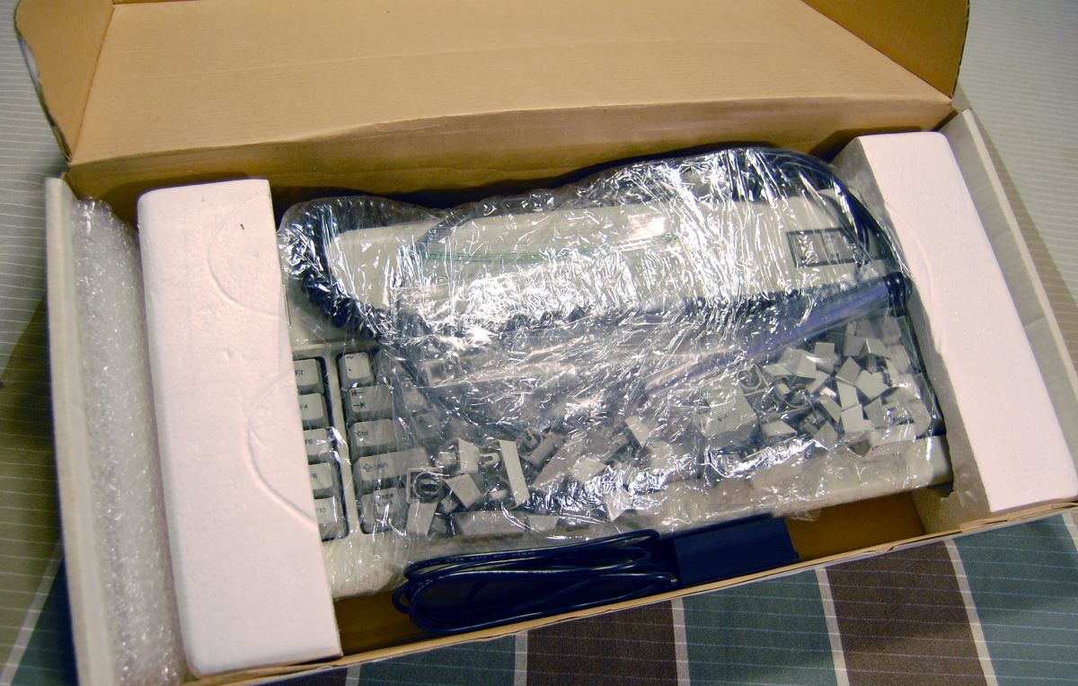

The board arrived in a cool vintage Key Tronics box ("The Responsive Input Company!"):
126885-0
Everything was securely, neatly packed:

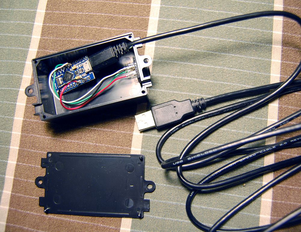

He also generously included a Soarer's adapter he'd made by adroitly wiring a Teensy into a socketed box:

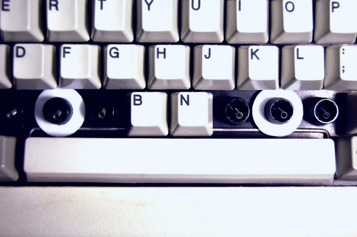

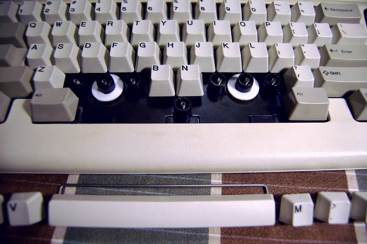

To accommodate the new bottom row, Dork swapped the F's wide spacebar with one from a Model M. The M's stabilizer wire is too thick for the F's retaining brackets, so he used wcass's clever "washer mod", fabricating the parts from Teflon:
126891-3
126893-4

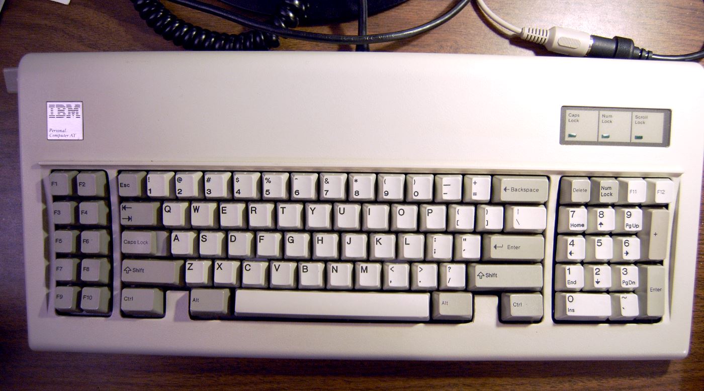

Besides the obvious changes, there's no standard way to update the AT layout; it's a matter of taste. For those of you not familiar with it, here's the original layout (courtesy of Wikipedia):
...and here's the one I settled on, after moving some keys around myself:

This is where the Soarer's comes in of course. As most of you know, the AT was the first IBM keyboard and the only Model F to use the standard PC protocol. So it doesn't need a Soarer's to be used with a PC. But it does add the ability to remap key codes so there'll actually be a point to moving those caps around.

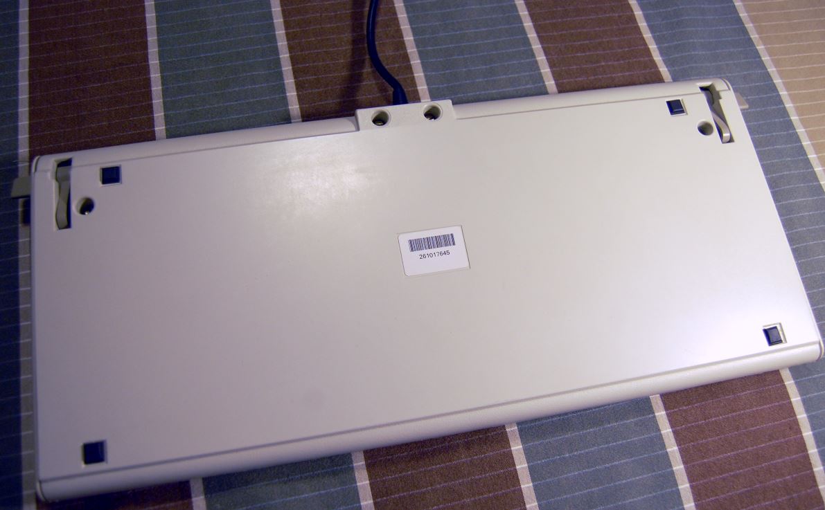

The back, with its simple s/n label:

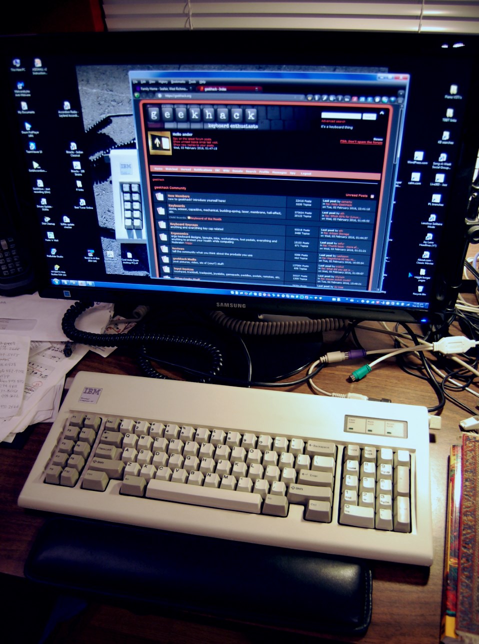

Finally, the ANSI AT in action (along with my $7 Chinese leather wrist rest):

Were there two unused capacitance censors under the spacebar all this time?  :eek:
If not, how did you install the new Alternate keys?
They are there.  The holes for the space bar barrel/stabilzer bracket are right over the top, so you have to open those up to accept the new barrels, and do the M style above plate stabilizer wire.
And the ISO/ANSI/BAE key barrels and pads are all there in the same locations.  Just a matter of moving springs and stabilizer inserts around.
Model M/Fs have several "secret" keys. PCBs, plates, etc were made to accommodate various layouts such as ANSI, ISO, etc, without re-tooling.
So... theoretically we can also install an AT spacebar into a Model M?
(I mean, who in the world would do that?  But can it be done?)
Nope, won't work.  The spring barrel and stabilizer piece for the AT spacebar are one piece and won't fit in the M.  The only way to physically get it there would be to cut the bottom plate, which would cause a TON of stress on the membrane and cause it to fail, if you could even get it to line up with all the locating pins.
I meant that there are options within each model, but not necessarily between models. IBM did considerable thinking on how to accommodate various layouts within lines, but a redesign as great as F AT to M is a complete overhaul.

I'm really happy about the teflon washers. They aren't too expensive and I was having a heck of a time with washer / clip options. For XT style barrels, you can drop metal washers over it and the stabilizer wire can sit between the barrel, the "tab" on the barrel and the washer, but on AT style barrels it doesnt work so easily. Plastic washers were also really unsatisfying. I'm glad I went with teflon, I just got some that would fit, and then reamed the inside edge out until it "almost" fit. Teflon is pretty tough (can absorb a lot of energy before failure) and stretches a little, so it easily stays put on the barrels and the stabilizer wire rides with lower friction!
  • Posts: 6564
Re: My ANSI-ified PC AT
« Reply #11 on: Sun, 07 February 2016, 21:13:46 »
Cool. Where do those come from? I have tried metal, rubber, and fiber washers and none of them were entirely satisfactory. The metal ones were the best, although rattly, the fiber ones required some Dremel work and never stayed in place properly, and the rubber ones were too thick and prevented the keys from going down to a comfortable level.

Not if you add Alt keys and a Model M space bar. There is some non-trivial Dremel work on the front plate and you will need to cut the "under-carriage" that mates with the original long space bar.

How does the modded spacebar feels in term of stability and sound, compared to the original one? I wonder if I shoud just keep the original one.
The wire of the original one can be modified by beding the spacebar wire, but it seems that it requires a lot of trial and error.

How does the modded spacebar feels in term of stability and sound, compared to the original one? I wonder if I shoud just keep the original one... The wire of the original one can be modified by [bending] the spacebar wire, but it seems that it requires a lot of trial and error.
The new one isn't as clackety. That's fine by me, as spacebars tend to be noisier than other keys anyway (due, no doubt, to their bigger, more widely mounted nature).
I'd keep the original spacebar. Model F's regularly turn up whose spacebars are missing, which makes them less salable. (BTW, perhaps like some of you, I think it should be saleable with two E's—but Mr. Webster had other ideas.) After all, who happens to have an extra Model F spacebar hanging around? Answer: You do. So ha—now you now own not one but two F's: one with the original configuration, and one you've artfully updated. Add regular supplies of coffee and chocolate, and IMHO that's a complete life, dude.
Thanks, for the moment I'll keep the original one and try to make it lighter by modifying the bent bar on the back.
