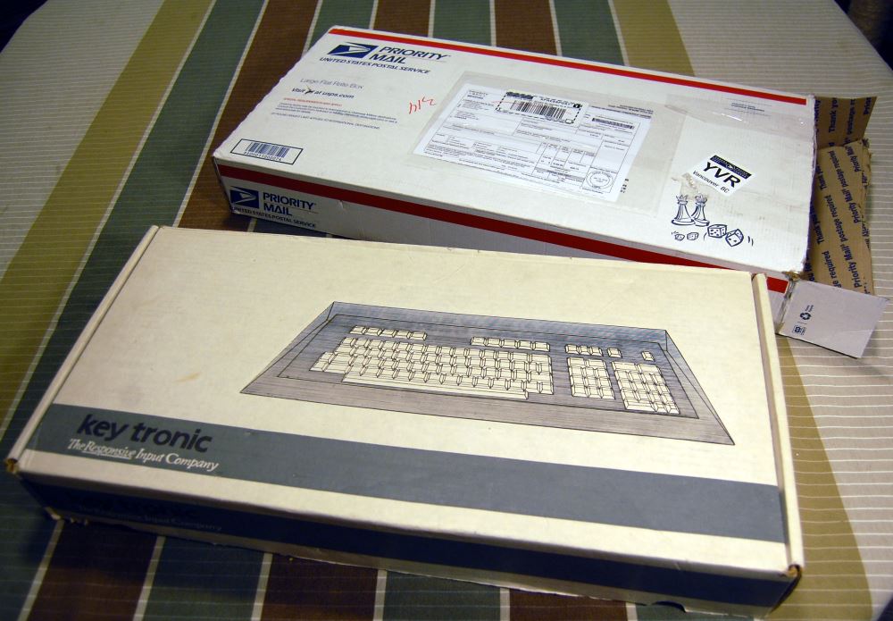

The board arrived in a cool vintage Key Tronics box ("The Responsive Input Company!"):
126885-0

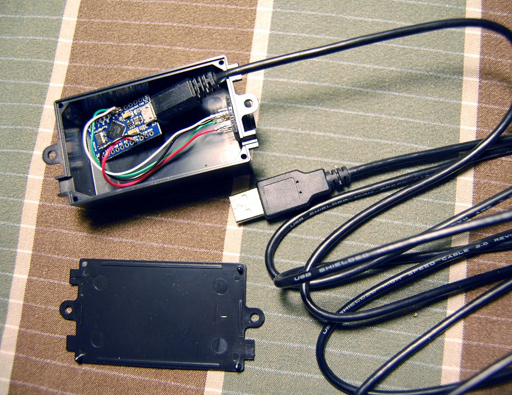

He also generously included a Soarer's adapter he'd made by adroitly wiring a Teensy into a socketed box:

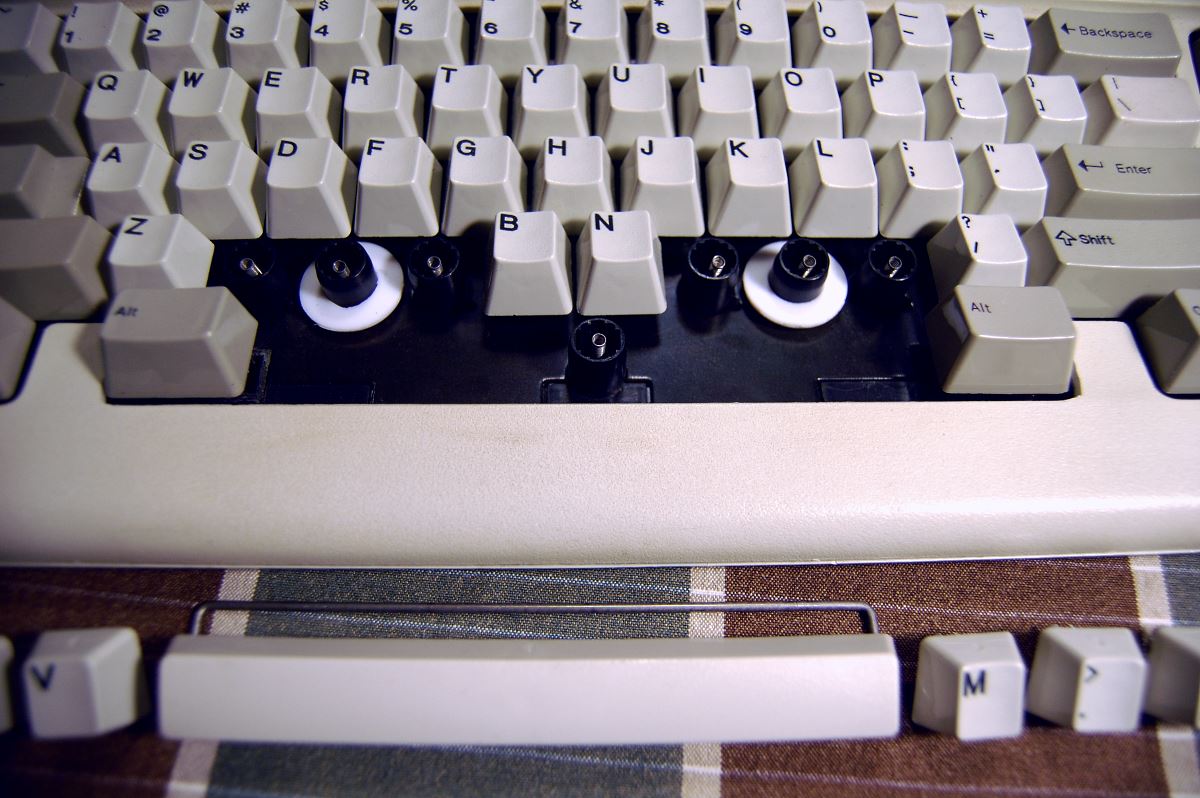

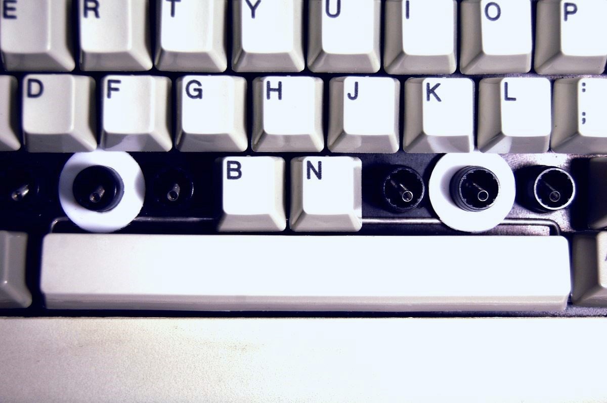

To accommodate the new bottom row, Dork swapped the F's wide spacebar with one from a Model M. The M's stabilizer wire is too thick for the F's retaining brackets, so he used wcass's clever "washer mod", fabricating the parts from Teflon:
126891-3

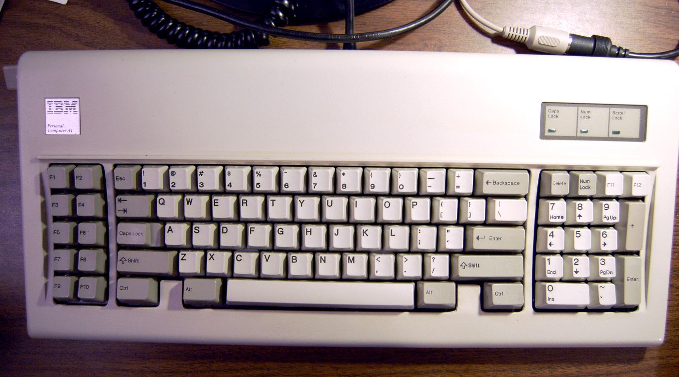

Besides the obvious changes, there's no standard way to update the AT layout; it's a matter of taste. For those of you not familiar with it, here's the original layout (courtesy of Wikipedia):
...and here's the one I settled on, after moving some keys around myself:
126895-5
Some people put Esc on the number pad, but I didn't think I could break my decades-long habit of reaching up and to the left. So Esc went where tilde ( ~) was—and since I'll use the number pad only for things like ASCII codes, not bookkeeping, tilde got the dot/Del key's spot.
I love the F's vintagey typography and gladly restored the original F numpad keys. I opted to replace the seldom (ever?) used Scroll Lock and Pause/Break with the post-AT F11-12 keys. (Hey, they have numbers in 'em, right?)
This is where the Soarer's comes in of course. As most of you know, the AT was the first IBM keyboard and the only Model F to use the standard PC protocol. So it doesn't need a Soarer's to be used with a PC. But it does add the ability to remap key codes so there'll actually be a point to moving those caps around.

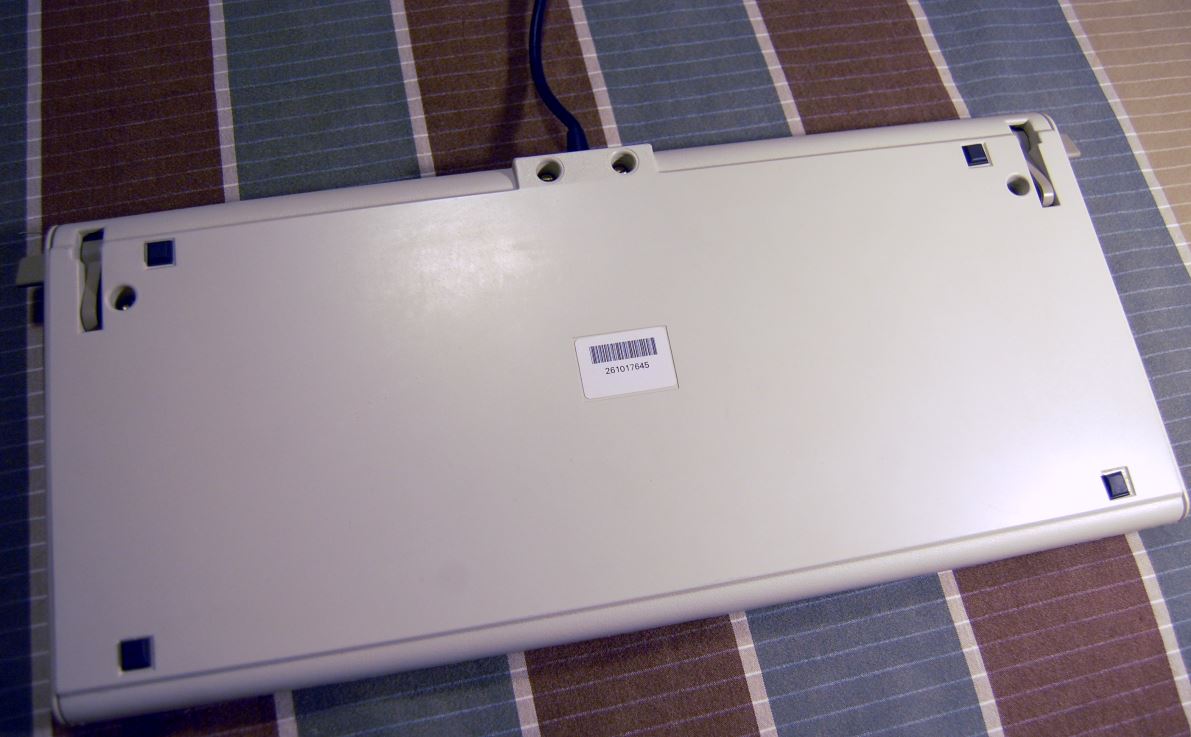

The back, with its simple s/n label:
126897-6

Were there two unused capacitance censors under the spacebar all this time?  :eek:
If not, how did you install the new Alternate keys?

Model M/Fs have several "secret" keys. PCBs, plates, etc were made to accommodate various layouts such as ANSI, ISO, etc, without re-tooling.
They are there.  The holes for the space bar barrel/stabilzer bracket are right over the top, so you have to open those up to accept the new barrels, and do the M style above plate stabilizer wire.
And the ISO/ANSI/BAE key barrels and pads are all there in the same locations.  Just a matter of moving springs and stabilizer inserts around.
So... theoretically we can also install an AT spacebar into a Model M?
(I mean, who in the world would do that?  But can it be done?)
Nope, won't work.  The spring barrel and stabilizer piece for the AT spacebar are one piece and won't fit in the M.  The only way to physically get it there would be to cut the bottom plate, which would cause a TON of stress on the membrane and cause it to fail, if you could even get it to line up with all the locating pins.
I meant that there are options within each model, but not necessarily between models. IBM did considerable thinking on how to accommodate various layouts within lines, but a redesign as great as F AT to M is a complete overhaul.
Those insane XT and AT space bars with ridiculous "under-carriage" assemblies are just too much!

Not if you add Alt keys and a Model M space bar. There is some non-trivial Dremel work on the front plate and you will need to cut the "under-carriage" that mates with the original long space bar.

How does the modded spacebar feels in term of stability and sound, compared to the original one? I wonder if I shoud just keep the original one.
The wire of the original one can be modified by beding the spacebar wire, but it seems that it requires a lot of trial and error.

How does the modded spacebar feels in term of stability and sound, compared to the original one? I wonder if I shoud just keep the original one... The wire of the original one can be modified by [bending] the spacebar wire, but it seems that it requires a lot of trial and error.
The new one isn't as clackety. That's fine by me, as spacebars tend to be noisier than other keys anyway (due, no doubt, to their bigger, more widely mounted nature).
I'd keep the original spacebar. Model F's regularly turn up whose spacebars are missing, which makes them less salable. (BTW, perhaps like some of you, I think it should be saleable with two E's—but Mr. Webster had other ideas.) After all, who happens to have an extra Model F spacebar hanging around? Answer: You do. So ha—now you now own not one but two F's: one with the original configuration, and one you've artfully updated. Add regular supplies of coffee and chocolate, and IMHO that's a complete life, dude.
Thanks, for the moment I'll keep the original one and try to make it lighter by modifying the bent bar on the back.
