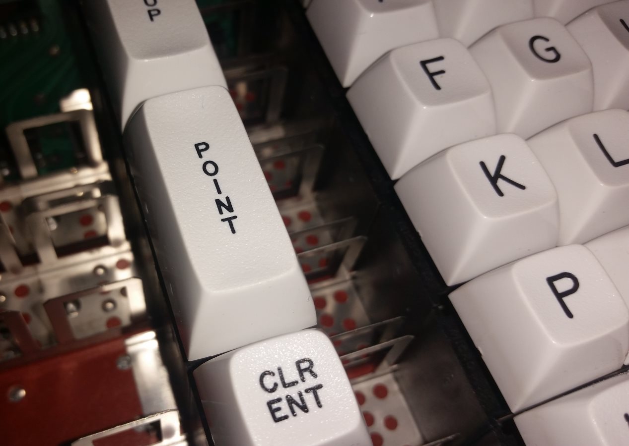

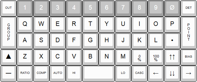

I don't have a $_0,000 TDC lying around, so the board is useless in its current form. I want to take the switches and the mounting rails and make a new keyboard. My intentions:
* carry over the matrix layout, for better or worse
* reflect the nature of the original board in a simple, practical design
* don't spend too much money
Quick sketch and tentative layout:
127997-2 127999-3

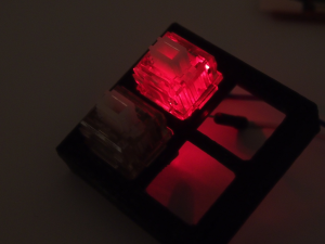

Oh, and here's my board. 25 Hall Effect with LEDs and relegendables, 76 Hall Effect with PBT doubleshots. I was surprised that the ones on the left weren't cheap substitutes, but then again this keyboard retailed for about $2,000. Made by Micro Switch in Freeport, IL.

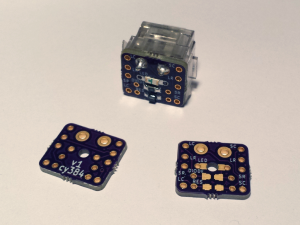

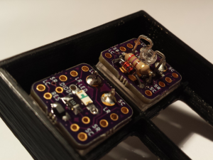

I already have the PCB blanks, so I'm hoping to have that finished soon (still figuring out PCB design). I'll put an ATMEGA32U2 under one of the black stabilizer switches.

This is very cool! What do the switches feel like?
Thanks! They're linear and very smooth. I think the actuation force is about 65g. It's hard to get a real sense of the typing feel because the key groups aren't big enough to put two hands on, so I won't really know until I have the PCB put together.
There's a thock on bottom and top out, but these switches are very quiet overall. They sound nothing like the few Hall Effect typing videos on Youtube - those old boards have huge cases for the sound to resonate in.
They're the most solid switches I've ever felt. I think the ultra-thick caps help with that. There's no conventional plate, but the switches are mounted on steel rails on top of a hard, rigid insulating layer, and then the PCB, so they feel plate-mounted.
