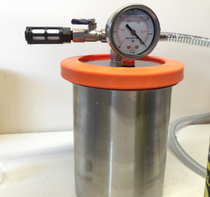

DO NOT EVER RECOMMEND A HARBOR FREIGHT PRESSURE POT.
This is something mentioned in thread after thread after thread.  It is never worth cheaping out on a pot.   Even if it doesn't maim or kill you, if it goes, it can cause substantial property damage.  The risk to yourself is not worth the cost savings.  If you can't afford a proper pot, explore other options.
+1
Yeah, you guys are right. I've retired the pot and won't be using it again, but I'm looking forward to my CA Tech pot. It's going to be a great feeling not constantly worrying about explosions. Thanks for the advice guys!
I would suggest a Binks pot.  CA-tech is a decent company, but I would rather see people go for maximum safety instead of cost effectiveness.
+1
Great suggestion. I actually got to see a Binks setup in person, and the pot is really high-quality. If I have need of a second pot in the future, I will definitely go with one of those for the higher pressure rating.

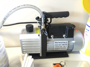

With the help of a colleague, I've been designing a new prototype mold box that will be used in future production. This will be an improvement over the current production boxes that I'm using for my molds. We're working on the V2 prototype, which will then be machined and branded for KeyForge.
My wish is to have an easy to use mold box that will not require any additional parts, such as legos or other systems to cast. It will not require additional walls that you have to rebuild every time you cast silicone. It will be modular with a simple locking mechanism, so I will be able to unlock and swap a single piece to change stems. The mold box is also used to pour resin. This will not be something that I plan on releasing or selling to the public, simply because Binge has a great consumer design with his Synth. This will be for KeyForge alone, and just make my existing work easier with less silicone and resin waste. Once I have a prototype, I will release some images.

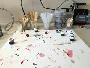

This is my bench and my CA Technologies pressure pot after a long day of casting and preparation for the upcoming sale. I realized I never showed it off to you guys, so I need to take some photos and do a quick review. I'm drawing up some plans for my future workbench, which has a hole cut in the top of the bench so I can mount my pressure pot inside. Basically, half of the pot will be inside of the workbench, which will make it sturdier and prevent it from moving while I secure the lid. Also because it will look sweet. I'm going to do another hole for the vacuum chamber, so that when you look at the bench you'll only see the lid of the pressure pot on the top of the table. I'm pretty excited for the workbench, but I'm taking my time with it. I want it to be awesome. I'm being really picky about the pieces of walnut that I'm choosing, so it could be a while.
135703-2

Hey guys! Things are coming along great! Thought I would drop a few pictures off:
Here are some color tests on the non-production molds, so please excuse the flashing and imperfections. I like to use my retired molds to test colors and new ideas. The top two are the triple-shot Sabers, one light brown and the other dark. These will be available in limited numbers for MX and Topre.

Vacuum Chamber/Pump
As a beginner, it was hard for me to understand what exactly I needed to be looking for in these two items, as I had never worked with them before. Basically you need one so you can pull as much air out of the resin or silicone as possible before pouring. If you can only afford one setup, I recommend getting a pressure pot first and then a vacuum setup later for best results.
I really saw the bubbles being pulled out when I switched to a viscous transparent silicone, where you can see loads of bubbles after mixing the two parts together. After vacuuming, they were pretty much all gone and it poured very smooth.
People told me that I needed a pump that pulled at least 30 inches of mercury, and that was about it. I did a ton of research, and finally stumbled upon Best Value Vacs. I was really skeptical at first, simply because of the bright orange color and ugly graphics. I mean I was looking for a vacuum system, not a toy. I ended up grabbing a small 1.5 gallon chamber and a 5cfm single-stage vacuum pump after talking with their reps to find what worked for my setup. When I opened the box, I was really surprised at the quality of the chamber and the helpful instructions. There’s a lot of ways that you can do the vacuum setup, but I have no regrets about buying a quality chamber and pump. The chamber is really small, but it’s perfect for my needs and I’m able to pull down vacuum very quickly.
PRO TIP: My vacuum chamber is stainless steel, so I poured a layer of silicone onto the inside bottom and let it cure. Like the pressure pot, it just keeps spills from getting stuck to the metal and makes cleanup easy. I can peel it out and pour more in there if it gets too dirty.
You don’t absolutely NEED a vacuum chamber, but you’ll get much more consistent results if you have one. It really helps get the initial bubbles out before putting everything under pressure. It’s worth noting that if you only have a vacuum chamber and not a pressure pot, you will still get bubbles, especially if your sculpts are rough or have jagged edges. I tested this several times and I almost always got bubbles when only using a vacuum chamber.
