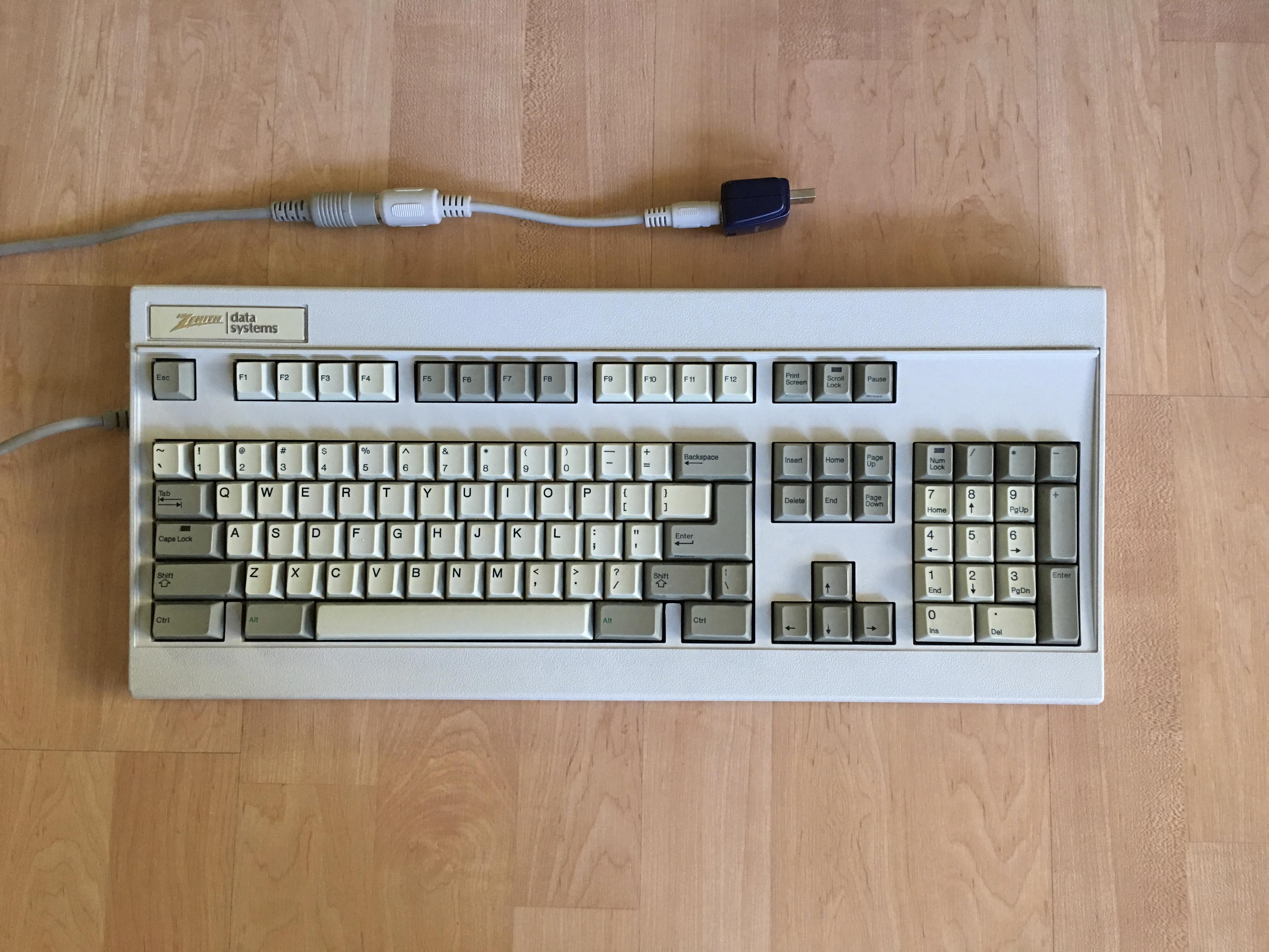

Hello Everyone,
I've been reading this forum extensively for a few years, found lots of great stuff to get me going using old boards.
I've recently acquired a Zenith ZKB-2R and although the board doesn't particularly looks exciting, the green ALPS keys are amazing. And the red LEDS. Gotta have that.  :cool:
Anyway, from what I've read here, the layout is relatively standard that it should work fine with a simple adapter on a modern OS.
Mine doesn't. It is switched to AT mode, The At plug is connected to a AT > PS/2 converter and then PS/2 to USB (powered).
When I plug it in, all LEDs turn on but not a single key works. Doesn't chirp either. I'm using a model M on my iMac (OS X 10.11 El Capitan) with same powered adapter with no issues. I also have another AT to PS/2 adapter (not cable but single piece) and same result.
I don't think it's the AT > PS/2 adapter since I've got two models and neither work. Could it be the board itself that is defective?
Thanks for the help!
Here's a picture of the set-up:
142611-0142611-1

Huh. Have you tried the board on Windows or Linux? It looks like the keyboard is detected since OSX see's its a keyboard but something else is causing interference. But it could just be picking up on the adapter and not the board itself. Check the cable and capacitors.
If nothing works I would be happy to take it off your hands. If its truly a bad keyboard I could probably fix it with a solder iron and a lot of time.
I have a Surface Pro, I've tested my Model M with it, works great, but the Zenith is the same story with all LEDs on and nothing else, on all 3 adapters.
Also, upon opening the board, it doesn't look good in my opinion. I have a 70's Dodge with less rust than that. The two small chips at the top had a few legs with blue corrosion, so the defective board theory is reinforced IMO.
