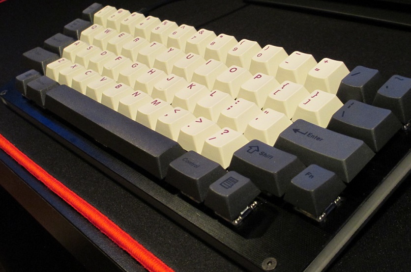

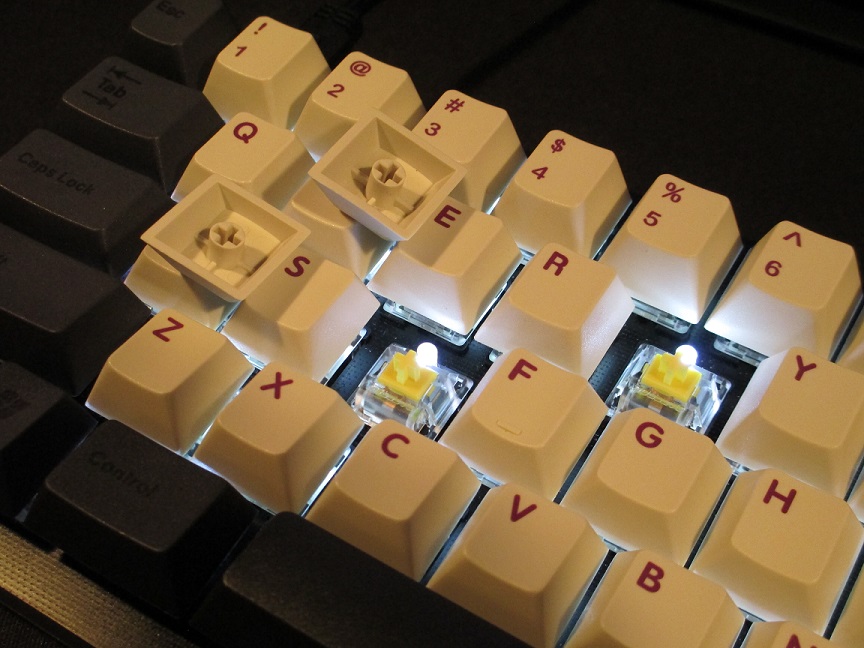

Shown below are two pics of the keyboard:
Close-up of the Gateron dye-sub PBT keycaps, Gateron Yellow Clear-Top switches with White LEDs.
142613-0
Note that the white Gateron PBT caps are sufficiently thick and/or dense that they do not allow the LED light to shine through. Similarly, light does not penetrate the Originative black PBT keycaps.  Incidentally, I tried some white Ducky PBT caps, and these did allow some light transmission.
View of keyboard showing the HHKB layout.
142615-1
Apart from the Backtick/Tilde, Tab, Enter/Return, Left Shift, Right Shift, and Fn keys, the legends on the Originative caps do not match the HHKB layout. However, this is not noticeable in dim light. For those who prefer the correct legends, these are provided on the white lasered PBT caps that come with the keyboard.
