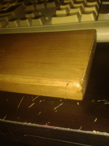

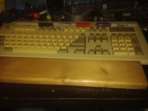

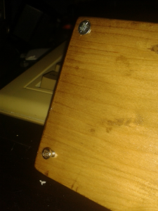

to begin with, i got a chicony kb-5181 and those of you who have used them know that they are higher up (higher than my last keyboard) so i decided to make a wrist rest. i am pretty sure the material i used was birch as it is slightly yellow and is a softwood. the dimensions (WxLxD) are 79mm x 417mm x 18mm. after i cut the wood, i sanded it like crazy as it had permanent marker on it from a previous project. to achieve a comfortable curve for my wrist, i used a file and more sanding. after the sanding, i used normal wood stain to stain the wood. this was pretty easy and fast to do as it dries quick. after, i drilled 4 small holes to accommodate the screws to stop the rest from touching my desk. after, i used clear coat spray (polyurethane) to protect it. finally i put the screws into the base which elevates it but stops it leaving polyurethane residue on my desk.
here are some pictures of the finished product
a close up of the wood:

the underside:
143200-1

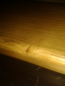

knot in the wood:
143202-2
next to my keyboard (messy desk ;)

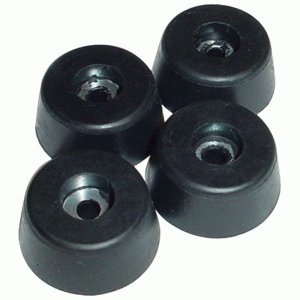

Yes - looks good so far - go to autozone/advanced auto or whatever autoparts store nearby and pick up some vacuum plugs like these:
They fit over the screws.  I used some of these on my AT101W:
Paired with some aluminum threaded inserts they're adjustable in height.  They work great for wood, too.

yeah i was planning on using those style feet but the wood now with flat screws just goes a bit over the keyboard.
