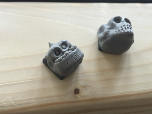

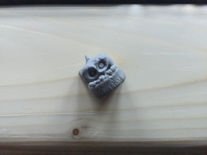

I didn't really have a vision of what I wanted in a cap, so I just started sculpting and ended with something I was happy with. Before I made a mold of the sculpture I decided to start with a blank cap for practice, and also because I really want to make a blank set for my HHKB.
143875-0143877-1
143879-2143887-3

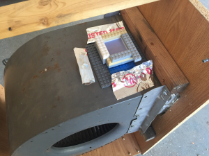

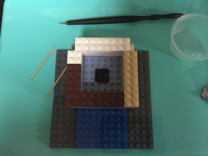

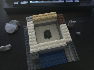

I used some Legos for a mold box since that's what I had on hand . I was worried about bubbles, so once I poured the silicon mixture into the mold box I decided to place them on top of a blower as it offered vibration and it seemed to have worked well.
143881-4143883-5

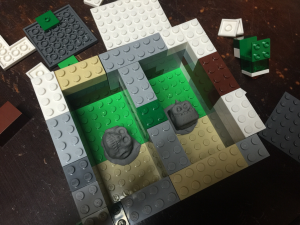

The mold held well and I'd decided to do both designs at once. I'm also gonna do the other half of the blank tomorrow, and hopefully, I can have my first custom cap by Monday as it takes 24 hrs for the epoxy to cure. As for colorway ideas I was thinking camo, but as I haven't the slightest idea how I'm going to start with transparent red.
143885-6

Your sculpting looks pretty good. Eager to see how they turn out.

I'm slightly worried about the toothy guy's chin - looks like it might hit the cap below when you put him on a board?  Pretty sure the skull will hit all round too, but that seems to be backgrounded anyway...

You called it orange haha , both designs had issues on different keyboards. I also managed to sculpt a more appropriate sized key. I'll update tonight with more photos.
