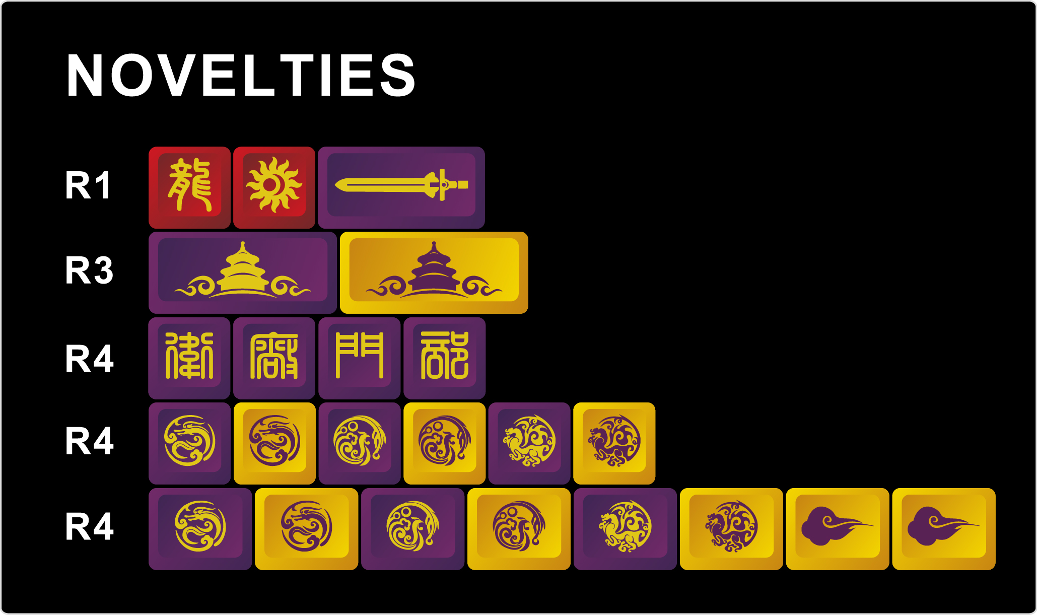

I'd like to make novelties for my keyset project but I struggle getting a clean result, and the only one that was nice, was one with a transparent background...
But then I see people getting incredible result in their keyset ( like the MING Dynasty set 144981-0 ) and I'm wondering how they do and what I'm doing wrong...

Be careful though. Some of the novelties in that Ming set may not be manufacturable (some details I see there may be too small for the cutting machine tolerances that SP uses for producing double-shot plates). Don't go into it thinking that just because you can draw it and render it to a JPG file, that SP will be able to make a keycap legend out of it.
