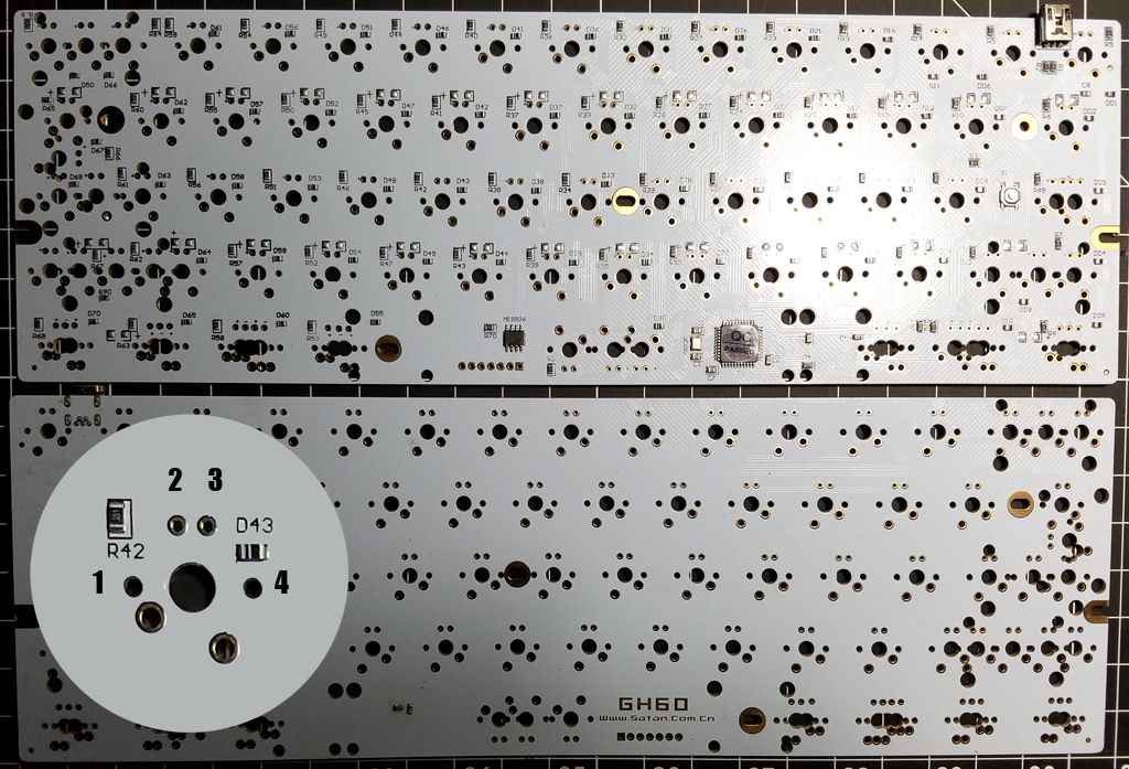

Here's the image, but I think I see what I was missing, now.   Amazing.  I don't know what I thought those were.
Re: Resistors, Diodes, and LEDs - Do you use them or no?
« Reply #6 on: Thu, 15 September 2016, 04:53:38 »
R = Resistor
D = Diode
All you have to do is solder the switches in, and if you choose to, solder SIP sockets/LEDs.
Cutting them to length is because the legs of the SIP sockets/LEDs are much longer than you need them to be so you simply cut them either before or after soldering onto the board.

Thanks, yeah, it's dawning on me how much less there is going to be to solder than I'd been thinking.  If we decide against the LEDs, unless I'm forgetting something, we can get started on them this weekend.  I forgot to ask in my last post; there are 4 numbered solder holes. What goes where? And do the SIPs just solder in these holes?
« Reply #8 on: Thu, 15 September 2016, 05:48:54 »
1,4 aren't solder holes they're just for PCB mounted switches, they have little pegs at the bottom that fit into those holes to stabilize the switch.
2,3 are for LEDs, you have to figure out the polarity since it isn't labeled (just plug the board in and touch the 2 legs, if it doesn't work that way then flip it around)
The switch can only go in 1 way, you'll figure it out.

satan pcb has everything presoldered except the switches and LED.
though sometimes they come with no firmware on them. and sometimes they do. depends where you get them but i've done I think 3 and 2 of them had no firmware on them when they arrived, and 1 of them did.
Also, holes 1 and 4 in your picture aren't actually big enough to accept the pegs on cherry switches. I'm sure they were supposed to be - but they are fab'd too small so you will have to clip all your switches if you are using pcb mount switches. (5 pin ones instead of 3 pin ones)

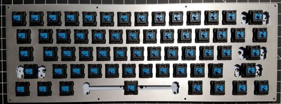

Image of our plates:
Nothing's been soldered yet.  Recommendations welcome.

That's a nice plate. Steel? Seems much easier to work with than those generalized alu plates in all the colors of the rainbow, where you can't really use plate stabs due to the multiple cutouts.
If you need recommendations on the stabs, I still recommend either Costar plate stabs or Cherry PCB stabs. Cherry plate stabs will work fine on that plate, but I have some bad experiences with them personally.

It's aluminium, and though I'd be even more pleased if it were ss, I was pleased with the cutouts. Each switch was quite snug in each slot. There's a back plate with matchingt him to this  screw holes. I had posted an ad here looking for parts to build two skeleton case 60s. Someone wrote that he'd seen something on Reddit, and that's how I found them.  It was a square deal all around. Curious that he isn't here, or at least didn't advertise them here.
