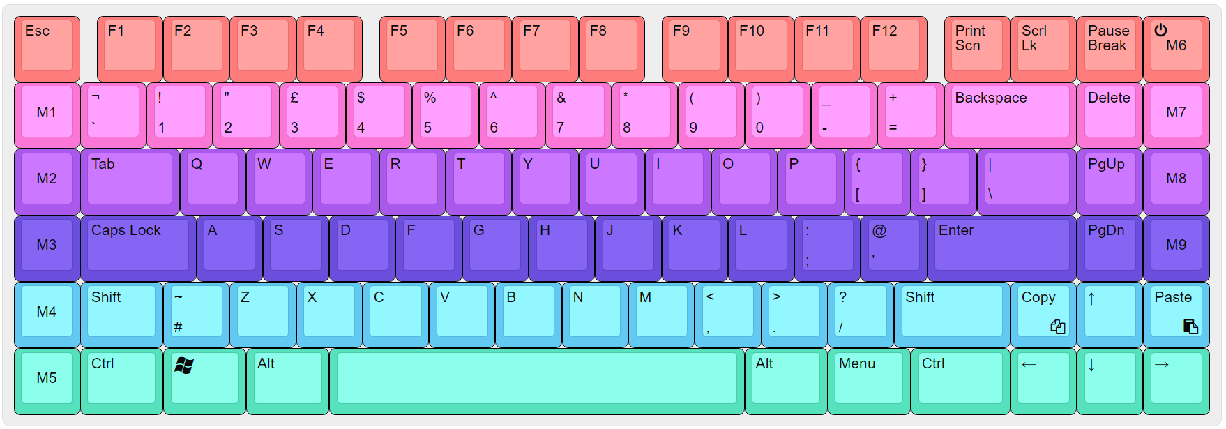

At the moment i'm still tweaking the layout to suit my needs, but as it stands i'm looking 95% finalised and ready to order the mounting plate:
Colours are to reference my proposed switch matrices only (all switches will have diodes)
148943-0
I may yet loose the whole F-key row and swap 'Tiddle' for 'Esc'

Hi mark,
I'm DIY  keyboard of my own too. And your layout is very similar to mine. :))
151406-0
How is your progress now ?
I'm now trying to draw the PCB.
 151408-1
And I like your design of the "Copy/Paste" key. Do you have  any idea of how to implement it ?

Hi yeti,
I was just going to use macro's to set the copy/paste keys (ctrl+c/ctrl+v), however I do believe there are already keycodes for HID copy/paste but don't quote me on that!
However as far as using the Teensy 3.2 that has gone out of the window and I have ordered 2.0's instead as there is a lot more support online and on GH for using that controller.

hi mark,
Teensy2.0 is a good controller since it has more infomation online. But 3.2's is also good cause it's very easy to learn. I've read both document of them.
Maybe I'll update my kb' layout by replacing two keys into COPY/PASTE  ;D
I'm using the MacOS and I want to make it worked on both Windows and MacOS. I am going to check is there any way to implement on a lower level of the system.
I'll follow your project and if I have any progress I'll reply to you too.
Also if I got stuck with I'll let you know. Anyway , really appreciate to that.  :thumb:

Thanks for sharing with me!  :thumb:
hi mark,
I'm stuck again. The key of my layout is not easy enough to be found. The row 2 and the row 3 has the different height.
Yep you will find that with custom layouts from time to time, i have a couple of keys which are from the wrong row etc... For example, my Quark keyboard layout:
152410-0
Esc - higher than the qwerty row
Space - 2.75u Right shift turned upside down to be more comfortable to use with my thumb
Del/backspace - lower than the qwerty row (came from insert, delete, home, end, pgu, pgd key block)
Enter - 1.5u Win key (thankfully this is the same height, but doesnt say enter!)
right Shift - 1u blank key
Up arrow - higher than the rest of the row but acts like a homing key!
You will either have to search for custom keys in the row that you need or use blank keys (blank keys are a lot easier to find!)
At a glance from your layout photo you will have height problems with the following keys:
Pause/prt sc,
ins/del,
pgu/pgd,
home/end,
fn,
ctrl,
alt,
mac,
space,
M1,
M2
Arrow keys!
The arrow keys should work in your favour though (well they do for me) as the height difference makes them feel like homing keys!
Honestly i'm not even sure if you can get 3u keys to be honest, but don't take my word for it as i'm new to this!
You would be better asking around or looking in the classified section
« Last Edit: Tue, 08 November 2016, 13:00:42 by mark.wood_uk »

hi mark,
I will use DSA  keys which have the same height.You can find the difference between them through the url below.
http://keycapsdirect.com/key-caps.php
But the 3u space keys is really hard to be found.  :-[
