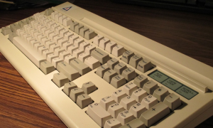

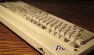

Recently, I was fortunate in being able to find two Leading Edge DC-3014 blue Alps keyboards in rapid succession.
For the time being at least, I have decided to keep one of them (I'll call it DC-3014A) in a nearly stock state -- the only modifications I've made is to install an internal converter and micro-USB panel-mount connector. I also quieted the spacebar by swapping out the slider and click leaf on the spacebar switch with the corresponding components from a Matias Quiet switch.

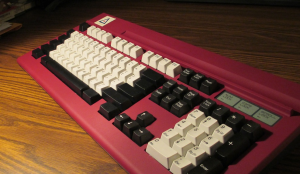

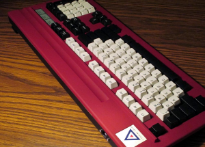

The other one (dubbed DC-3014B) also has the internal converter and micro-USB connector along with a painted case and new keycaps (SGI Granite alphas; others from Matias and Tai-Hao). Its spacebar also has a transplanted slider and tactile leaf from a Matias Quiet switch, and the Matias spacebar has 0.5 mm urethane foam pads on the plate where contact is made with the stabilizer inserts.
150223-2
150225-3
Even before making these relatively minor modifications, I noticed that I had a preference for the sound and feel of DC-3014B. The differences were subtle, but noticeable. Now with the replaced keycaps, the differences are more apparent, and I definitely prefer typing on DC-3014B.
I've noticed differences in typing characteristics on other Alps boards of the same make and model as well. For example, I have two Northgate Omnikey 101 white Alps boards. Even with the same stock keycaps on each, the two boards have a noticeable difference in sound and a just-perceptible difference in feel.
One difference between the two Northgates that is readily apparent is in the sound from brushing fingertips horizontally along a row of keys -- one of the boards makes much more of a racket than the other. I thought that this difference might be due to the relative degree of wobble, but as far as I can tell, the wobble in the switches is the same between the two boards.
