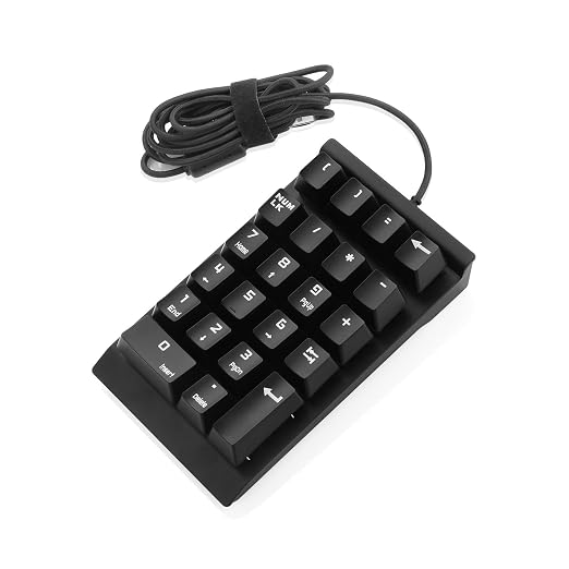

Since case and plate where needed for the project, I decided to buy a Jelly Comb Numpad on Amazon and mod it. The item was € 15 on a lightining deal.
It comes with 22 Outemu blue switches, a steel plate, a PCB, a non detachable USB cord and 2 Cherry plate mounted stabilizers.

The first thing to do is to remove all the original keycaps from the Jelly Comb Numpad and throw them away.
Screws are now exposed so you can take them off. There's no screw on the backside.
