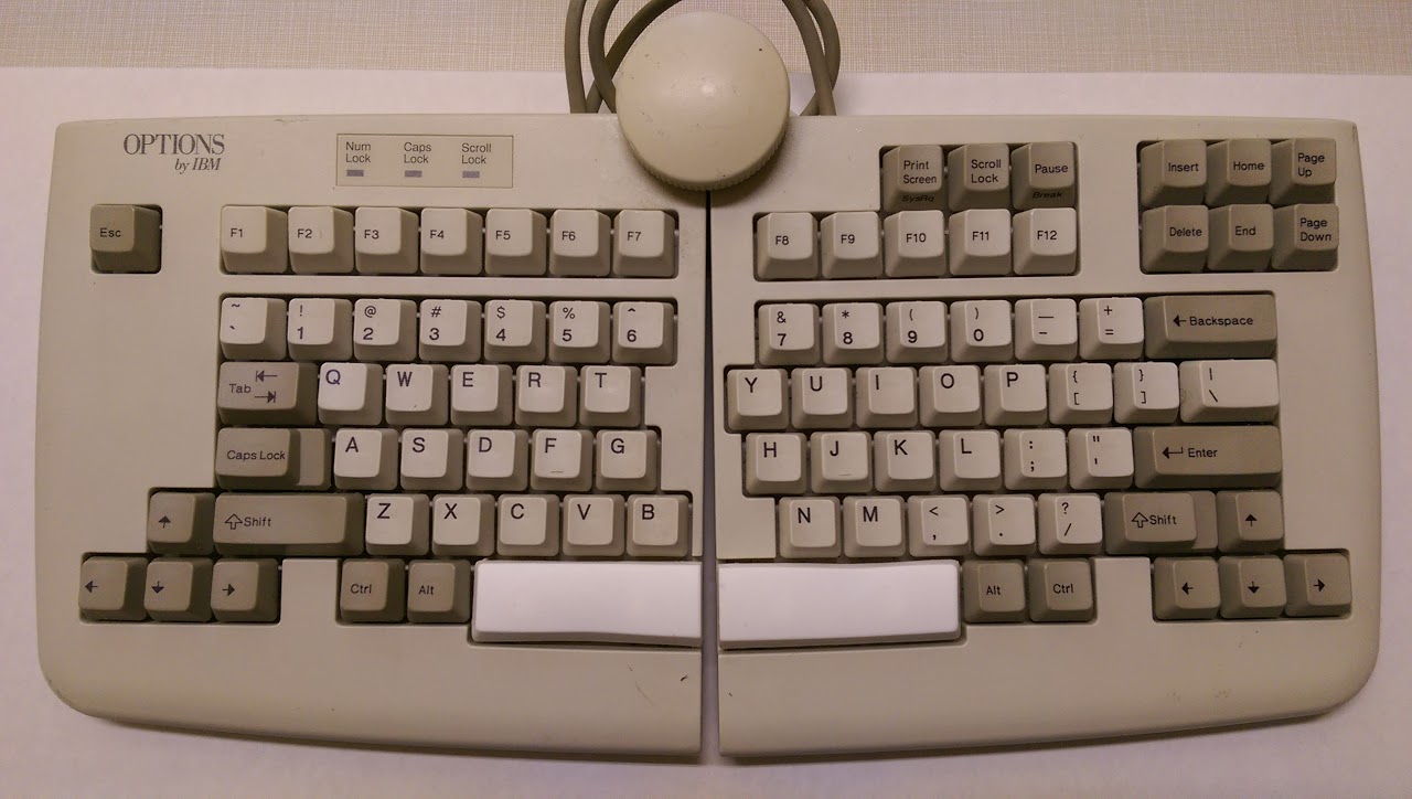

Finally, XMIT036 with the new, working replacement caps!
155215-0

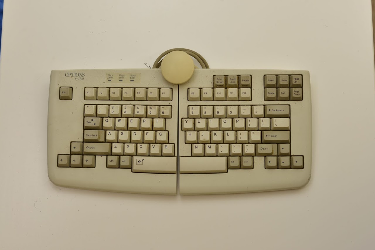

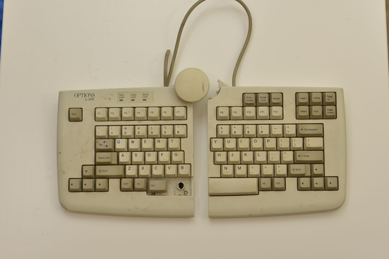

XMIT036 is one of my IBM Model M15 buckling spring ergonomic split boards. Here's how it looked before this project.
155203-1
As you can tell, it is missing the left half of the Space bar. (In this photo the ball mount on the right half is also broken. I've since fixed this with 3M DP460 epoxy.)
Fortunately, I also have XMIT035, which is a complete board.

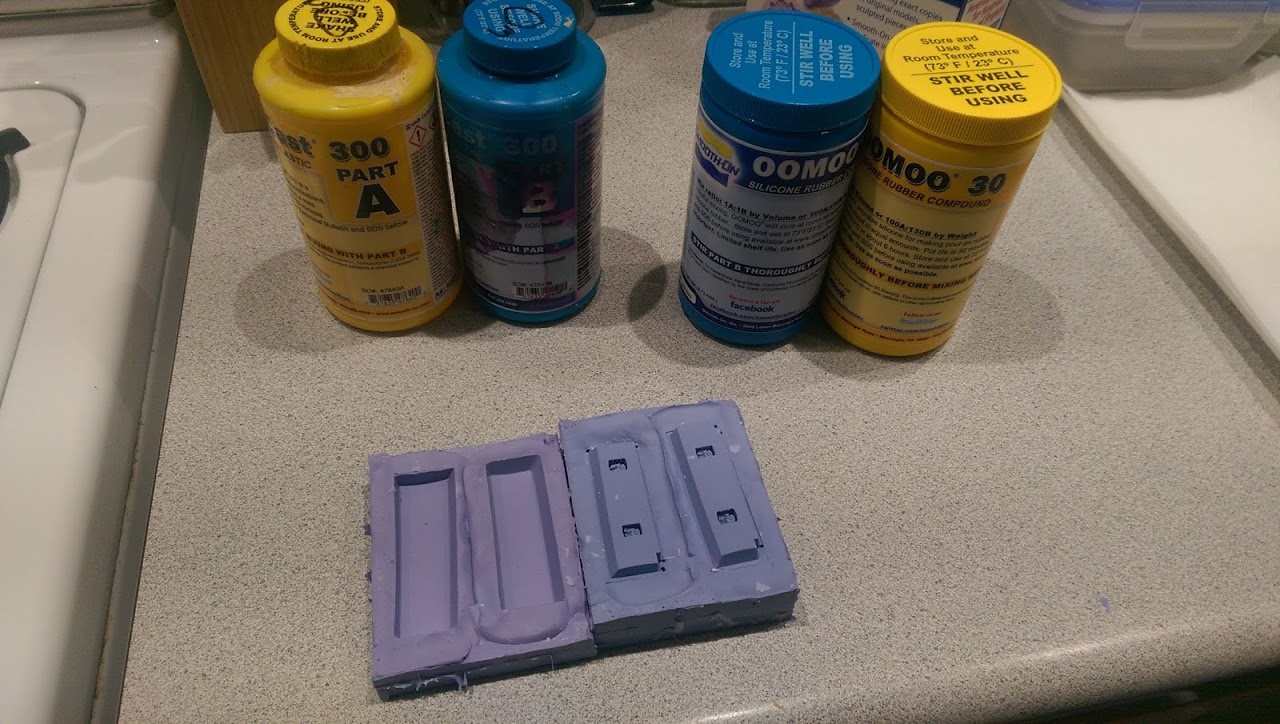

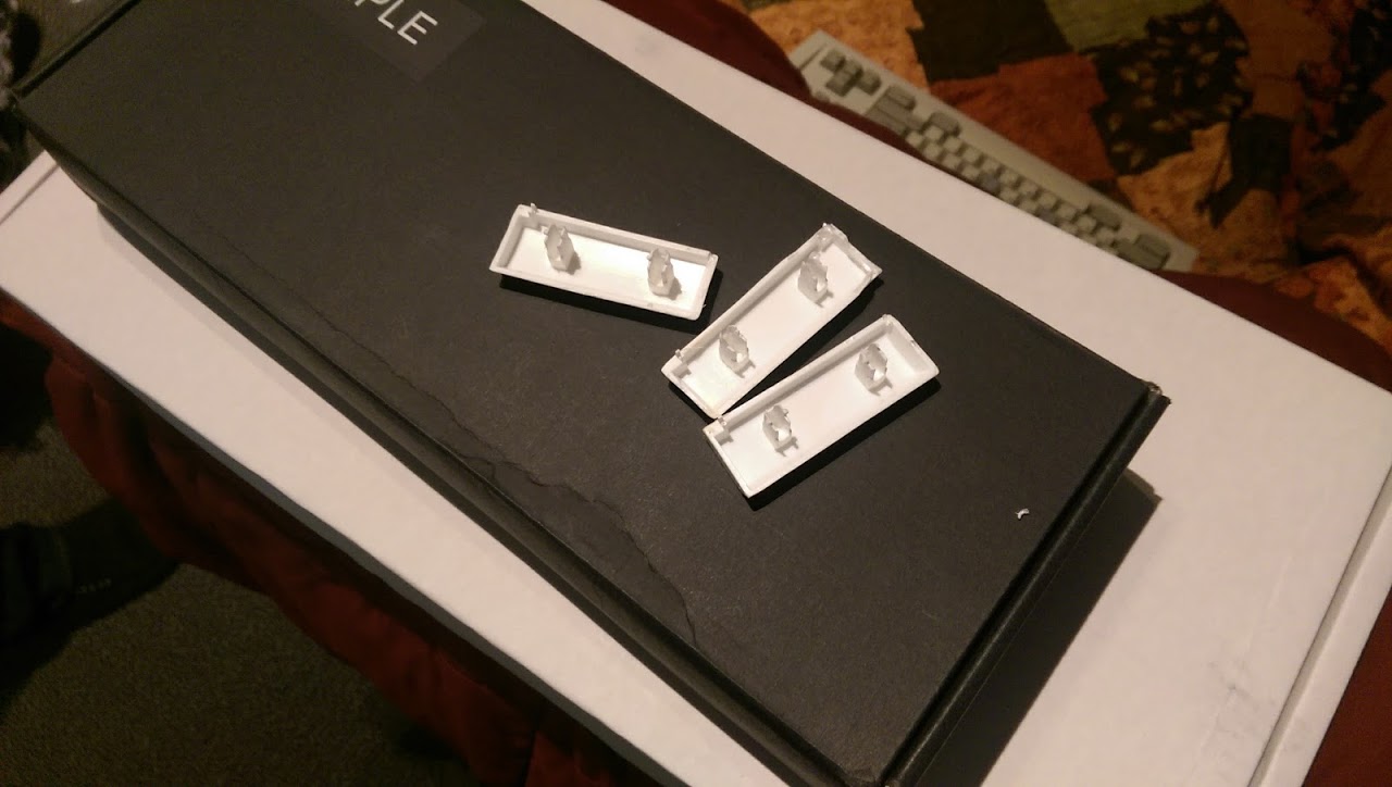

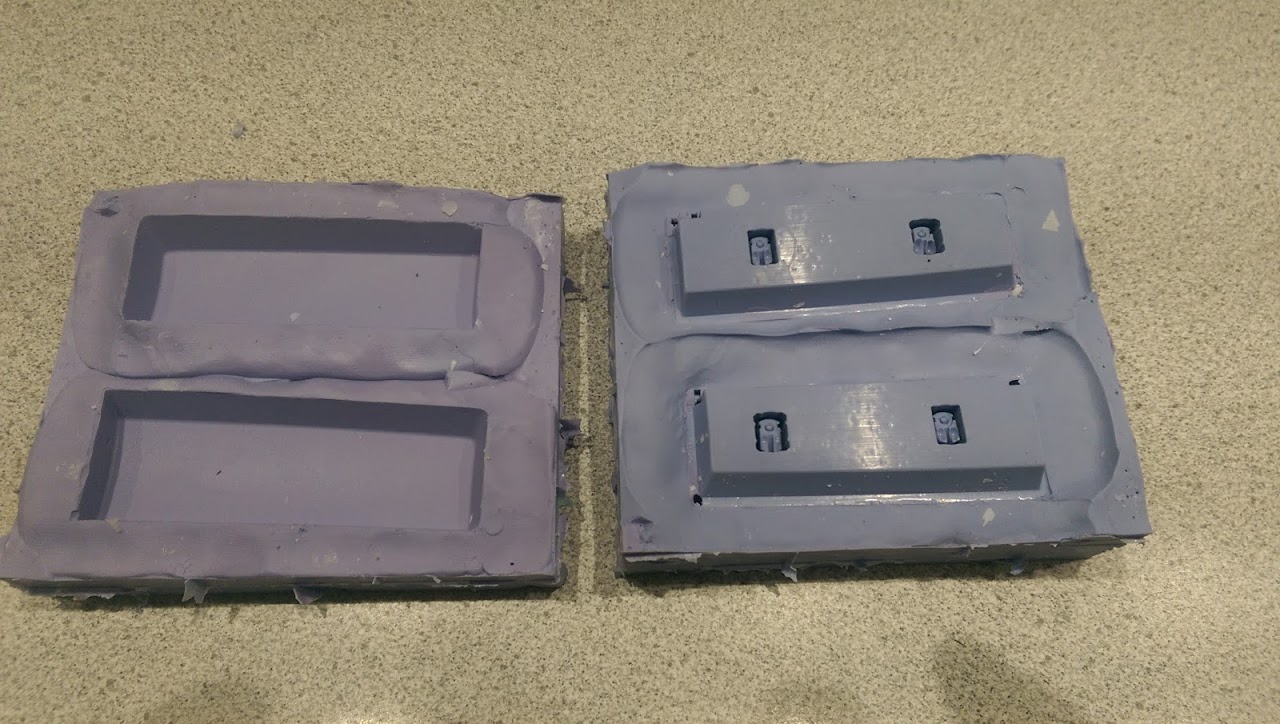

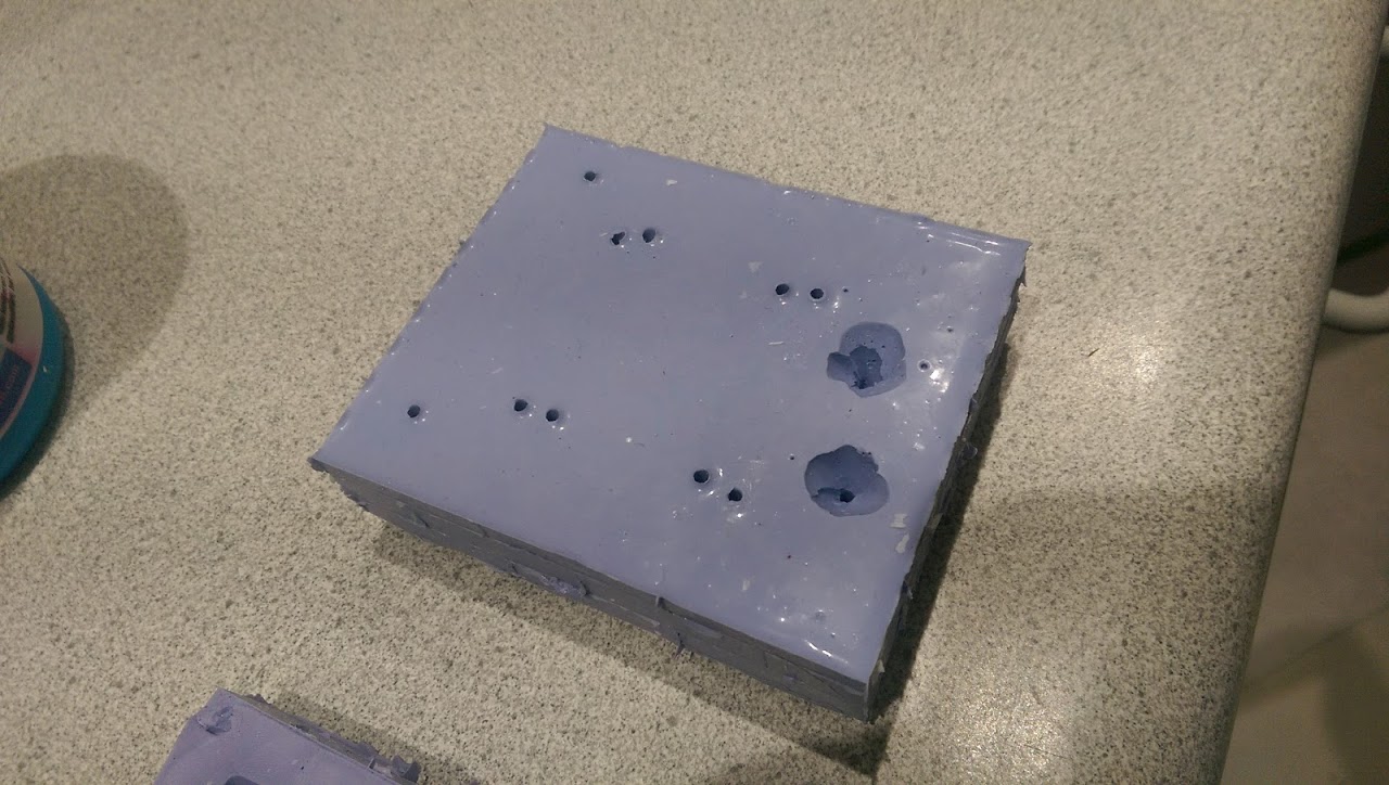

So, I thought, why not cast a new replacement Space bar set?
This project sat on the back burner until this week. I had a business trip. Through the geekbnb network :)) I connected with the incredibly awesome ImpendingxDoom who let me crash on his couch while I was in Chicago.
Now, I've had some experience with silicone mold casting, but Doom takes it to the next level. He's had almost two years of experience doing two sided molds, while I've barely done one single sided mold. We got some great results! These are not even the best ones...
155207-3
155209-4
155211-5
155213-6
