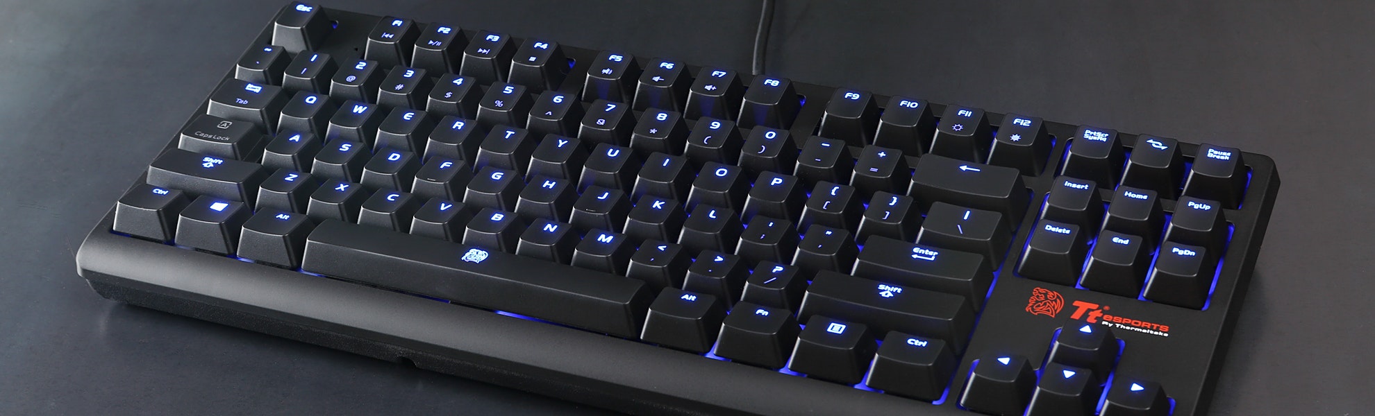

i would like to do keycap backlighting as far as the back light goes. If the phantom doesnt support in switch leds where should i look from here? I have tried googling but not entirely sure the proper search for what im looking for. any suggestions on where to start?
i want to build something like or similar to this:
