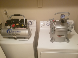

Pressure pot and compressor finally came in!!
Woot woot!

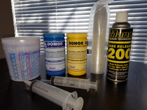

I have decided to start working on creating my own keycaps. These forums have been tremendously helpful and I'm hoping that by making a thread of my own I can help anyone else who is starting out. If anyone has any tips for me or is looking for information please reach out!
I started by ordering a number of different items to jump start my supplies.
163563-1

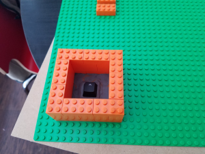

Started with Oomoo 30 for the Mold. Ease Release 200 to help with separating the resin from the mold and other assorted items to help with the process.

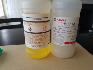

163565-2
Ordered IE-3075. Will be trying out smooth-cast 321 as well when it is shipped over.

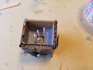

163567-3
Tried attaching the q-tips as sprues to these three locations but found that adding another q-tip on the opposite side of the middle section helped fill out the mold when pouring the resin.
163569-4
Updated my molding process to make for easier mold changes and reusability.

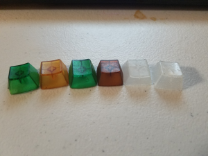

163571-5

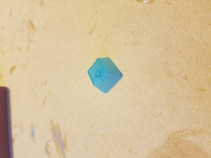

Lineup of some of my first tries. Many were wayy too soft to go on a keyboard so had to continue with process research.
163573-6
Recently finished this one which I am very happy with! Bubbles are still happening which will eventually be ironed out with the pressure pot but it's finally the correct strength and able to be placed on the keyboard!
That's it for today, hope to hear from everyone with feedback / any questions you may have!

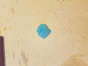

Update!
Was able to get wayyy less bubbles on this round. I think it was the combination of stirring more carefully and preparing the room temperature before casting.
163895-0
Also working on a new mold with a thicker top half to get rid of the lines that shine through. Anyone have advice on that? I'm just squeezing clay into the bottom of the mold cap to create thickness.

Get a digital scale, the small ones that measures up to 200g and can read in 0.01g increments. I used to measure by eye using syringes too, ratios are always off.
Soft results could be caused by the lack of heat. I had this problem even if I left it for hours to cure. You can either heat up the molds beforehand or put the mold into a heated environment after you've poured the resin. I now put mine in a slow cooker  ;D
Bubbles will always be there if you use fast curing resin without a pressure pot. You could use a slow curing resin, they produce less bubbles.

Do you have any recommendations / info on a pressure pot to purchase?

I don't have recommendations for pressure pots because I don't use them myself haha. Someone will recommend some no doubt.

I wanna know exactly when pressure pot is recommended and why. It's depends of type of resin?

You can pressurize silicone during the mold making stage to have perfect molds that can be used for resin casting.
You pressurize the silicone, as resin casting under pressure requires silicone cured under pressure, otherwise you end up with "pimples."
Pressurizing resin allows all the air bubbles to be crushed to microscopic sizes. This is especially useful with clear casts, as air bubbles are way more noticeable.
In addition, the physical strength of the cast is increased as more solid resin, instead of millions of tiny bubbles all inside.

Some resins will be much easier to cast in a pressure-less environment, such as less viscous resins. The thicker everything is, the more likely air bubbles are to get trapped.
Pressure pots are used to crush any microbubbles that may be present in the resin while it's curing. This helps create a stronger, more rigid result, and as mentioned before, it's especially helpful with clear resins. As far as a pressure pot, I personally use this one and haven't had a single issue: http://www.finishsystems.com/resincastingpressurepots.html
If you're casting in an area where sound might be an issue, this is by far the quietest compressor I've heard (I use this one as well): https://www.amazon.com/California-Air-Tools-2010A-2-0-Gallon/dp/B00TDNKBMC/

My only caveat is please be careful with 'cheaper' pressure pots. The cheap ones can and have failed, especially those from Harbor Freight.
Avoid pressure pots with this style clamp:
And instead search for ones with this style:
The first style will essentially end up digging into the top of the pot, compromising the integrity of it.

« Reply #25 on: Fri, 31 March 2017, 07:40:13 »
Very excited to show the two caps that cured overnight!!
164407-0
Was able to separate the two layers better but still want to try and let the first layer sit a little longer next time.
164409-1
The top layer glows :D
164411-2
Wanted to try pure transparent glow
164413-3
 :thumb:

Blanks came in!!!
165539-0
Made a new mold with them. 4 at a time :D
165541-1
165543-2
