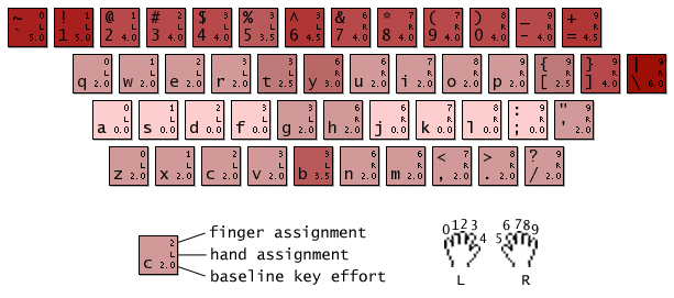

Acknowledging their model of base effort http://mkweb.bcgsc.ca/carpalx/?typing_effort “BASE EFFORT IS FINGER TRAVEL DISTANCE”
— where qwerty b has an effort of 3.5, qwerty y an effort of 3.0, while qwerty ;: and qwerty /? have an effort of 0.0 and 2.0 respectively, I am interested in layouts that place qwerty ;: on qwerty b and qwerty /? on qwerty y ... and then I have requests that will generate four different layouts.
