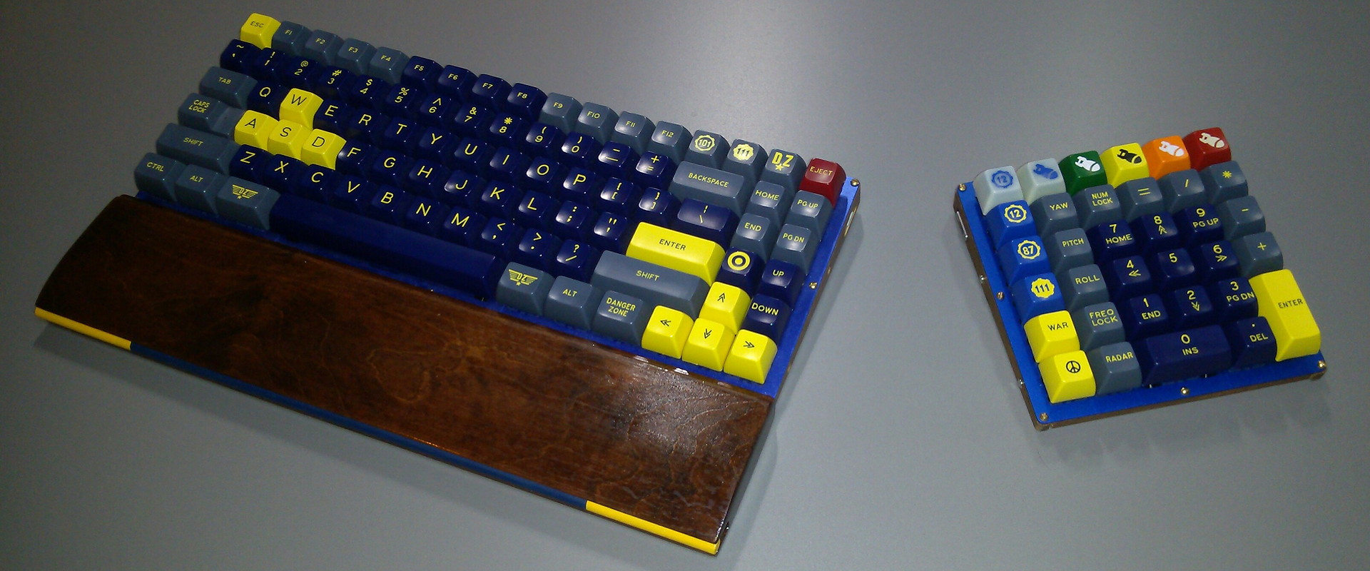

I have a keyboard project that's sat rather... stagnant for almost a year. The main keyboard is complete, and has been for a year, save for firmware. A sin, I know... The issue is that I'm a hardware guy... The last programming I dis was on a TI-89 calculator, and before that, on the Commodore 128. All I ever knew was BASIC, and even that's been a decade and a half since I even looked at it. I picked up this keyboard project, as well as a project to build a Kerbal Space Program instrument/control panel, to make myself learn C... Only I've not made much progress. Things got busy at work, I got on a roll working on the KSP controller, I got injured at work, then my motherboard died... All in all, a full year has passed since I "finished" my keyboard. It still has no firmware, and though I did finally get the plate to build the number pad, I still have not finished it yet.
My goals are:
A: To initially get a functioning firmware on my main keyboard, so I can ACTUALLY USE IT!
B: To figure out a way to be able to poll/not poll a port expander over I2C, based on the logic level of a "sense" signal.
So, here's my progress so far.

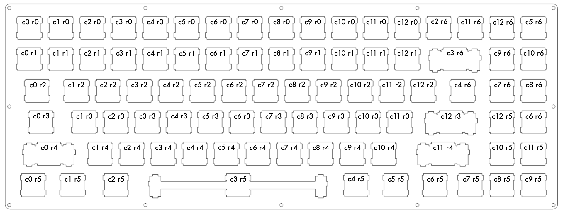

First, I've made up a nice layout worksheet that has all the electrical rows and columns identified not he physical layout. It's top down view, so it'll be useful for defining my key layout too.

I have a VERY dense matrix of 13x7. It was necessary to keep enough I/O pins open for the Caps Lock LED, Backlight LED PWM, a pair of I2C pins, and the numpad sense pin. The sense pin detects if the number pad is attached, and whether or not it should poll the numpad's port expander over I2C. I figure, software is changeable, so I can re-do code later, once I actually have the number pad built, and have half a clue what the heck I'm actually doing.
Anyway, since I had to keep the matrix small, That super dense layout has almost no gaps, and row 6 is actually a tight cluster of keys in the top right corner. An alteration part way in resulted in the very top right key having a completely nonsensical matrix position, because the change was literally a bodge. Only three intersections in the entire matrix go unused (c0-r6, c1-r6, and c12-r4). This means my matrix does not directly conform to the physical key layout in some areas (all of Row 6 is in the top right corner, and the bottom row is "electrically" compressed to the left, and then includes the keys physically in the bottom right corner well).
Now, I'm stumped at my current place in the code...
What have not figured out yet, is whether the matrix definitions need to be ordered by electrical sequence, or if the values are arbitrary, and allow for physical sequence (as long as the row and column values are correctly defined). The obviously functional way is to lay the matrix out electrically. This seems to be what's assumed with most keyboards, as most keyboards physical layout and electrical layout probably match.
My question then is which (either, or both, or neither, or 42   ;D ) would be correct?

My question is, are the values entered into the table above dependent on position in the list, or just by content. It'd be FAR easier to follow the second layout, but I don't know if it screws with the code to mix and match rows and columns onto different lines in the list like that, or whether it's all good, as long as the numbers match.
My understanding of the code, is that those lists are not "technically" even different lines... That they are basically one long continuous list, with breaks to make it easier to read. What I don't know is whether the code expects to read the list strictly sequentially, the same way it's scanning the matrix, or whether the code is simply defining the physical layout of the key map and defining what matrix intersection applies to the physical layout. I'm confused!
Basically, is the code:
A: expecting all the rows and columns to be in a neat and orderly incrementing layout (all the columns, in order, 0 to the maximum, for row 0, then repeating for row 1, 2, 3... and so on)
or
B: Is this list arbitrarily defining the row/column intersection values for the (later to be entered) keymap, based on the row and column numbers entered. Basically, saying "I want this layout to have r0-c0 through r0-c12, then r6-c3, r6-c11, r6-c12, and finally r6-c5 in the first physical row of keys"... Basically, so later, when I enter the keymap, it knows that ESC is r0-c0, F1-F12 is r0-c1 through r0-c12, and that F13 is r6c3, F14 is r6-c11, F15 is r6-c12, and the media EJECT key is r6-c5 (using my top row as an example).
Does that make sense?   :confused:

You know... I think for the sakes of just getting this thing up and running, I'm going to select option A, even though layout wise, it's unintuitive. It's intuitive in terms of electrical layout, not physical layout. That's because my electrical matrix kinda jumps around all over the place on the right side of the keyboard, where row 6 and the end of row 5 are all jumbled up into the right two columns.
I guess I KNOW sticking with the electrical layout WOULD work, and I can stick with the electrical layout with the character map as well. I just never got an answer in regards to if a physical layout based map would work, or if it'd "confuse' the firmware.
