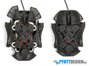

As far as shell, i have no idea what you have in mind & i'm sure some of the members of this great community would be willing to lend a hand. One thing i did find when i was looking before was this adjustable top shell for a Logitech M100 mouse. The top shell is very interesting and very unique in many ways, just wish it wasn't created for such a basic mouse.
169568-0
designers page: http://www.pyottdesign.com/statial01.html
top shell @ shapeways: https://www.shapeways.com/product/T4C3TT6KM/statial-adjustable-mouse
mouse:https://www.logitech.com/en-us/product/mouse-m100
Anyway, Congrats! And i'll anxiously keep an eye on the project.
