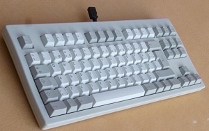

Several years ago, when I built my Phantom tenkeyless keyboard, I had built a case for it from parts from a BTC 5140 top and from bits and pieces of several other keyboards and not-keyboards.
For keycaps, I had chosen thick Cherry PBT in cream-white and grey, scavenged from multiple keyboards.
I liked the slight curve of the case top because it reminded me of the Apple Extended Keyboard II and at one time I tried putting an enameled Cherry Pin at the top corner, but in the end I opted not to.
Of course, the case looked like crap made from different plastic pieces so it had to be painted. For primer, I used Duplicolor beige primer that I already had on hand and found that that was not too far off from the Cherry grey, so I kept it.
Unfortunately the primer has a slight green tinge, but I have not heard about anything better.

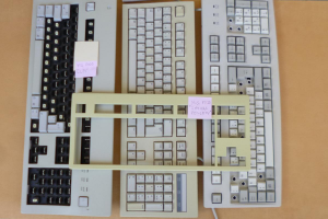

This is how it looks. For comparison. The painted case half is in the middle.
174493-1
I am not happy with that at all. It looks like plastic that has yellowed a lot in the sun and it is even greener than the primer I had used.
For comparison is a BTC 5140 (same model that I had built the case from), slightly yellowed, a Cherry two-tone cream and grey keyboard, and an Apple Extended Keyboard II (keys switches harvested for other things)
I also painted a card in Montana Gold Elm, which looked greyer in the swatch in the store - but the swatch must have been dirty. Montana Gold Shock White Cream is supposed to be whiter and only slightly less yellow than that card -- but you can see that the Apple Platinum style is darker.
The Apple keyboard is also darker than the Cherry.
So, MG Sahara Yellow was not a good recommendation at all, and it is probably that the MG White Cream would be a poor choice as well.
On the plus side, however... The Montana Gold spray paint often gives a grainy finish, which is really unwelcome for almost every application except when you are trying to mimic the finish on a plastic keyboard case.
What do you think I should do? Strip and repaint with primer, go for a completely unsaturated grey Montana Gold or something else?
If you have a recommendation for a "beige" spray paint, then please share!
