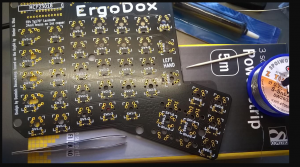

Hey everyone, I want to design my own board, basically just like the Ergodox but with more buttons and a closer thumb cluster.
I've been looking over the Ergodox design in KiCad and I've got some (hopefully not so stupid) questions.

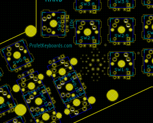

The first one is what is this star pattern and is it necessary?:
175793-0
Here's another photo of it
175795-1
My other question is that is it possible to add more buttons to the Ergodox? Would I have to reprogram the firmware myself? (my coding is pleb tier).
Lastly, do you have any control over how the back of the circuit board looks in KiCad?? If not then how is it that the left hand side of the Ergodox is produced from the one .kicad_pcb file which only contains the right hand?
It looks merely aesthetical to me.
You're not adding buttons to a ready made Ergodox, you're making your own PCB, so you can add as many buttons as you want, granted that your matrix fits your MCU and eventually I/O expanders. Of course you'll have to make your own firmware for that but there are a few firmwares' sources that you can use. What MCU are you using?
Such softwares usually show all layers together, so you can hide the layers you don't want in the way.
The Ergodox is a specular board made of two identical parts but flipped. If you look closely, every switch is made of four pins. That's because you can install the switch to either side. My guess is that Dox wanted to save PCB fabrication costs by making a single PCB that could be used for both hands. In other words, you need two copies of the same PCB to make a whole board.
