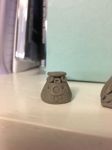

Current Sculpts:

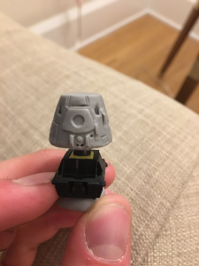

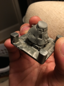

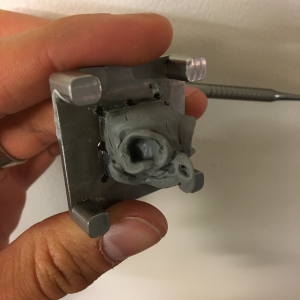

Apollo Keymand Module In process (It's busted. Will try again.)
177606-0

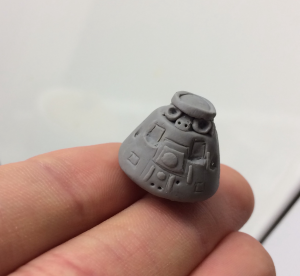

V2
178336-1
V2 after my kid found it :P
178338-2
V3 Abandoned when I realized I had made it too tall
178934-3

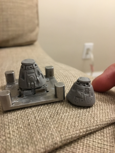

V4 Being Cast
178936-4

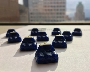

Mini Keyper Out in the world!
178938-5
178940-6
181357-7

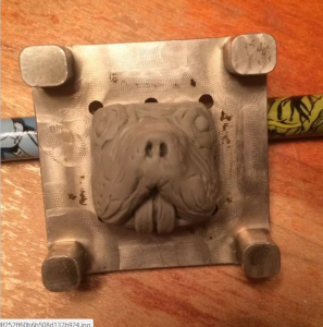

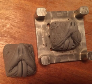

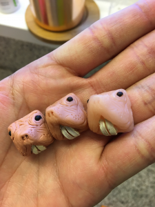

Nekkid Mole Rat 2nd Draft Finished,was cast, now in production! (I have a weird affinity for this lil' guy)
177233-8177231-9
(the middle one is the tone I'm going for)
178942-10

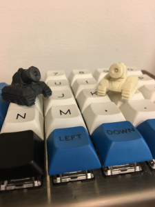

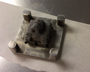

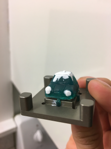

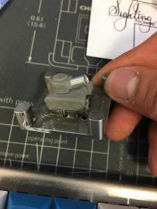

Tankey  Casted, it sucked. Will re-sculpt. (Going to do V3 to address concerns with proportions and detail)
177496-11
First semi-successful cast:
177769-12
A failed attempt at re-sculpting. Let's do this again...
178342-13

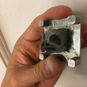

Random Bird Skull Cast/On Hold (It's weirdly tall. Unlikely to proceed further unless I completely re-do the proportions)
178340-14178346-15

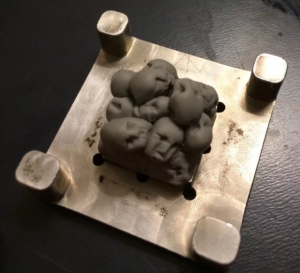

Pile O' Faces On hold (Going to redesign since I discovered SUK Legion was a thing :-[)
177227-17

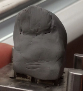

Big Toe Hilarious (I may just cast this for fun and to freak out my wife and kids)
177229-18

Good luck, I'm currently in the same boat. I have the $ynth and have made a few sculpts and am now preparing to take the next step into casting.
The one thing that seems like a must to get a bubble free cast is a pressure pot. I've been looking at the C.A. Technologies 2.5 gallon tank. It's not the cheapest option but comes highly recommended and seems to be safe as well (which should be priority number 1).
Excited to see your progress updates and to hear from any veterans that have input and advice.
Until then here's a sculpt idea I've been toying around with, the TiKey.  :thumb:

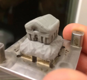

Update!
Finally got some tools and clay! I started at around 10:45 and am now calling it quits at midnight. Taking a stab at the building...
It's pretty rough to start, but the scale is about right and the clay is easy to work with. Now that this side is done-ish, going to see about adding columns/layers to the other sides while I think about how to get a base.

nice! after jelly keys med resort i thought somebody should do a ton of architecture. looks like you're the man to fill those shoes. you're a natural sculptor. great start

Okay, another random update
First of all, body horror creeps me the heck out. So what better way to explore that than sculpt some funky toes...
Big toe draft
A whole foot's worth of toes in the creepiest way possible
Toe'ts weird I know.

Nekkid Update
Taking another stab at the naked mole rat tonight which is pretty much just a way for me to practice wrinkles. I think the proportions are better (not to mention it's not so wide as to be ill-fitted for a keycap like the first draft), and I went with eyes that could be a secondary color rather than just holes.
Also, adequately creepy which is good.
Round 1 v. Round 2: Nekkid Mole-Rat
Some Detail

Drinking Update!
I don't drink beer usually, but a couple friends of mine have been trying to convince me it's worth my liver, so here we are.
Working on a new sculpt (Tankey) while I drink myself into oblivion, what could go wrong?

SHIPPING DAY
I got a welcome package over the weekend!
177498-0
Silicone, Pipettes, Stirrers, Pigment, Cups, and syringes, along with some Smooth-On Smooth Cast 320!
I quickly took to getting my 1st sculpt (Tankey), ready to bake:
177500-1
After which I quickly slapped him into a mold. In the absence of a vacuum chamber, I did a number of things to reduce bubbles:
Held the mixed contents on a random orbital sander to agitate the bubbles
Brushed the silicone on the mold manually to get all the nooks and crannies
Did a slow, high pour starting from the bottom of the mold
Held the mold itself on the same sander for some more bubble action
177502-2
All in all, seems to have been a success, though I did break the sculpt in the process of removing it from the mold.  :(
177504-3
Here's hoping the cast will go will and we'll have a nice master!
I cannot wait for this pressure pot and mold release to come in the mail!
