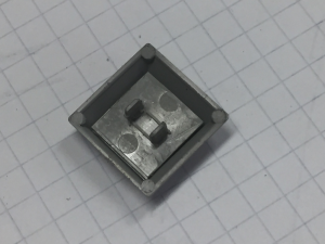

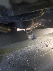

The first step was to make a jig and cutting the cap top to the desired size.
A scrap of aluminum is being roughed in to accept a ML cap.
177648-0177650-1

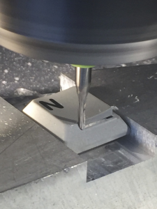

I milled a groove to further assist the holes for the cap prongs to keep the cap from moving under the milling forces.

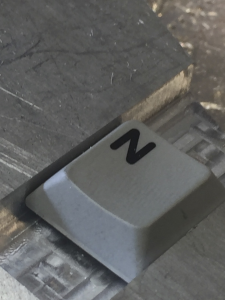

177652-2
Using a low speed, the mill cut the plastic cleanly and without burning.

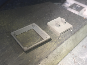

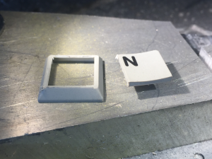

177654-3177658-4
The contour on the cap top was later sanded down flat to better conform to the other cap's underside.

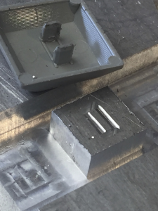

177656-5
Here it is glued up using CA adhesive. The donor cap was cut to perfectly fit the underside of the other cap. As it turned out there was a little play in the vertical direction so my next cut will be adjusted for that. Matching the two pieces closely is necessary for consistent indexing and final results.

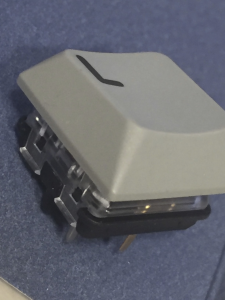

177660-6
The fit is good. The cap lays flat with the switch housing and has full range of motion.
177662-7
It should take about a minute to mount the donor cap, mill it, and remove it from the jig. Sanding the cap top flush, glueing pieces together, and misc. clean up another minute or two. I should be able to prep 55 caps for my next keyboard in less than 3 hours, which is a lot faster than casting or milling a whole set.
