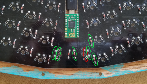

I'll preface this by saying I'm new to electronics and soldering. So I just finished building my Atreus. Everything was going well, and I noticed the Ctrl key was leaning sideways in the plate, so I decided to desolder the switch and shift it into proper position. This proved to be a bit difficult and I think i accidentally damaged my PCB a bit.
196458-0
I have a multimeter and tried to do some tests for continuity on the board and diodes. It's difficult from just the bottom view to tell what to test. I tested a lot of the switches while depressed as well as the small holes in the PCB next to them, trying to find a pattern. I found one specific area that's not continuous. In the example pic, Green circles are continuous and the Red one isn't. Anyone have an idea what's wrong without me doing further desoldering, and any suggestions for fixing it?

Sounds like one of the holes in the red circle isn't connected to the one in the green circle next to it, the bottom one looks like it's been hotter but you've drawn over the crucial part so can't be sure.  If you're lucky you can just drag a bit of solder over to bridge the gap and it will work.

Sorry about the picture, hopefully this one clears things up:
196476-0
So I used my multimeter to test the holes  with their corresponding switch pin. All of them have continuity except for the top one in the red circle. Should reconnecting them fix things up? If so, should I just solder across to connect them, or run a small bit of wire from the hole to the pin?
BTW I'm using matias quiet click switches. Thanks for the help!

No worries, it looks more like the bottom one now but the multimeter doesn't lie.
It just has to connect so if you think you can solder a piece of wire in there without soldering your tweezers to the board go for it, personally I wouldn't bother as it's so close.

Just finished soldering the hold to the corresponding switch pin. Worked perfect. Thanks!
