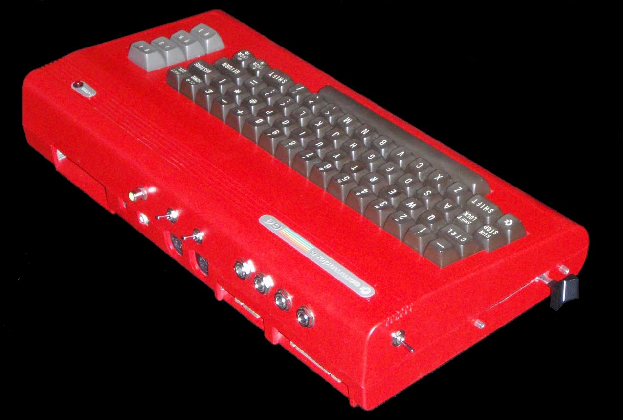

Can always get inspired with some paint and purty it up, :becky:
Showing for the color but clearly these mods start to get more extensive.
This one is a 64C, but hey, I like blue.

I went & looked at the original posts that image is from.  Some pretty impressive detail work.
Gotta watch out for mice in wooden C64s though, :rofl:
