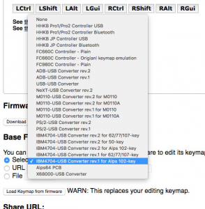

- actually, if you want to go that route... web configurator, you certainly can, saves a lot of headaches... you'll just need a flasher to get the hex file onto the micro.
--  web based configurator  --
- http://www.tmk-kbd.com/tmk_keyboard/editor/unimap/?ibm4704_usb_alps     (guessing you have the green alps SKCC variant)
- pick "IBM4704-USB Converter rev.1 for Alps 102-key" from the dropdown     (it's important you use rev.1, rev.2 will not work with your controller)
214634-0
the reason this is important is the rev.1 is a ATMega32u4, same as your controller.
the rev.2 is a ATMega32u2, not the same & won't work.
