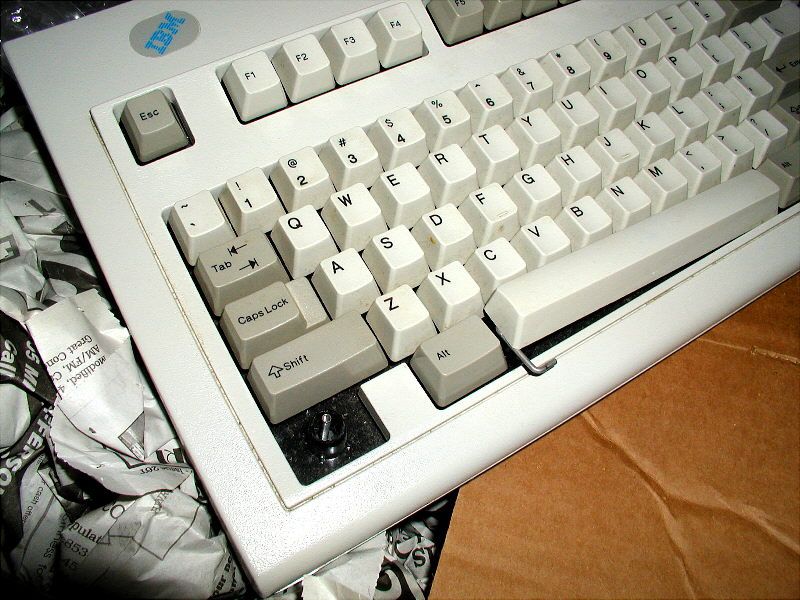

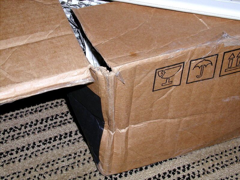

Here's what I mean about Ebay sellers not packing stuff right.  I received this keyboard in a used box with a few sheets of newspaper thrown inside, and this is how I got it.  This lady had like a 100% positive rating on Ebay after like 600 transactions.  I was the first guy to give her a negative rating, and she was really pissed.  But anyway, I managed to get it back together and it worked fine.  The date on these pictures is 6-9-2006, so 7 years ago you could buy these for $15 or $20 each on Ebay.  I remember in like 2001 or 2002 they would sell a lot of 10 boards for like $100, so the price of an IBM Model M has really gone up.  Heck, this might be an F here in this picture--I'm not sure.
I remember when I first typed on one around 1985 at Olsten Temporaries when I took a typing test.  I did a 5 minute test at 75WPM with just one error, and I loved this keyboard ever since.  I had too macho an image of myself to allow myself to work as a typist though--haha.

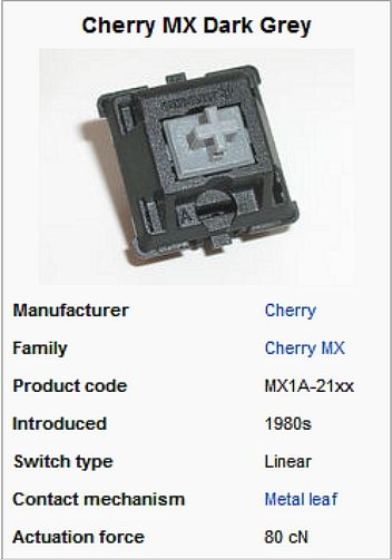

http://deskthority.net/wiki/Cherry_MX_Dark_Grey
Was going to suggest these aswell.
Thanks for all the info.  I think a keyboard that was 100% Cherry MX Dark Grey would be a great keyboard for me.  I think it would be similar to that Phillips Pact 220 Teleprinter because it had really stiff linear keys.  I wonder if anyone on the board has a keyboard like this?  I only use my computer for word processing, but I only do about 10 documents per week.  So, I don't think it would wear my hands out like some other guy said.  I'm also on the internet a lot, but there isn't much typing on the internet compared to programming or word processing.

But Dark Grey seems to have a bad reputation as many people complain about how bad it actually feels
People complain about how bad all key types feel. Is there something actually wrong with them, or are the complainers of the limp-wristed variety?

MX Black Switches (Heavy Linear).
MX Dark Grey (Heavier Liner)
MX Super Black (Insane)
