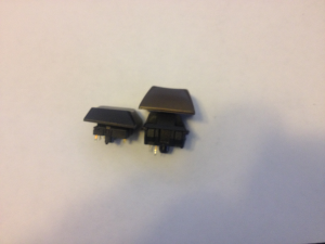

86401-0
As you can see, they are a fraction of the size of their bigger more popular brother the MX. This is the main reason I wanted to try them. The height from PCB to keycap top is a minuscule 5/16" compared to 3/4" for the MX. The on center spacing between switches is .70" verses .75" for the MX. Both of these specs are attractive features if your trying to make a compact board.

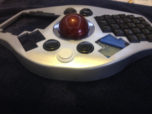

86405-1
This picture shows how much a standard Cherry switch adds to the bulk of a keyboard. I know what you're thinking. "If this joker wants to make a small keyboard, why the heck did he put a humongous trackball in it?" Let's just say I have my reasons and they will be explained in a future thread devoted to the Alumaplop's construction.

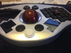

86403-2
The early pictures show that the height of the board with switches is a mere 1 3/8". Not bad considering the sides are tented 9º. Of course that doesn't include the trackball but it is removable and can be stowed separately for transport. The ML switch does require a PCB to mount it to unless you try a press fit and glue.

just something to nitpick:
those images look like they're showing extreme barrel distortion (assuming not a fisheye lens).
can you take another shot from further away and just crop the image to get the framing you want?
that should give everyone a more accurate description of the acutal size differences.

« Reply #5 on: Mon, 05 January 2015, 06:11:25 »
If you're referring to the shape of the keyboard, that is almost the actual shape of it. While the pictures are poorly focused, they are not excessively distorted. I took some shots directy overhead but they had too much shine from the flash to be presentable.  I will be taking more pictures as the project progresses however.
