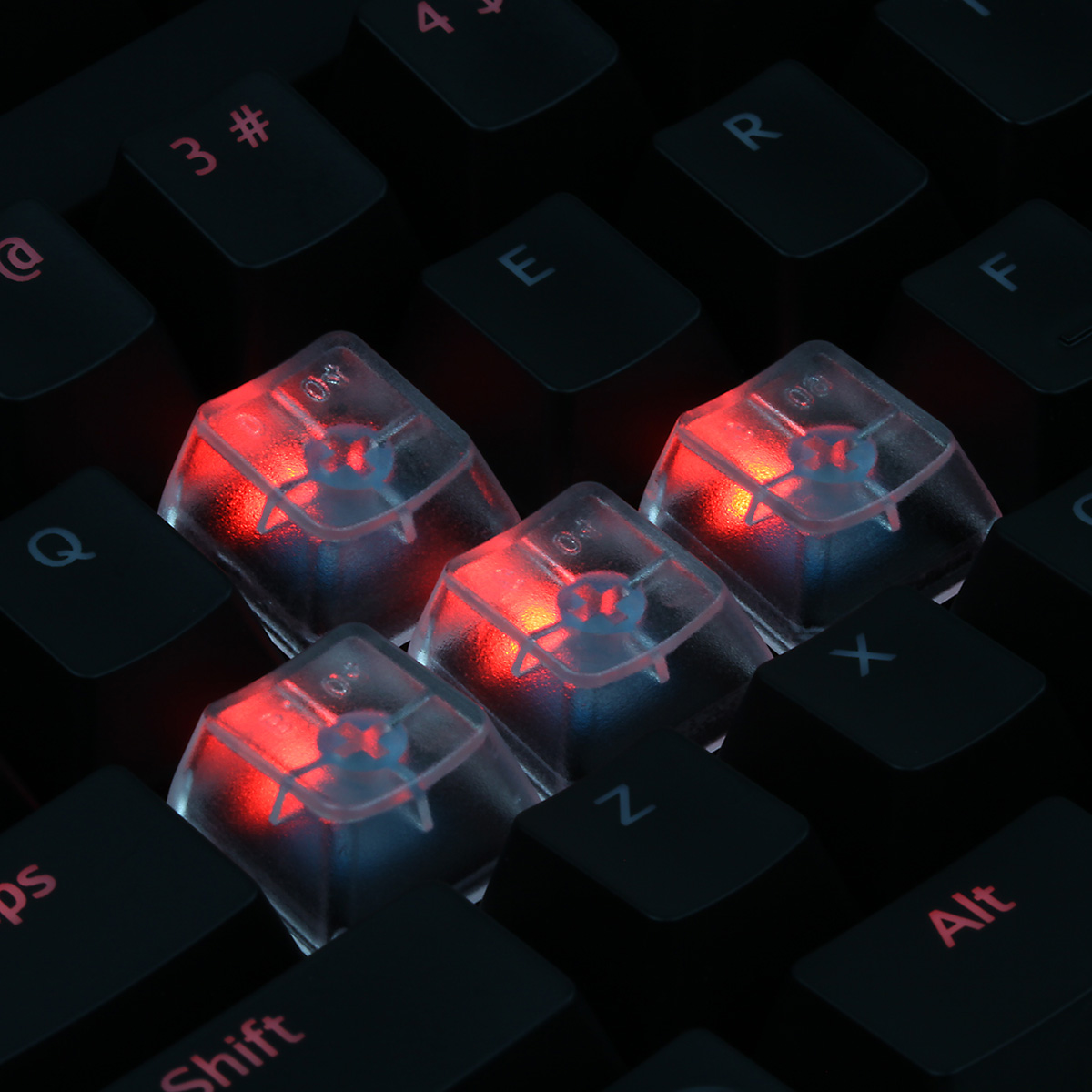

Where translucent does not turn into transparent, and the keys are given a milky glow. The lighted keys on my Leo F660cM reminded me of this, since the keys are thin PBT and the LED very strong, which makes much of the key seem to glow outside of the small window. This also showed me the major issue with this on Cherry MX compatible boards is the keycap construction itself, which is clearly shown in this photo:
http://www.maxkeyboard.com/images/detailed/1/clear-translucent-max9-red.jpg
The construction of the key leads to dark spots and kills the effect of the retro glow. I can't see a way around this with MX, so what switch do you guys think would best suit a project like this? I'm shooting for uniform glow over a semi-transparent key to give a warm glow effect that isn't as harsh as typical blacklighting. I know I would have to squeeze the layout together to remedy bleed-through, but that's a secondary concern. I like the theory behind the new Steelseries switch that seems to be a derivative of Topre, but I don't know if that would be better.

I also always loved that style of backlighting.  I think it's only going to really work with translucent switch housings, stems, caps and base. That's how it's done in the rubber dome versions anyway.  Then there's the issue of getting the light to shine through all of the hard, thick plastic in mechanical switches. I think it's only really feasible in scissor switch boards like the one you posted.  The one switch that might work well for this I think would be the Matias.

The one pictures is unlikely to be mechanical - too much variation in the keycap size.
POM keycaps with a white plate might produce something similar.
