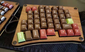

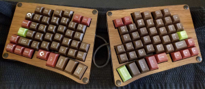

I'm very pleased with the result - the case looks fantastic and it turned out just like I envisioned.

I lucked out and got two full DSA Retro key cap sets which makes doing a custom build much simpler.  The huge selection of cap sizes and the DSA profile means I could move keys around as much as I liked without worrying about cap row profiles and cap sizes.

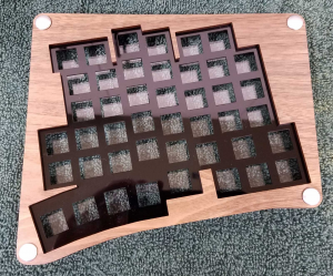

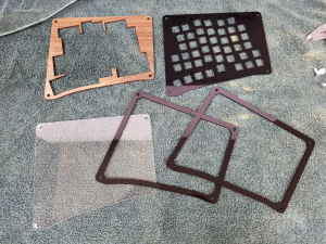

Case and Plate
The case is a five layer design.  There is a clear acrylic 3 mm base, two black acrylic 3 mm spacers, a black acrylic 1.5mm switch plate, and a walnut veneer 3.5 mm top plate all laser cut by Ponoko.  I had them make a prototype out of cardboard (for about $20) so I could test all of the spacing and general layout which worked very nicely.
138536-1138538-2138540-3
The biggest problem with using plastic is the switch plate.  The 1.5 mm switch plate is very flexible.  Super-gluing the spacers to the switch plate helps a lot but I still had one part of the plate crack after inserting a switch (not a problem in the end as the super-glued spacers kept it rigid).  And many of the switches will pull out if I try to remove the cap.  I'll probably end up gluing the switches into the plate but I wasn't sure about that so I haven't done that yet.  Using a metal switch plate might be a lot simpler (but a lot more money).
To keep the switch plate from bending while typing, I used two 3mm spacers.  The height of switches below the switch plate is ~6mm so the plastic posts on the switch rest against the bottom plate which eliminates any flexing after it's been assembled.  The switch leads are also too long so I cut every lead down below the plastic posts on the switches.  Another problem with plastic is that the sheets have a thickness tolerance of about +/- 10%.  My spacers came out to be about 5.8 mm thick and the switches were more like 6.2 below the plate.  I used an old number plate I had laying around to make the sanding jig shown below.  I little experimentation and I found if I used two spacers on each side (1 w/ the protective wrap still on it), I could reliably sand down the switch posts to 5.8 mm to match the spacer depth.  It took a little while (I did 180 switches, 3 at a time and clipped 4 leads/switch) but I think it was worth doing.

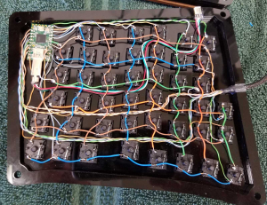

Wiring
The switches I had all have diodes in them so I used those and hand wired the matrix together.  I've found the best wire to use is cat-5 cable.  You get 8 wires with different colors from each cable, they're very cheap, and you can get 26ga, 30ga, solid and stranded wire.  I ordered a 10' cat 5 cable with 30ga stranded wire, 26ga solid wire, and a USB cable from Monoprice for less than $10 which gave me all the wire I needed.
I find soldering stranded wire to be a pain - the strands always get loose so I use solid wire whenever I can.  The row and column matrices are all down with 26ga solid wire.  The connections between the hands and to the Teensy are done with 30ga stranded wire to keep the size down.  It would be nice to have a detachable cable (I really like the ErgoDox Infinity system) but I didn't want anything that complicated so I ran 14 wires (7 twisted pairs) between the hands which worked fine.  It's definitely not as robust as a disconnectable cable but it should be fine for my use.  Wiring 22 stranded 30ga wires into a Teensy is a real test of patience...
I did one hand using the "mark and melt the insulation" technique and the other by stripping longer pieces of insulation, cutting them and sliding them back on the wire.  Melting is faster, but uglier and harder to get the gaps in the right places.  Stripping, cutting, and putting the insulation back on takes longer but looks nicer and is easier to get right the first time.
I cut a slot in both spacer layers (with a bandsaw) to accommodate the cable between the hands and hot-melt glued it in place.  The micro USB connector fits in a slot cut in one of the spacers and is also hot-melt glued.

I'm still working on firmware options (using TMK) and I have one key that is blocking any other keys in the column (diode problem?) to debug but overall everything is working great. And I have to build a second board for work and make a small stand to tent the back up a little bit.  Overall I'm very pleased with the result.  I've attached the CAD file I used to do the design in case anyone is interested (if you want the Ponoko files split into layers, let me know).

Well.. well.. I really like the layout. And the wood grain/Retro DSA set looks amazing on that keyboard.
Were you planning to devise a way to detach the two halves in the future?

I thought I would update this with my feelings after using the board for a couple of weeks.  I've done normal typing, gaming, and programming with it.  It's taking me awhile to get used to the lack of row stagger.  The upper keys are easy, but the lower row (ZXC,etc) has been more difficult to get used to.  I'm only using this board every other day (I haven't finished the second one yet for work) so I expect this will get better over time.
For regular typing, the layout is fantastic.  Having the backspace and return keys next to the space bar on each thumb is perfect and saves a ton of time.  The escape key location works really well, much easier than the upper left corner.  I've been doing a little gaming (WASD) and that works great too.  I'm considering a gaming layer in the firmware to assign something different to the hyper button but it hasn't really been necessary so far.  I spend most of my time programming (c++, python using emacs, and working on the linux command line).  I have a ton of short cuts set up using the ctrl, alt, and hyper keys and overall this works great.  I have the left hand hyper layer set as keyboard movement and fwd/back delete keys.  The right hand hyper is the various shifted keys I use a lot in programming like (){}[] +*/-#.  Having all of those keys available easily is really nice.
However, I'm finding the lack of homing bars on the DSA retro caps to be a huge problem.  My thumbs especially are moving a lot to hit alt, hyper, space, enter and since each key is only 1u wide, it's easy to get lost and hit the wrong key with my thumbs.  I'd also like it if the left hand ctrl and tab keys were 1.5u wide.  I could have made them that way, but I was focused on a symmetric layout for cheaper metal machining costs and didn't think about the fact that in plastic, I could have made that change without any cost.  I'd also consider moving the page up and down keys to the right side just because I'm so use to them being over there.
Overall I'm very pleased.  The shortcomings aren't large enough that it would be worth doing another iteration for (at least anytime soon) and I'm hopeful that when I get the second board built for work, I'll get used to the new layout that much faster.  I'm experimenting with creating homing dots on F, J, and the space bars using super glue and I'm hopeful that will help reduce my mistakes.
