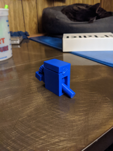

I agree that it seems like your specific-fit version might not be viable for mass consumption. I did have a related thought though: It's hard for most people (ie me) to translate manipulated real-world elements into 3d space. Have you put any thought into designing your individual key clusters with that step in mind? Or laying out a recommended method for making the prototype->final files? Do you think the end goal for most users would be a more permanent setup?
Yeah, that's actually a bit related to the alternate mounting mechanism I'm thinking about/working on. I actually tried to do almost exactly what you describe (tracing the feet, measuring the heights, etc.) when designing the static mount for myself. I found that in practice, I wasn't able to get a very good level of precision doing that. I did use the results of that as the "first pass" of the locations for the static mount, but it took a good probably 5-10 iterations of tweaking the positions after that to really dial it in.
My current project involves basically a big block that sits behind the cluster, with a rod sticking out the front that the cluster will be mounted to. The block has a few gearing thingies (I'm pretty sure that's the correct technical word for them! :D) that give it an adjustable angle in the "pitch" and "roll" axis,  and will (hopefully) have some sort of angle indicators so you can read off the 2 angles somewhat precisely. And then add in a z axis adjustment, and you've got 3 axis of adjustability. And then the mounts themselves can be positioned freely on a steel plate, held down with magnets, so you get x, y and yaw axis, for a full 6 axis of adjustability.
There's still a fair bit of work to go on it. I'm pretty happy with the adjustable pitch axis, and I'm currently working on the yaw axis. I'm still scratching my head on the best way to do the Z axis, haha :). Both rotational axis use worm gears, so they're (ideally) firmly held in the chosen angle and can't back-drive the gear, or otherwise wiggle around. (The yaw axis is still a bit wiggly, but definitely making progress in that area!).
But yeah, the long-term goal/idea would be to have someone use this mounting system temporarily, and let them adjust everything to their liking, and then take the angles and positions of the mounts and translate that into the static mount.
I'm thinking maybe some sort of grid contact paper on top of the steel plate to indicate where they are in the x/y/yaw axis.
257016-0257018-1

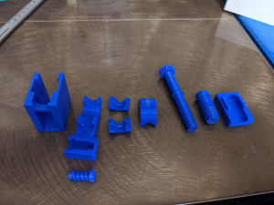

A somewhat better view of the "exploded" parts.
257020-0

I think I've mostly scrapped that idea. I actually got a reasonably working module for that... but it's just too many parts and too complicated. It was a fun project though! Definitely learned a lot about designing gears in the process.
