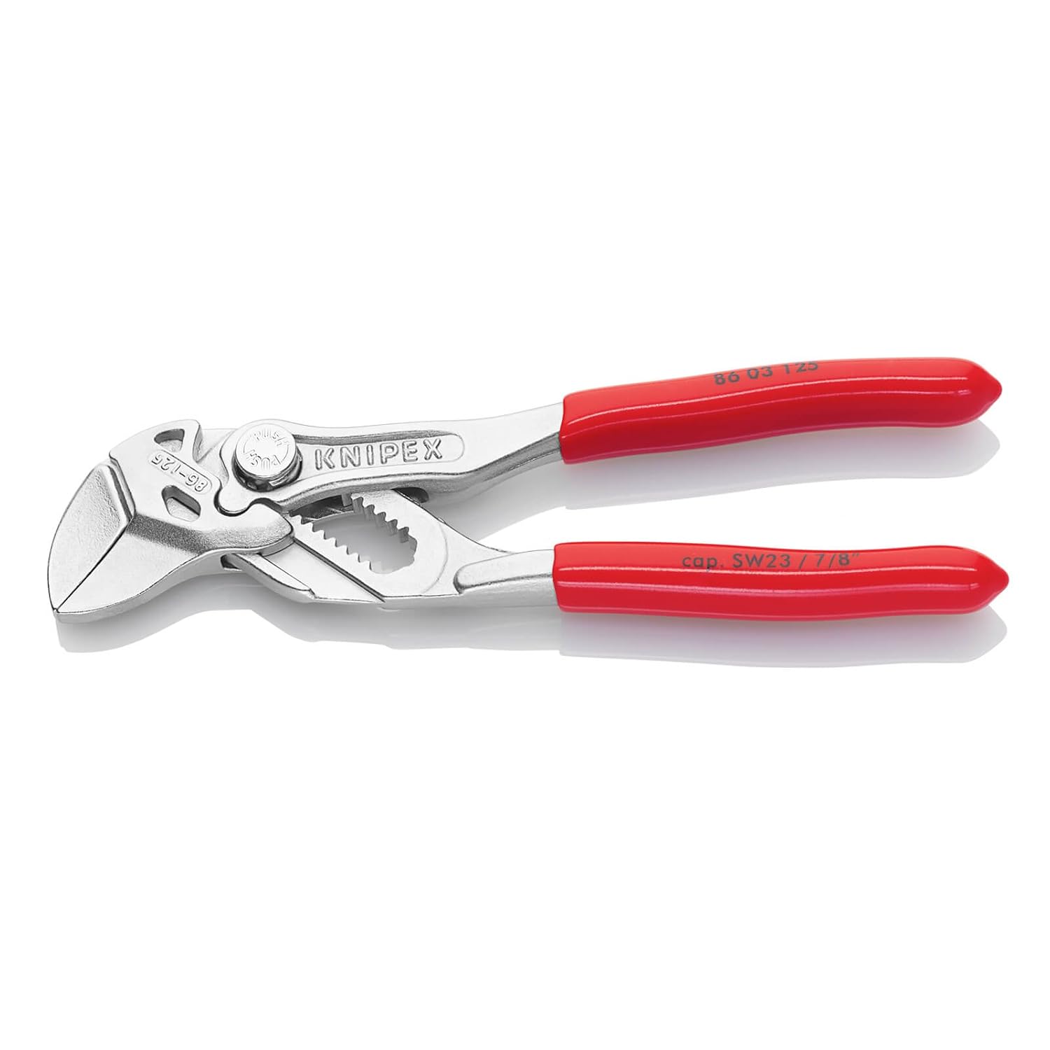

For inserting the magnets, I love these parallel jaw pliers. In some cases, there's not enough room to use those, and I used these needle-nose pliers with tiny jaws instead.
In either case, the jaws are steel, so you can attach a magnet to one side of the pliers, maneuver the jaws into place over the hole and use the force of the pliers to insert it into the hole. I prefer using the parallel jaw pliers when possible, because they're less likely to damage the parts.
