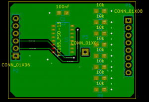

Guys, could someone take a look at this, and tell me if I'm doing it right?
(no need to tell me its ugly, I know that :P also, noob alert.)
This is my first KiCad thing ever, done with Windsor Schmidt's awesome tutorial.
Basically, a breakout board for one of the shift registers.
What it's supposed to do is:
- gather all the parallel inputs to one side
- gather all other inputs and outputs to the other, including GND and Vcc
- get 100nF cap on the VCC line to smooth out the current
- get 10K ohm pulldown resistor on each of the switch lines
The chip being used is SN54HC165 from Texas Instruments in a plastic small outline package.
128905-0

@sinusoid
The capacitor acts as a resistor with very high resistance except for the moment where it is switched on.
If you want to smooth the current, you need to put it between the vcc-line and ground. This setup would cut off the vcc a few micro seconds after the power gets on.
edit: here an article about capacitors in direct current circuits
http://farside.ph.utexas.edu/teaching/302l/lectures/node60.html

THANK YOU!
I had a lot of problems with understanding how that works!
I think I get it now: the cap will charge up when Vcc is pulled high, thereby insulating Vcc from Gnd.
Whenever voltage in Vcc drops, the cap will bleed some of its charge to compensate!
So f***ing simple... :( You just saved me several hours of Sunday.
I'll update the schema, design the PCB and etch it (if nothing breaks!).

@sinusoid
You are welcome. And your interpretation is correct. Awesome work with the design by the way. I hope to get to print it myself sometime :)
http://www.resistorguide.com/pull-up-resistor_pull-down-resistor/
This guide advices to start with smaller input resistors. About 4,7 K but that will probably be a minor problem.
I calculated the input impedance of the device to be around 6MOhm so the 10K should work.
Btw. Do you still need to understand the decoupling?  It would be some work to figure the exact behaviour out since my electronics education  was a few years ago. But I could write a small course, I assume.
Btw2. What is the type of microswitch you use?  I read about some of them an they either don't announce the number of possible operations per minute or get very low values 30-120ish. 0,5-2 operations per key and second might prove problematic wenn trying to ramp up wpm.
« Last Edit: Sun, 21 February 2016, 00:51:07 by Terex »

It may be a good idea to connect SER to either Vcc or GND to ease firmware debugging (so that you do not have random values in the lower bits of the register which could spill to the output if you cycle clock too many times).
You can replace all the resistors with one part (bussed resistor network). Though it may end up slightly more expensive (but less to solder). I attached an example schematic for using shift registers for both the driving and scanning.

I added a pin to serial-in, so I can pull it up or down for debug.
Thanks for the bussed resistor network! It's much better because it has a smaller outline than individual resistors. I have to see what packages this is available in, maybe try to match it to the SO-16 of the register... these could fit inside a single switch!

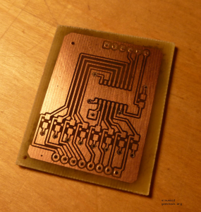

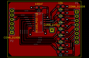

OK, I etched it today, but failed. Here's the story:
I made the schema into a dual-sided PCB. I could have made it single-layered, and just solder in pass-over wires, but meh, why make it too easy... :P
Here's how it looks like:

KiCad is totally awesome. By the end of it I could do most of the things with keyboard shortcuts. I spent around 1.5 hours trying to shrinkify the design, so it wouldn't look all that sloppy. Biggest issue I had was that it sometimes wouldn't register DEL clicks on routes (was using latest stable version), and I had to hunt-peck them with the cursor to get them selected.
Predicting the routes is fun, but HAAARD, and time consuming, especially to get the spacing and angles right. Wish it had some sort of follow function, and better re-routing tools. Or maybe it does, but I don't know about them yet.
Done on a .25 mil grid.
I spend the rest of the day toner-transferring it, and that's how it came out:
129063-2
I'm very happy with the result. I washed the PCB with a detergent, sanded it with 400 grade paper, washed it with water, and removed any residue with isopropanol.

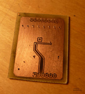

Unfortunately, I was sloppy, and didn't match the halves properly:
129065-3
As you can see by the drill holes, they have around a millimeter offset.
I drilled all of them anyway - free exp grinding, wohoo!  ;D I can't get a nice surface of the drill holes on the other side of the PCB, I'll have to do something about it - place a piece of wood underneath or sand it post drilling.
Next time I'll transfer one side, drill the holes, and match the other to the drill holes.
(also use smaller drill for vias, but I didn't really care here, knowing it was spoiled anyway).

The Layout looks nice and clean.
Did you consider rounded edges? Like on Page 15 of the datasheet: http://www.ti.com/lit/ds/symlink/sn54hc165.pdf
I don't know how high the clock frequency of your chip is, perhaps you could run into problems with the sharp ones.
You can drop the pin and leave at GND or Vcc all the time. (That is if you do not want for debugging to be able to define what values should be in those low bits.) It better even from the power consumption point of view. It is negligibly lower when input pit is not floating.

Offline sinusoid
  • Posts: 160
  • fd > ESC
@test321
Yep. I need to finish a project at work that swallows up most of my time.
There aren't many updates photo-wise, but I still managed to make a few things in the mean time.
I etched and soldered a PCB with a shift reg on it, schematic is in the PCB thread. Will post pics later.
Also, it turned out that I can't (rly?) make Arduino Mega act as a HID using its integrated USB port, I need a shield for that. Ended up buying an 32u4 based arduino that can act as a HID.
Later I realized I could just communicate keypresses from the Mega to a Python script via pyserial and generate stuff from there, but that would have been a whole new level of fugly.
Right now I have the ardu running as a serial keyboard without issues, this was kind of a dumb job, as the Arduino software has libraries and sketches for that, so it essentially ran OOTB. I'll have to write something to handle the shift registers, wire up the keyboard, map keys to symbols, and it should be ready. But that will happen after I'm done with current work, which may take some 3 weeks more.

@test321
im glad to hear you're still working on this project, but how long will it take to move it from prototype phase (once its completed) + crowdfunding + searching for manufacturer +  final shipping time? like at least a year?
