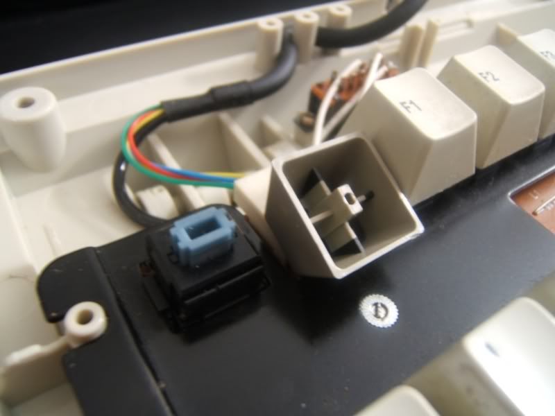

As stated in the "new members" subforum, i "saved" some old keyboards from being thrown away or dust-drowning (http://geekhack.org/index.php?topic=48688.0).
One of them (pic below) is a Chicony kb-5161 with blue switches - my question is, are these monterey or blue alps? And what's the difference? If already debated, just point me to one big informative thread :) Thank you (btw the keyboard is awesome - that's what i use at home, and i grow to like it more and more every day - the Unitek K-160 one i use at work)

Those are not montereys, might be blues.

From the picture, it does not appear to be a "Monterey" switch.
I believe it may be a blue Alps.

I have a Chicony KB-5181 with Monterey's and those ain't it.

I'll bet those are blue Alps.

It doesn't write Alps on it. You can't see below, but this switch is mounted with the writing upside down. If i look from top to bottom, there is a right circle containing a B, and at the left there is a C letter.

Blue Alps — they uniquely have that deep blue-grey slider colour. The "ALPS" logo wasn't added until the next generation of switch.
Fantastic switch — sharply tactile with a soft spring. I don't have a clicky SMK (e.g. Monterey) for comparison though.

SMK switches are a completely different shape:
http://deskthority.net/wiki/SMK_Alps_mount_switch ("Monterey")
http://deskthority.net/wiki/SMK_second_generation
These diagrams will help, though some of them need some tweaking:
http://deskthority.net/wiki/Alps_mount_recognition
(I left off "B3G-S" from the Omron diagram, before realising that it was the series name staring us all in the face! I mistook it for being mould numbering!)

Honestly, that could either be a genuine Blue ALPS switch or a clone; the "Type 3" clone looks pretty much identical to the original Blue since, as was already pointed out, the ALPS logo is not on either.
Sometimes, the only way to know is to disassemble the switch and see the internals, unless there's some other marker I'm missing.
The darker blue color does seem to indicate a genuine ALPS switch, though.

Type III is a vivid blue colour. Blue Alps CM is a deep blue-grey colour.
http://deskthority.net/wiki/Simplified_Alps_Type_III_switch
Type III is also extremely rare — it looks like some sort of short-lived custom build for Focus.
In the case of Sandy's (are there any other examples?) there's no mould numbering: the circles on the top are empty, while Laser pointed out that his have numbering in them. This is not a guarantee though, as we know so little about them; what Sandy did find is that, because it's a complete copy of the Alps upper shell, a special shim is required to support the contact plates. There's some suggestion that alps.tw has some other hybrid of this kind that does have the numbering, but his upper shell contains the proper grooves inside to support the contact plates.

Probably ALPS CM then, but there's enough uncertainty that I'd take one apart just to be 100% sure.  Then again, as long as the typing experience is good and the board is well-liked, it really doesn't matter in the end :-).

Yes, it isn't a vivid blue, so probably, almost certainly a blue cm. Sandy also seems to says so: http://sandy55.fc2web.com/keyboard/alps.html#Chicony
EDIT: Well, that's bloody it! Apart from the Asian letters, it's the precise same shape and format. I don't know why i can't reach this page directly from main Sandy's keyboard page: http://sandy55.fc2web.com/keyboard/chicony_kb-5161cn.html
