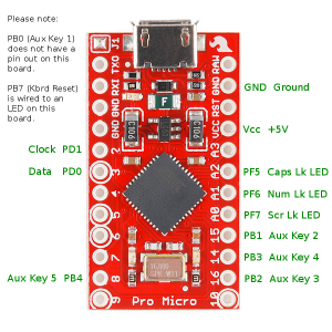

I just built a Soarer's ps2-usb converter using an Arduino Pro Micro Clone. It's working fine (after switching the clock and data lines around because I wired them the wrong way around at first  ;) )
So Clock is to PD1 and Data is to PD0.
I wanted to try out hasu's  converter as well, but I can't get it to work. I tried editing config.h but it  still doesn't work. It looked to build ok using "make KEYMAP=spacefn" and I uploaded it to the Pro Micro ok. Can anyone give me any advice  on what's wrong? My config.h is attached. It's late here so I probably made a mistake when changing the pins.
I tried to change which pins it used to 0 and 1 but still no dice.
* config.h (5.09 kB - downloaded 157 times.)
Also, is it true that nkro still doesn't work with hasu's using LUFA? I actually have no idea what bootloader my board is using... It's a cheap clone from China.
54097-1
Thanks!!

With PD0 and PD1 USART(default) version doesn't work. You should use BUSYWAIT or INT(errupt) version.
Change build setting in Makefile.
NKRO is supported with LUFA now.

Just curious for my future converters, with which pins is USART supported? The default is PD5 and PD2 from your converter thread, but PD5 isn't broken out to a pin on the Pro Micro.
Could I use PD3 and PD2 with USART?
« Last Edit: Wed, 12 February 2014, 18:10:52 by clickclack123 »
Offline hasu
  • Posts: 3502
  • Location: Tokyo, Japan
  • @tmk
Re: Make Hasu's Converter with Same HW as Soarers?
« Reply #9 on: Wed, 12 February 2014, 19:28:46 »
Ah, Pro Micro has no pin for PD5? Shame, but I can understand their decision. XCK function is less used.
You can find the answer in datasheet. Download and look over it. It never waste your time, or rather save it. I'm serious, not joking.
http://www.atmel.com/images/7766s.pdf
TL;DR: No. PD3 deosn't work for this purpose. You need PD5 for XCK(clock).
