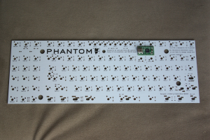

This is a project I've been working on for the last six months.  At the time I had just completed my QFR modification project and I decided I wanted to build a keyboard by myself.  After looking for various parts for months and trying to convince myself that I could live with this or that compromise I was forced to face the terrible truth – my endgame keyboard is never going to be made by anyone other than myself.  The equally terrible counterpart to that truth is the realization that I did not have the technical skills to get there.
Well, every journey has to start somewhere.  I'm a pretty bright guy (and modest too) so I decided I would develop the skills I lacked.  I would take a pragmatic approach and make one or more *middle-game* keyboards, advancing myself each time.  The Metal Dragon is the first milestone of my journey.
It is a Phantom keyboard with an anodized aluminum case and a stainless steel plate top.  It was designed in eMachineShop's software and cut/milled by eMachineShop as well.  Anodizing was done by a Anotone, a local Chicago shop.

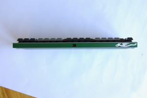

81418-1
I knew I wanted a keyboard where the plate was the top cover as well.  I really like the aesthetic and the simplicity that comes from this design characteristic and it makes cleaning easier too.  I considered using aluminum 6061 for the plate but since the PCB would be fixed to the case via the plate on top instead of via standoffs on the bottom I was concerned about rigidity.  I decided to go with stainless steel.  The downside to using stainless steel is that it costs more to cut and it can't be anodized.

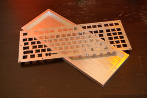

81416-2
The main case is aluminum 6061.  It's very simple open rectangle with two standoffs in the middle to support the PCB and four standoffs near the top edge to fasten a USB breakout board.  There are a threaded holes around the top edge to fasten to the plate and two threaded holes in the bottom for possible feet.  The idea to use a breakout board so I could use a detachable cable with the Teensy-based Phantom PCB was entirely inspired by Photeq's TEK-80.  The case is anodized with a dark green.

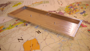

81420-3
I checked the measurements multiple times, but there were still dimensional errors at the end.  The breakout board standoffs were too tall and there was not enough vertical clearance with a fully soldered PCB.  I thought I would have to just go with an internal cable directly from the Teensy but then realized that I could turn the breakout board upside down and fasten at a slight angle.  The other problem is the opening for the USB port is small – most of my USB cables have a housing that is too big to fit.  Luckily, it turns out the USB cables that come with Coolermaster's QFRs have minimally sized housings and fit perfectly, which makes sense if you look at the bottom of QFR and see how little room they have to work with themselves.
The last problem I ran into was one I had not expected at all.  All of the stabilizers on this board are Cherry plate mount except for the spacebar, which uses Costar stabilizers.  It turns out the wire for Cherry plate mount stabilizers sticks out past the edge of the Phantom PCB so I could not fit the PCB assembly into the case comfortably.  Thankfully the design of the plate allows for both Cherry and Costar stabilizers so I had a plan B.

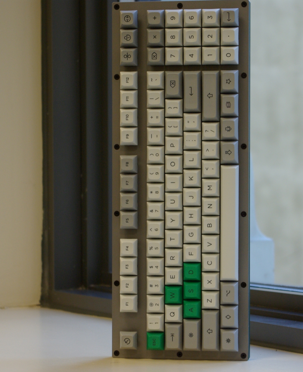

mkawa hooked me up and I was able to send the top plate to Tammi at Rainbow Paint and Blasting for a Cerakote finish.  I really like how it turned out aesthetically.  Also, it's thin enough that I do not think I would've altered the design dimensionally to account for it if I had known during the design phase that I was going to have it painted.  Unfortunately, the finish does seem to scratch easily so I will probably plan for a powder coating finish next time and design with dimensional tolerances in mind.
I also swapped out the DSA Dolch key caps with DSA Granite key caps for accurate legends as well as a splash of green.

I love it! Dark green is one of my fav. colours, and it's uncommon to see a KB in that colour. I'm glad you picked one with good taste.
The layout itself is pretty good too. What are the 2 `! keys in the upper corner for? I was thinking HHKB layout. If you I wonder if you can get a 1.5x backspace or delete and a 1x \| key.

Very nice design. I really like the finishing you've done with the case and keyset. What's the total height of the case?
You are right - HHKB layout.  Unfortunately GMK Dolch didn't come with a 1x \| so I will likely be putting Granite on there with some of the green keys to kinda sorta match.  If Nuclear Green ever gets done in DSA/DCS/Cherry I would use that.
15mm from the bottom of the case to the top of the plate.
With regard to the finishing - I'm happy with how this one turned out, but I recently had a small numpad case made that was powder coated and I'm equally pleased with that one.  I think it's hard to go wrong with either one but I particularly like powder coating's ability to color steel so I may go with that option moving forward.

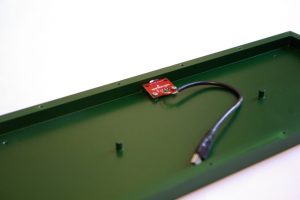

Can you explain a little more about the breakout board? I've not seen too many on custom boards and your has Sparkfun silkscreened on it. Does Sparkfun sell that little USB connector? Or the little PCB?
Ah, no but I wish I did.  The price for having 2 milled is only like $25 more total than a single one so I'd almost be halving my costs.  There was very little reason to get just one but this was my first time designing something so I was almost certain I would just be wasting $25 on two unusable cases.  Going forward I'm definitely trying to find partners in crime to split costs, the problem being differences in aesthetic taste.
It's been so long I don't even remember my inspiration for the 5x3 numpad but I think it is an idea that stems naturally if you're looking at a Phantom PCB and looking all those open switch slots on the right.  Certainly the HHKB that I had at the time convinced me that dedicated navigation keys are not necessary for a usable keyboard.  After deciding I wanted a 5x3 numpad on a Phantom I tried to find an appropriate case but all I could find was talk about acrylic cases made years before I joined Geekhack.
The USB breakout board is this one from Sparkfun.  It let's you wire something to a mini-USB socket.  Usually you're not using it to extend an existing USB socket so I guess this is a pretty novel use.  I'm not sure who's idea it was originally but I got the idea from Photeq's TEK-80 thread.  The mini-USB-to-open-wires cable is something I made myself by cutting up a normal mini-USB cable.  I actually had already done this before while building an Ergodox (the Massdrop kit comes with 2 mini-USB cables for this purpose).

Congratulations, very nice keyboard! :-) I like the layout choice to go with a numpad instead of the cursor keys and such.
You may want to be careful with the cable and USB breakout board. The connector looks to be surface mount and any stress on the cable can pry the connector from the board. A couple of them broke on me that way. If it's an issue, squishing some foam in the case gap is one way to help support it.
Anyway great job! What do you have in mind for your next keyboard?
Thank you!  Yes if I made more of these I would definitely correct the errors.  Probably would have it so that the USB breakout would be mounted upside down but not at the slight angle.  I would have to raise the overall height of the case by a couple of mm though.
