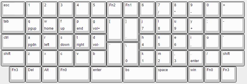

More pics would have been great but that is an interesting board you've got.  Please can you share your keymap?  There are a lot of larger keys I'm intrigued by :)
Re: Introducing the Pokerdox
« Reply #2 on: Tue, 09 June 2015, 06:03:44 »
I came in here expecting to see a poker cut in half. :P
Nice board though, also curious of your layout?

Thanks! My layout is basically the same as what I use on my ergodox, which is probably quite different from what most people use.
103148-0
This doesn't show everything but should give a good idea of the two main layers. There's also a qwerty layer with a space bar in a better position for gaming, and an experimental layer that has f1-f12 and some mouse controls. I'll add the actual code from the firmware below.
I like having access to all the same keys you have on a normal 60% without putting punctuation keys in the bottom row or the function layer. Hence the '`' (or ~) and '\' keys being in the center columns.
