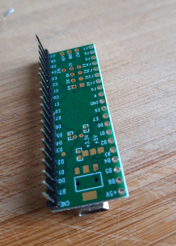

I bought a teensy++ 2.0 board (https://www.pjrc.com/store/teensypp.html) as I needed 25 inputs.
The board is compatible with Arduino developpement kit, it's recognized and I succesfully loaded simple programs in it.

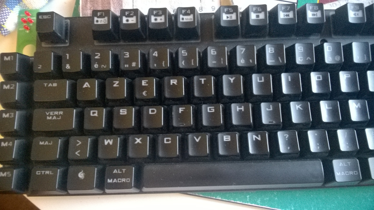

Sorry, I realize that I forgot to mention other "details"  :-[
- this is indeed a full size keyboard plus a column of 5 Macro keys (I'm planning to get rid of them in the end)
- this is a french layout !
I cannot find a way to map - for exemple - "GREATER SIGN" an "LOWER SIGN" in the same key.
Is there a workaround ? Google, for now, is telling me "NOPE".

There is no such thing as a French keyboard nor any other layout, keyboards send keycodes which your operating system converts to letters and symbols according to whatever language you've set it to.  What you need to do is pretend you have an ISO-UK keyboard so the greater/lower than is called something like 'non US backslash' and the key next to enter is 'non US hashmark'.  All the letters that don't match QWERTY boards will be 'wrong' too, but they will work.
If you do want two random characters on the same key you can do pretty much anything using layers and modifiers but on a fullsize you probably don't need to.  Get it working first :thumb:

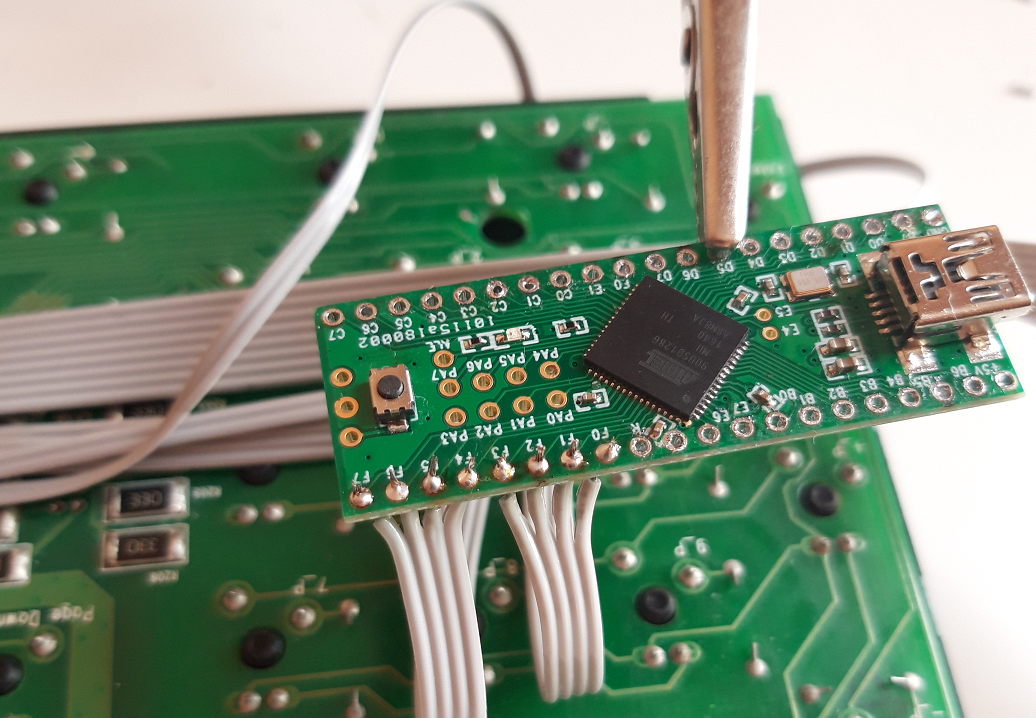

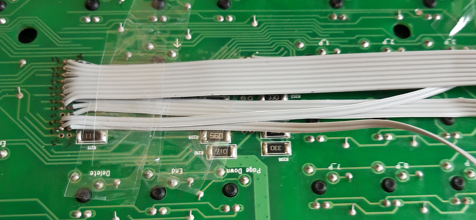

Took my time to do the wiring (actually the longer part was to remove the previously soldered pins in the teensy board).
Here some photos (i'm quitte happy with the result - clean cable management and not so bad soldering) :

Here is the mapping between the pins on the keyboard and the teensy controler:
I found it logical that nothing happens when I press keys on my newly porgrammed keyboard, I didn't specify which I/O to "listen" to, but how to do that ? Once again I need some help.

Aqua Key Test says for every key :
Dark grey means the key is still pressed, and yellow show the last pressed key... all that with one stroke  :eek:
  • Posts: 4772
Re: Looking for direction on an uncommon case (probably)
« Reply #22 on: Sat, 26 October 2019, 11:33:10 »
That is strange, those keys aren't connected according to your config file so even if it's wrong they shouldn't activate at the same time.
Is there any chance you crushed your wires on the switch pins causing a short when you closed the case?  That would cause certain keys to register but I can't think of any way of producing a press and release, let alone two.
Oh, one thing I thought I mentioned but just looked back and I didn't - pin D6 is dodgy as it has an LED attached to it.  Column 7 doesn't feature in your problem keys either but probably best to move it.  And then it hit me while looking where you could move it without messing up your tidy wiring - your 'Teensy' may be a fake.  It's very similar and even worked with the official loader when most don't but it's missing the hole next to E4 and E5 and one of the traces that go round the button is missing, among other minor differences, compare the pics 3/4 down this page.  The worst thing about fakes is you never know quite what you get so hopefully I'm wrong and the above fixes it :(
Offline socratisator
  • Posts: 41
« Reply #23 on: Sat, 26 October 2019, 12:36:01 »
I did not put back the plastic case, so crushing the wires is very unlikely.
Is rewiring D6 and D7 to F0 and F1 respectively, acceptable ?
When you say "Column 7 doesn't feature in your problem keys either but probably best to move it" you mean D5 (the 7th element in columns table) ?
I concede, I bougth my teensy2++ on aliexpress, so it's surely unofficial, but feed back were good (here is the link https://www.aliexpress.com/item/32975352827.html?spm=a2g0s.9042311.0.0.3a3a4c4d6wChOQ).
Another thing very, very odd : when I press a key from the macro column on the left side (keys M1 to M5 here https://www.techpowerup.com/img/13-10-15/CM_Storm_Trigger-Z_01.jpg), I get the same behaviour but I didn't even bother finding the matrix for thoses keys even less doing the wiring, I wanted to get rid of them !!!
Is a shortcut can really do that or the fake chip more realistic ? In case of a shortcut, if I post detailled pictures of the board, can someone points the source of the problem ?
  • Posts: 4772
« Reply #24 on: Sun, 27 October 2019, 05:37:49 »
I meant the column D6 is connected to.  Either I can't count (likely, I'm stupid at the moment due to illness) or you count like a human not a keyboard controller *checks file* phew, it's not me.  As you may have noticed while mapping keys the first column is column 0 so D6 is column 7.
F0 and F1 should be fine as replacements but who knows.  Get the multimeter out and see where the LED is connected - one end will go to 5v or ground and the other to a named pin, and one of those connections will be via a resistor.   The named pin is the one to avoid.
I still can't think of anything that could cause unconnected switches to activate though, especially not the unmapped (macro) keys.  Have you tried shorting a row to a column directly on the teensy?
I don't think pictures will help as usually you're looking for dead keys not randomly activating ones.  I suppose multiple shorts could do it but your soldering looks tidy so not likely.
  • Posts: 41
« Reply #25 on: Mon, 28 October 2019, 15:39:40 »
Ok, Im the stupid one and counting like human (reassuring in one sense).
I can confirm that D6 is the I/O linked to the LED so I'll do as stated in my last post.

I soldered directly a key into pins E0, E1 (instead of F0, F1, a mistake in my last post). Then edited the python file like this :
    #rows=[F0, F1, F2, F3, F4, F5, F6, F7],
    rows=[F0, F1, F2, F3, F4, F5, F6, E0],
    #cols=[B7, D0, D1, D2, D3, D4, D5, D6, D7, C0, C1, C2, C3, C4, C5, C6, C7],
    cols=[B7, D0, D1, D2, D3, D4, D5, D6, D7, C0, C1, C2, C3, C4, C5, C6, E1],
I substitued F7 for E0 and C7 for E1, so that my extra key "coordonate" is E0 - E1 in the keyboard matrix
Then changed the entry responsible for "F1" in the list keyboard_definition to map a "A" associated with my extra key:
  #((4, 4), (1, 3), 'HID_KEYBOARD_SC_F1'),
  ((4, 4), (7, 16), 'HID_KEYBOARD_SC_A'),
Once opened in EasyAVR, strangely, the new key shows "O" (I changed the letter to 'HID_KEYBOARD_SC_Z', but it still display 'O' - edited that manually)
Builded then loaded the new firware.
The new key, connected directly to the controller, open the infamous Office windows, AquaKeyTest show the same ALT + Win + Shift + CTRL press simultaneously T_T
Either I've overlooked something obvious, or this is a broken chineese copy of a teensy2++
Got a pro-micro controller bought from a french retailler, i'll try the same thing with it, when I had found some motivation...
  • Posts: 4772
« Reply #27 on: Sat, 02 November 2019, 10:13:57 »
It showed "O" because you already had an O key in matrix position 7, 16 :)
To confirm it's a dodgy teensy you would need to disconnect all the wires to isolate it completely from the board.
Edit: I'm going to builld/flash your config on a spare Teensy to check it works - if not you can save yourself the hassle
Edit 2: Built the config as above, the LED lights up brightly but shorting the pins for F1 and F2 they both worked like they should.  Either it's your wiring or the Teensy :(
« Last Edit: Sat, 02 November 2019, 10:25:35 by suicidal_orange »

I stare closely at the chip and nothing looks like a shortcut to me. Also loaded your hex file and the behaviour is the same  :(
I'm using the latest version of easyAVR.
Maybe I can submit this enygma in the Mettaliqaz thread dedicated to EasyAVR, as you suggested earlier. I'm so jaded right now...
  • Posts: 4772
« Reply #31 on: Mon, 04 November 2019, 13:07:06 »
I'm tempted to send you my Teensy but then I wouldn't have one to help the next person so it's not a good idea.
I suppose you could get/borrow a programmer to return your not-teensy to the standard Atmel bootloader then in theory it would work.  Don't suppose you have a Raspberry Pi?
You could post in the EasyAVR thread and someone may know whether the memory that's supposed to store keyprosses could be filled with dodgy bootloader (the name Teensy comes from their impressively small bootloader which fakes don't have) but it might be better in a separate thread so experts on the chip rather than EasyAVR look at it.  Making Stuff Together! is where such people look...

I've got a Pro micro with the exact same chip that I bought from a french retailer. what do you have in mind with a Raspberry Pi ?
I'll start a separate thread on this peculiar problem.

I tried the setting "Teensy =False" with the same result. I don't see any reason for the EasyAVR code to fail as miserably as that. The code has been used by thousands of people by now. The only 2 "explainations" I can think of are :
- faulty teensy++ 2.0
- "custom" teensy++ 2.0 that mess up with the EasyAVR code
I'm planing to investigate point 1 by loading code and check if it behaves as an official teensy using only the setup I've got : that means only push button.
At least the basic "blink" program works - and it has allowed me to confirm that PIN 6 is the LED - but I'll need to lean a bit of AVR programing.
For point 2, I was wondering if I can use the debugger of the Arduino GUI with the code of EasyAVR to search for the root cause of this crazy behaviour.

I kept only pins E0 and E1 on which is connected the lone key. Loaded the code and pressed : ALT + WIN + SHIFT + CTRL
T_T
I also messed up with the Arduino exemple "KeyboardMessage", set buttonPin to 8 (equivalent to E0 as per the documentation) in order to test if once shorted, the message "You pressed the button X times." was displayed correctly.
The thing is, message was written randomly without even doing anything which means that pin 8/E0 changed state from HIGH to LOW on its own...
  • Posts: 4772

I went several posts back : as you stated, I unsoldered the controler and plugged the 'A' key directly to the teensy, in pins F7 and F4, as shown in the pictures.
Edited the firmware :
Code: [Select]
matrix_hardware, matrix_strobe, matrix_sense = make_matrix_config(
    strobe_cols=strobe_cols,
    strobe_low=strobe_low,
    rows=[F0, F1, F2, F3, F4, F5, F6, C7],
    cols=[B7, D0, D1, D2, D3, D4, D5, D6, D7, C0, C1, C2, C3, C4, C5, C6, F7],
    device=firmware.device
Pins (F4/F7) means (4,16) in the matrix.
Code: [Select]
((4, 4), (4, 16), 'HID_KEYBOARD_SC_A'),
Build, load, as usual "ALT + WIN + SHIFT + CTRL" pops up in AquaKeyTest.
At this point, I can consider my teensy broken. I'll try next with my Pro Micro but I'm near the braking point...and my old keyboard breaking point (in two) too.
