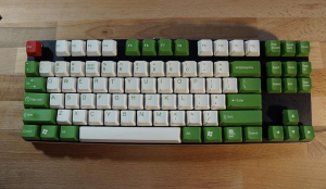

GMMk TKL
244675-0
I ordered a bare model as a switch tester and honestly, it was surprising how nice it was.  The surface anodizing is pretty tough and well done, it’s pretty stiff as well.
I'm not a fan of low profile cases but I do like how slim the body is, note that it has north facing switches which is good for your eyes as the LEDs won't blind you but bad if you like Cherry profile caps. I immediately tossed the stabs and got some Cherry/GMK stabs which I did a full workup on them lubing, clipping and taping/bandaging. Between that and the switches this thing is nice and quiet with a good but quiet thock. It may be inexpensive but seems to be pretty well designed (sort of).

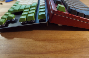

The riser feet don’t really give it much elevation, this may not be a big deal for some but I like a LOT of rise. It’s almost comical how low this is compared to the Almost-a-Filco with its custom feet. I measured the difference and these feet only give you a little over 1/4in (10mm or 5/16in) of rise and you can barely notice it visually, the only reason I can tell when using it is the board is that I can't really use it at all when flat. The lifts really should be at least double what they are, in fact the whole thing could stand to be up a bit more. I’ll be making a 3d printer extensions for the feet to give it at least another 1/4in.
With risers  compared to the Almost-a-Filco

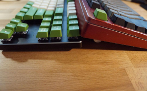

244677-1
Laying flat it almost slides under it, it would if I removed the switches.

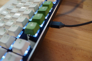

Another thing, and this is a major issue, the cable connector.
No, not because it’s Micro B, I would have the same problem with Type-C, my problem is that the cable hangs out there completely unsuported in any way just begging to be destroyed. On many boards there are channels to run the cable through, this destresses the connector, on this, not only is there nothing de-stressing the connector, GMMK includes a 90 degree adapter which is only going to make things worse by adding more leverage (don’t use it!). This needs to be addressed, it’s only a matter of time before you trash this port if you use this daily, be smart, get a magnetic USB connector, it will save you some headaches later.
Here's how the cable sticks out.

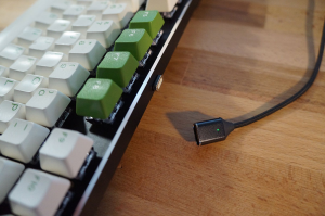

Magnetic cable

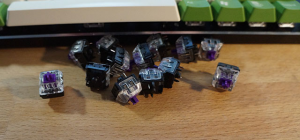

Kailh Pro Purples
244685-5
Switches like these are why people like Chryros says tactile Cherry MX is pretty much all linear. While slightly more tactile than a Brown, I’d be hard pressed to say they were more tactile than a Cherry Clear.
Of all the switches I’ve used, I have never seen a switch so absolutely DESPERATE for lube. Between this and the stiffer springs I caught myself thinking they were binding more than once. I’ve used rubber domes that were better. These were only meant to be a temporary switch until my Box Jades arrived (on a hand paddled raft from China, really slow) but there was almost no way I could use these as they came out of the box they were so bad.
I'm used to 40 gram switches, but I've used 60g Gateron Blues without issue, when I tried going back to a Model M my fingers would hurt by days end but those were 70 or 80g and it took hours to happen. These, I'm not kidding, my fingers hurt within minutes due to the binding. They didn't bind hard or completely just enough to feel like you had a very stiff spring in it (100g?) with lots of scratchy friction, and it happened very, very easily and often. Horrible, horrible switch.
With lube it became a Jekyl and Hyde situation with them becoming a pretty nice switch.
Tactility improved with the smoothness (a less jarring Cherry Clear), the stiffness also decreased and it eliminated the binding. If you like browns or Clears and you don’t mind lubing the switches these are actually pretty darn nice, just keep in mind they’re still a tad stiffer than browns. Novelkeys says these are 50g at activation but they feel like dead ringers to my 60g (at activation) Gaterons, maybe after lube they're 50, but not out of the box, no way.
So are they good? If you're on a budget and building a board and you have time and lube they aren't a bad deal. At the same time though if you're buying a board with these soldered in I'd avoid it like the plague.

Yeah, the GMMK doesn't have much of an elevation to it.
But it's fine for testing switches. I find BOX Browns and OEM profile to be surprisingly good for typing, even if those aren't on everyone's top 10 list.
Thing is, I actually found Kailh Pro Purples to feel noticeably better on a TeamWolf Zhuque than the GMMK. Maybe it had something to do with the Cherry-profile keycaps not doing well on the latter. The Pro Purples do really well on the Zhuque + Varmilo keycaps, for whatever reason.
The thing about the Pro Purples is that they are widely misunderstood. They seem to be a much lighter version of Halo Trues, which is a weird kind of tactility. It's very top-loaded, right at the top, and then it becomes linear. The heavy spring on the Trues was supposed to reduce bottom-out, but it isn't present here on the Purples.
People seem to use the Pro Purples as 'better Browns.' They are lubed more than MX Browns, and slightly smoother. They are a little more tactile as well, but I wouldn't compare them to Clears. Maybe BOX Browns.
Anyway, I agree that they are scratchy and really need lube. I'm sorry yours were binding and stuff. I've found that QC varies heavily between batches! I have ones that are decent and that I like, and others that I filed away somewhere because they felt weak and watery. The decent ones are pretty snappy, don't bind, and I achieved my personal typing record with them. So they have potential.

Thanks for the writeup. I've been thinking of getting one of these as a mess-around board to try switches, but I've got too many TKLs already, and already have a hotswap board on the way. I'd totally managed to not notice that they are low profile until your review though.
Magnetic cable
I know it's certainly not great, but isn't this how the majority of the small-run, boutique keyboards handle their USB connections? From what I've seen it's typically a USB connector coming right out the back of the case.
(All my regular boards route underneath and incorporate some kind of strain relief though.)
You're welcome.
Yes, many higher end boards use similar but they also tend to use a more durable Mini-B or Type-C cable, not a Micro-B.
It's a really good board for the money, it's disappointing in the fact that those few things would make it great.

Kailh Pro Purples
You know what - you were right. I just did a lot of typing on stock Pro Purples.
The level of tactility is very similar to MX Clears. Not to say that the type of tactility is exactly the same, but I would say the tactile force is very comparable.
Pro Purples have been called 'scratchy Zealios (V1)' in the past, and seeing as Zealios were modeled after Ergo Clears, that again points to a Clear-level of tactility.
I am fine with the Pro Purples' level of tactility, but as you say they need a ton of lubing. I'm not sure about the spring swap. I might have some results in a few weeks to tell you.
